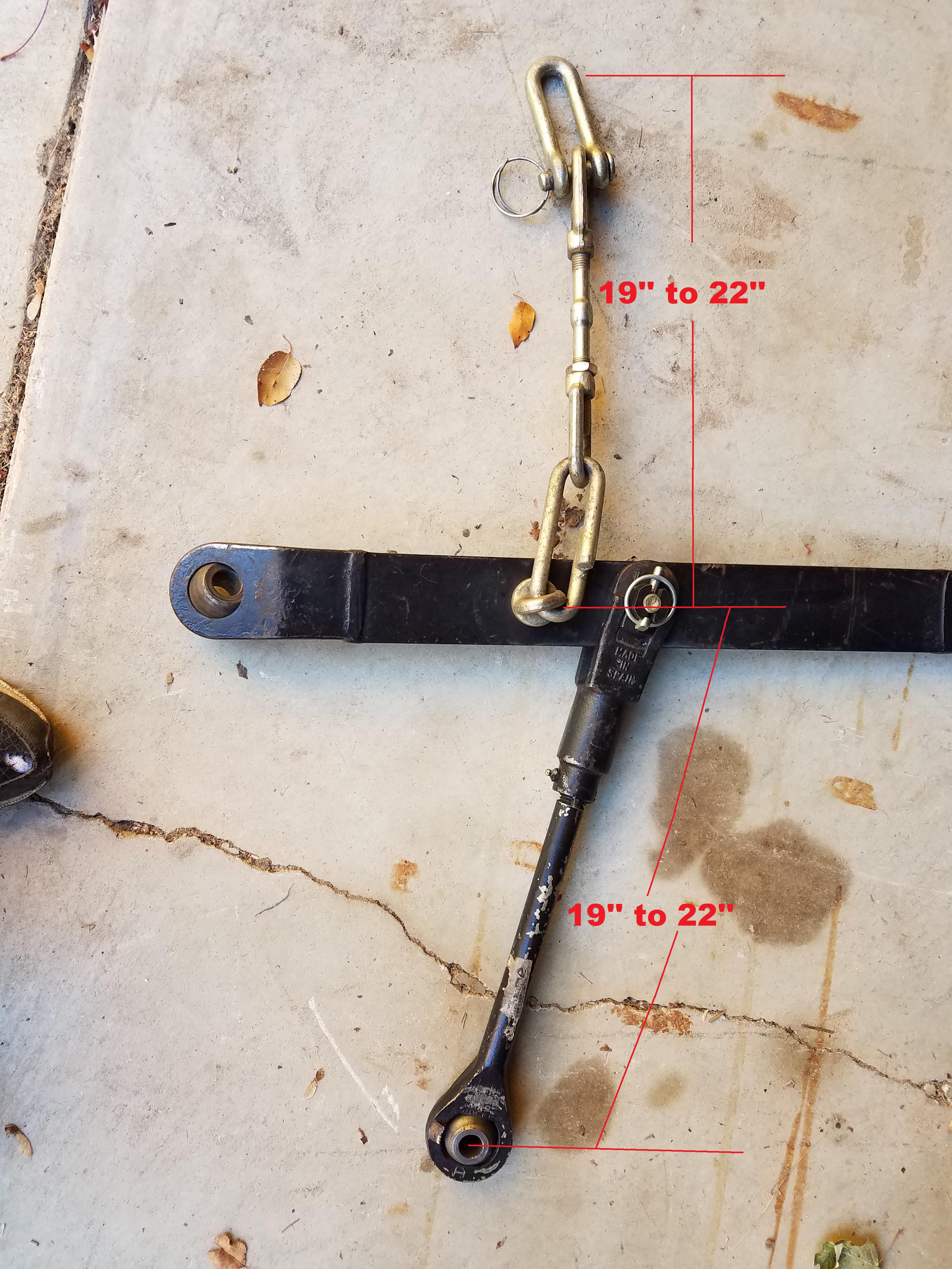

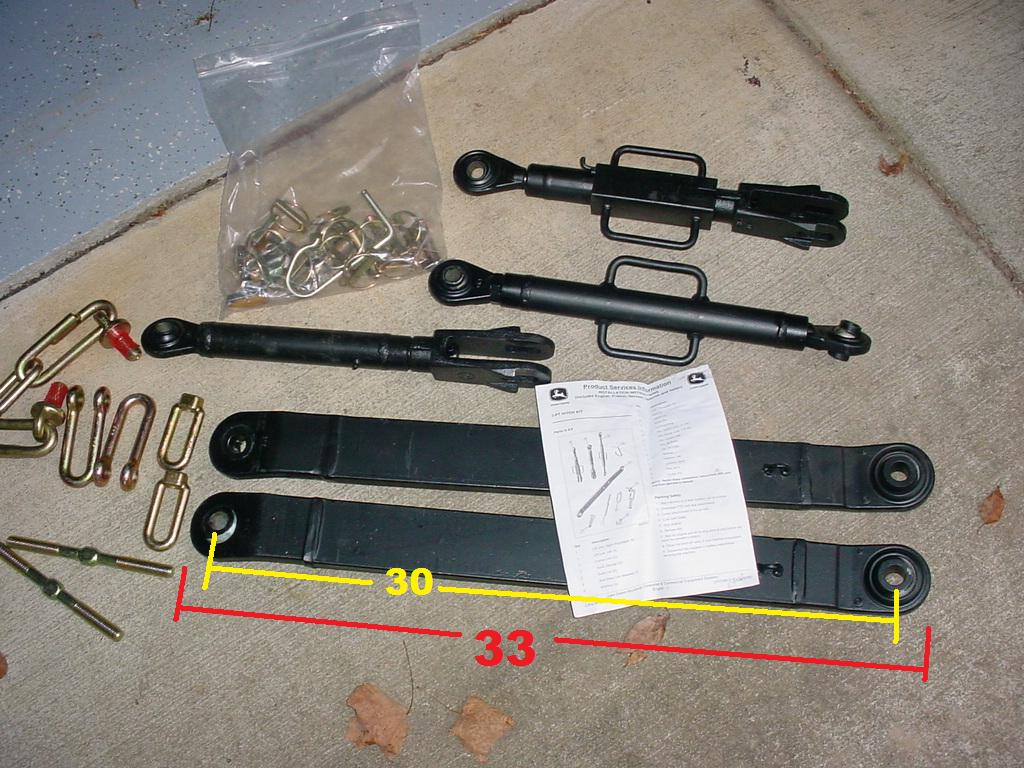

I did see that video of the 3 point install. That guy makes other videos on the 110tlb and he cracks me up. I was actually looking for the paper install instructions that came in the (now obsolete) 3 point hitch kit.

I can't find the instructions that came with my 3 point hitch kit.
The only thing I can think of is I sold an extra kit a few years ago, maybe I gave him the instructions that I had.
If I do find it, I will post a copy

Well thanks for checking on the 3 point install instructions. Maybe if I start a new thread about this, perhaps someone will see and respond.
