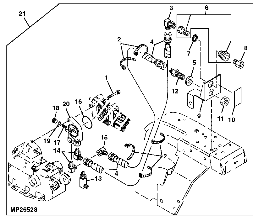

Look at the picture below, You have to install the screw (#17) in the block that's between the valve and the tranny. It blocks the flow of oil back to the tranny case and diverts it into the OUT port of your PB lines. When this is not in place, your two valves (on the splitter and FEL) are in parallel and neither will operate correctly.
