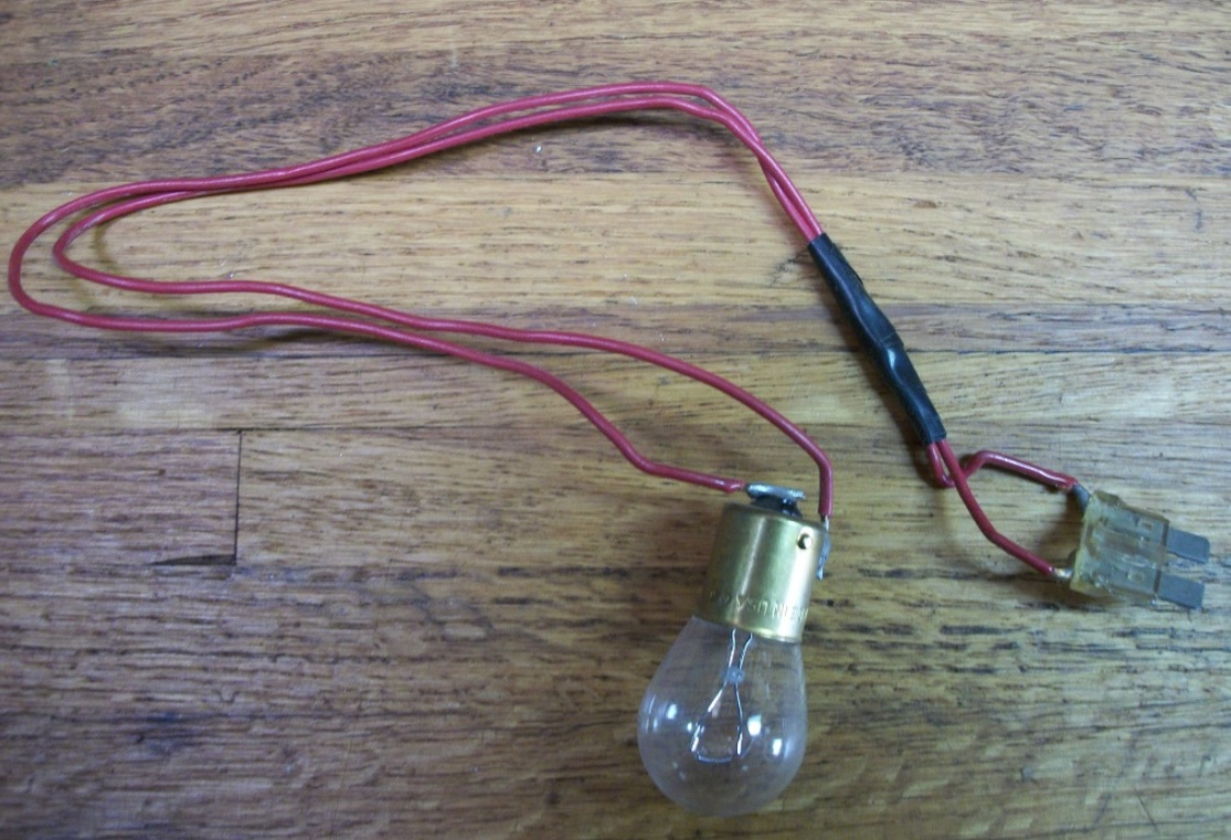

/ John Deere keeps blowing starting fuse. #6
In place of the blown fuse, insert a 12v lightbulb.. soldered to an old fuse.
That way, the short only lights up the bulb and allows you to track (or attempt to) down the short.
