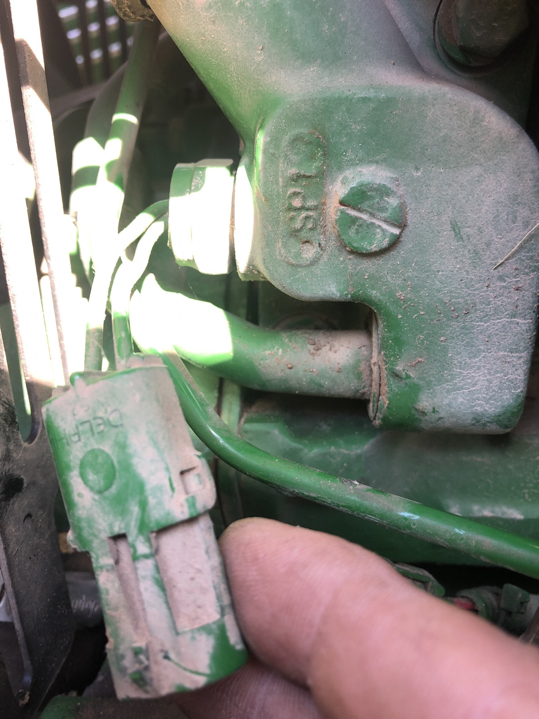

Follow the wires from the TEMP. Sensor at the neck and unplug it..
   / John Deere keeps blowing starting fuse.
#15
I’m going to check it when I get home thank you.
#16
It works thank you all !!!!!!!!
I’ll replace both of the sensors as soon as I can.

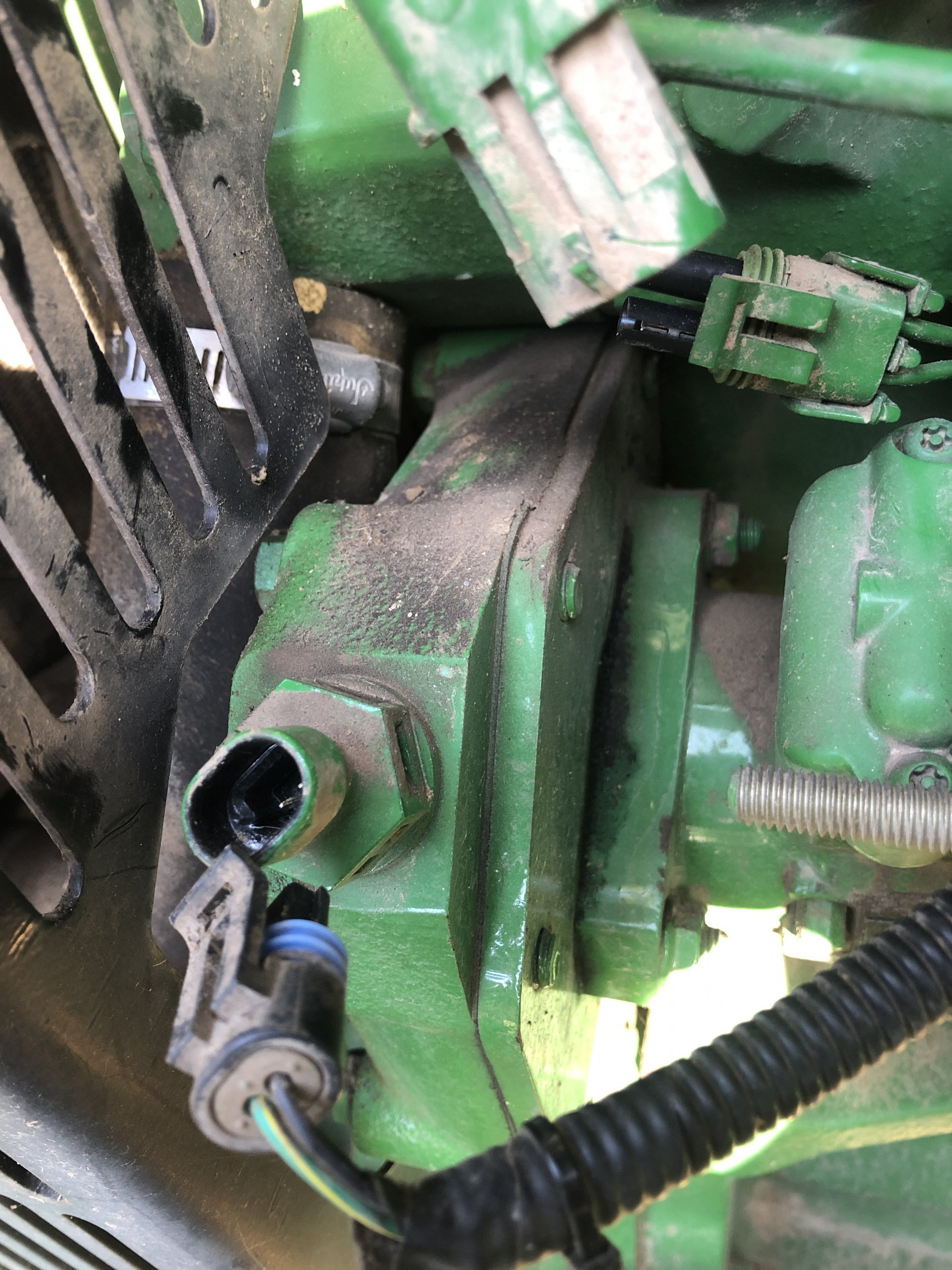

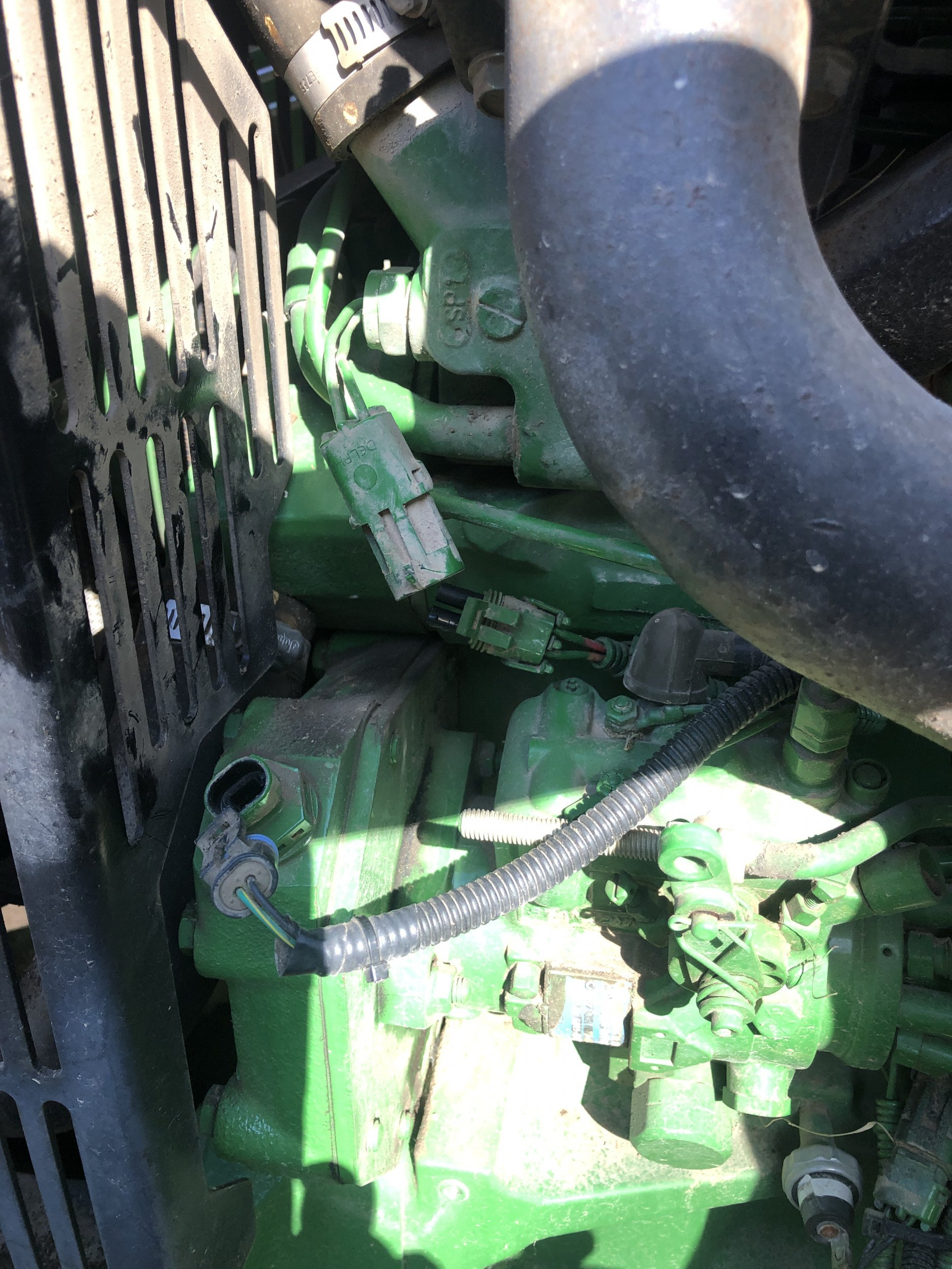

   / John Deere keeps blowing starting fuse. #20
Pic #1 is normally the main cause.. I’ve never seen #2 as a problem..
