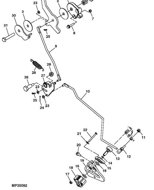

Looking at the parts section, I see that this unit is equipped with a throttle position sensor. You could try to start it with the sensor unplugged. Or better yet, remove it and test it with a DVM then freeze it and test it again.

Where is the throttle position sensor? I will give that a try on friday.
/ John Deere Full Throttle #46
Throttle sensor is item #18, assuming HST. PRT machine has no sensor.
The more I ponder this situation, the less confidence I have in the TPS being the problem. I am thinking the TPS is just an input device for the HST controller and likely has little effect on the fuel delivery. It wouldn't hurt to test it anyway.
