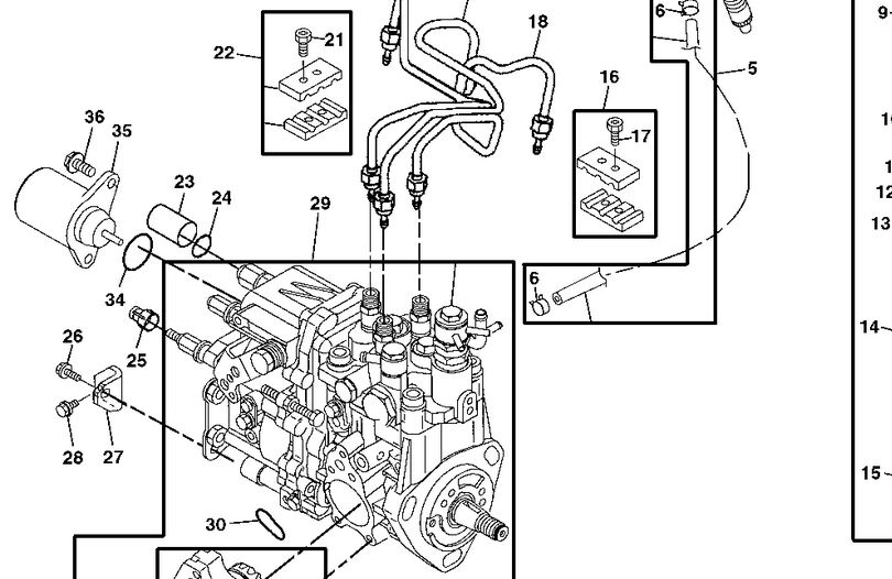

Hunter,
Your fuel shut off solenoid (35) is easily removed and lubricated.

Thanks for the diagram for the fuel shut off. I am going to pull it tomorrow and make sure it is lubed. I talked to another service man who said that the injector rack is lubed by crankcase oil and if my viscosity is too high the rack might be sticking open until the oil gets up there to lube it. That would explain why after getting it to start and idle like normal it will run fine for the rest of the day. Also makes sense considering that the problem only happens when it gets below freezing. He suggested going from 15w to 5w. I am approaching the 400 hr service anyway so this will be a cheap attempt at a fix. Hopefully it works. I'll keep you all posted. Weather it is considered a runaway or not it still sucks. :)

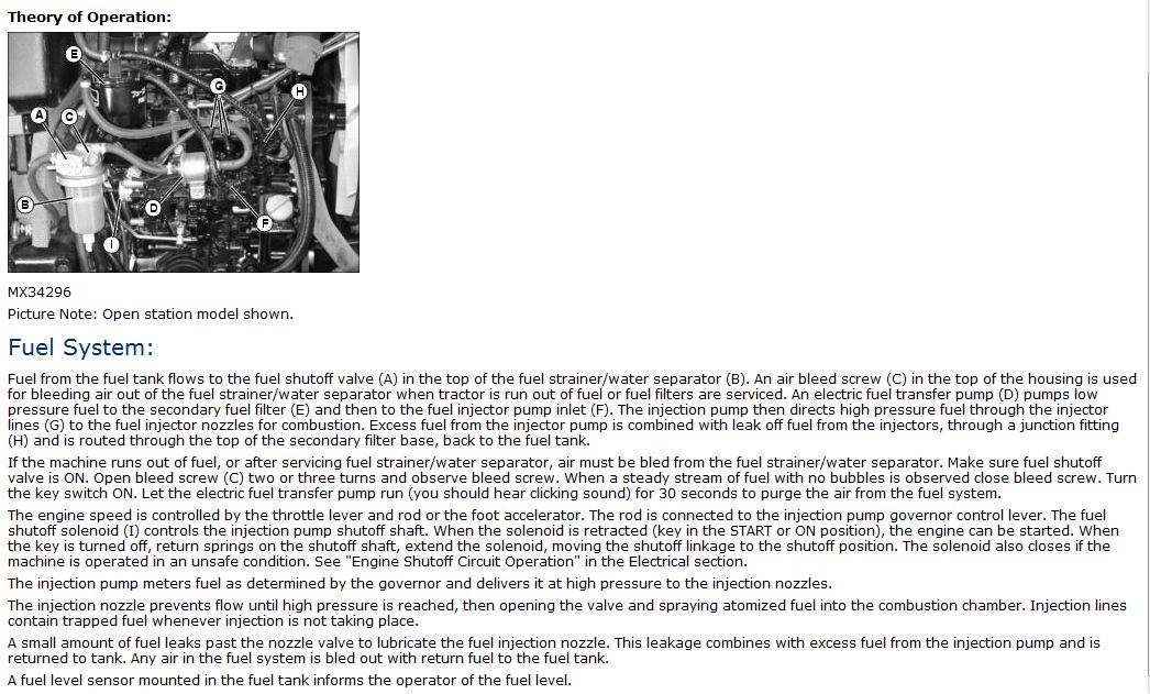

This seems to suggest a sticking governor. "The injection pump meters fuel as determined by the governor".
The governor is apparently in the injection pump and not serviceable. It does appear to be lubricated by sump oil. The oil you are using should be fine. 25 degrees is not that cold in the grand scheme. I would agree with a fuel conditioner to add lubricity and remove moisture. If the problem persists, I would get an oil/fuel sample kit and send them to the lab. OilScan brand is only about 13 dollars per sample per kit, including lab work. Usually get a response in 4 or 5 days. I would also contact your dealer to see if there is anything they can do for you.
