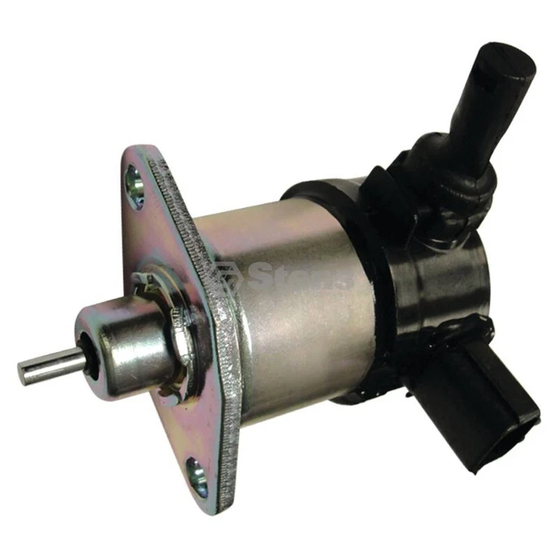

/ Kubota B7800 Not Starting, fuel line issue? #7
I attached a photo of the fuel shut off. It should activate or pull in when you turn the switch on. If it doesn't then that's where you need to start looking. I see they also have a system they call OPC which in layman's terms means if you fall off the tractor dies. There is a whole logic chart to that. It's also possible the issue is there especially with the cold weather. There is a switch inside the seat and vinyl gets extremely stiff and might not be making the safety switch since you said it's really cold.

/ Kubota B7800 Not Starting, fuel line issue? #11
glad you got it working. If it cranks its not a safety switch. now you know you should treat the fuel. I use power service but everyone has their own miracle product. The only time I had any problems was one year at christmas time when I figured I hadn't burnt the whole tank of #2 before the weather turned cold so I start treating my fuel in september so I don't get caught again.
