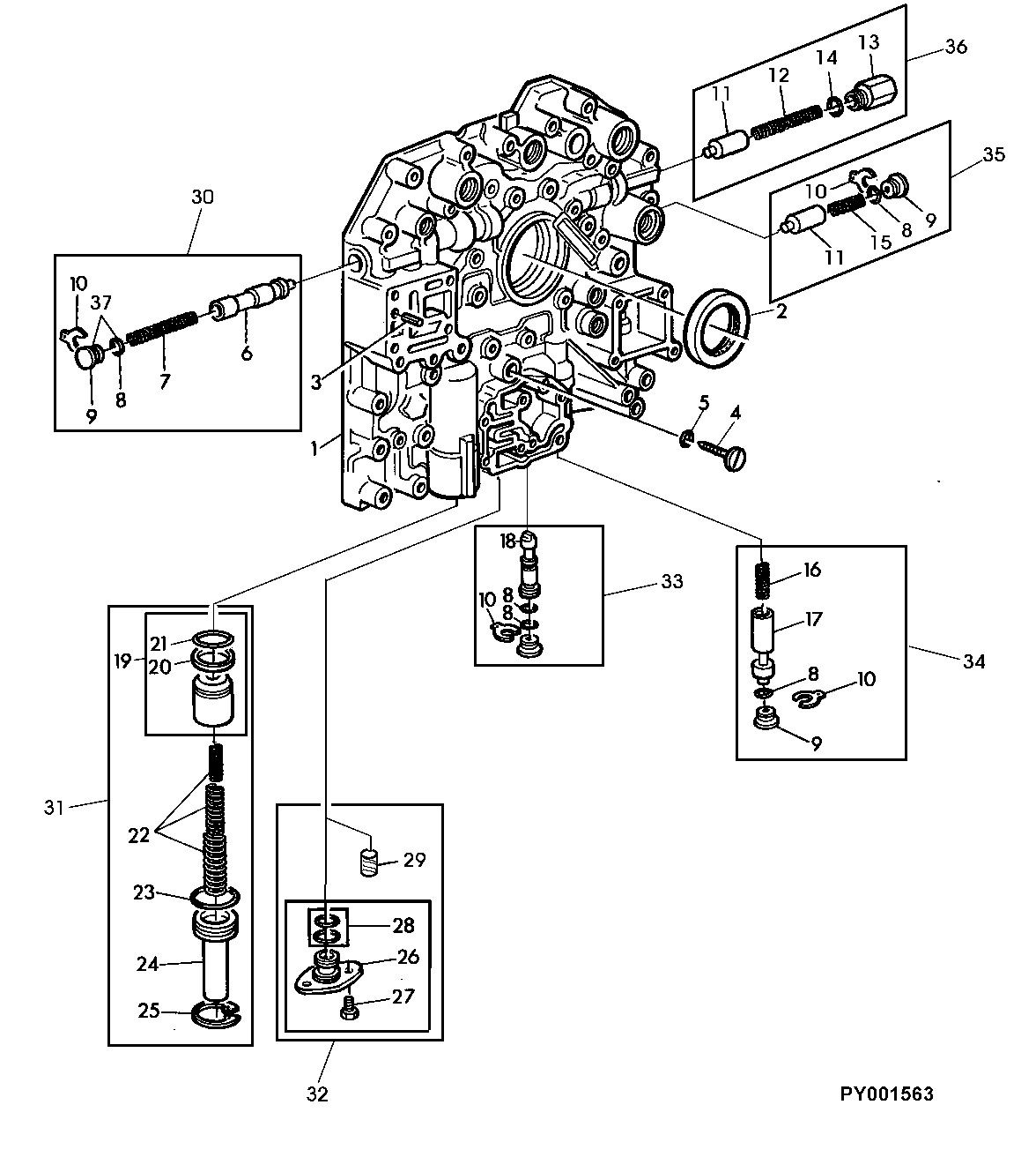

The power quad transmission has it's own oil pump. It supplies pressure for planetary clutch packs and reverse brake. It also lubes the transmission. This relief valve is to protect the pump and is located in the transmission front valve housing. There are also a filter relief valve, and cooler relief valve.
JDparts is down so I could not pull up a drawing.
JDparts is up now. In the drawing Key #30 is the filter relief valve, Key #35 is the lube relief valve, and key #36 is the cooler relief valve.

So thanks for the info on these relief valves.
There is a procedure for flushing the lube relief valve in Tech manual TM4572. Section 255-10A-55. Page number 990
Looks like this is the next plan for the OP to follow.
