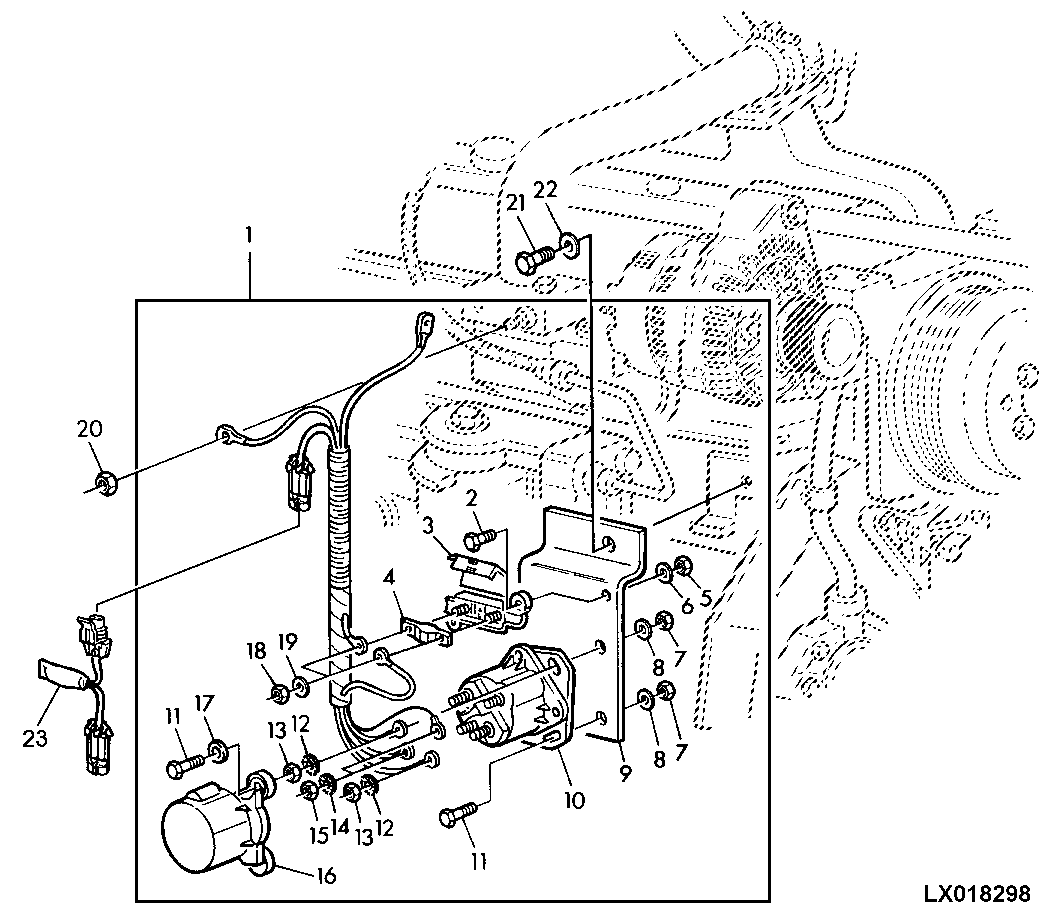

/ John Deere 6410 tractor won't start #7
Check operation of parts key 10 the starter relay

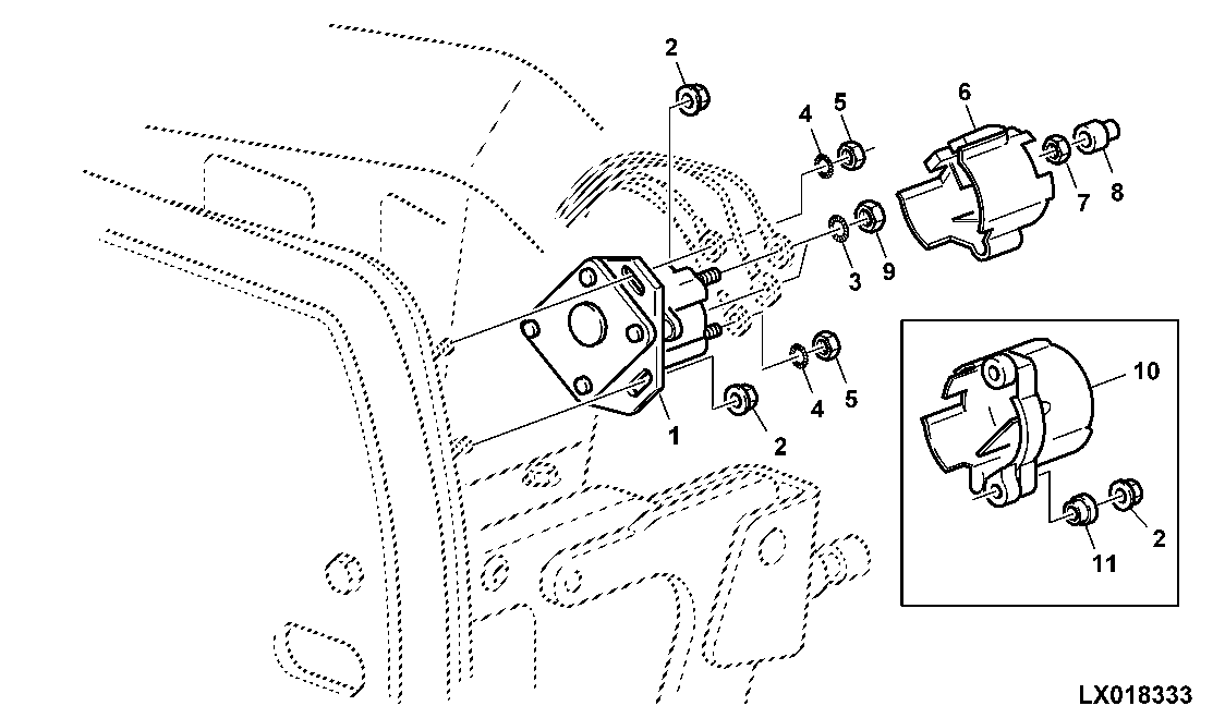

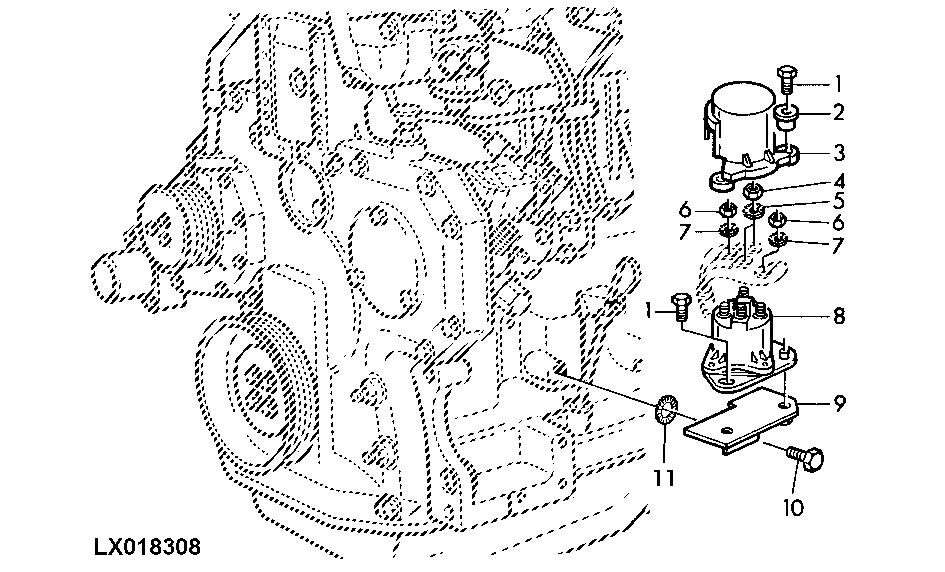

/ John Deere 6410 tractor won't start #10
Cab or open station?
Starter relay for cab is on left side of engine.
Starter relay for open station is behind dash.
/ John Deere 6410 tractor won't start #11
Thanks for correcting my MISTAKE. I guess I'll have to blame that mistake on my lack of knowledge of newer JD tractors & the JD parts catalog heading as it was listed under relay,starter but upon further investigation I read (OPPS) WIRING HARNESS, ENGINE STARTING AID
