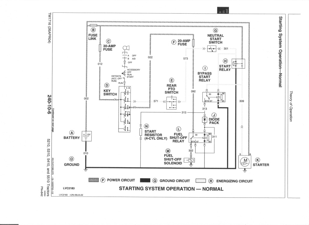

I was shredding brush when it stopped running. Like you turned key off. I have lights and gauges work. Starter will not turn over. I'm sure a wire got pulled loose but don't see any scanning over it. Any ideas where to start? Thanks.

Start with the simple things. Are all the fuses good? Here is a link to an online operators that will have fuse info. Have you checked the safety switch wiring. I am sure you have done this, but cannot hurt to mention it, did you turn the PTO off.
John Deere Ag - New Equipment: Technical Publications - Equipment Search
I have attached a few starting system. I do not know how close it will match your tractor, but can not hurt to take a look at it.

Thank your. Fuses will be my next step.
Have you disengaged the PTO before reattempting to start it?
