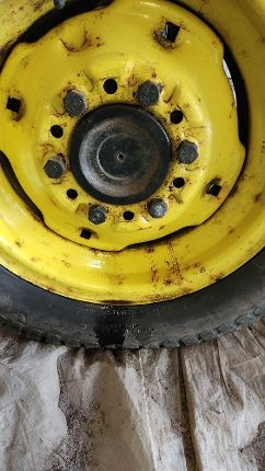

John Deere 4300- I have this fluid leak in my left front tire area and was wondering what and where the fluid is coming from and how I can repair it. I am just guessing it is a seal gone bad in the front axle. Any thoughts will be appreciated.
Post
ing a few photos to highlight the problem,

I've had a JD4300 for 24 years. No front wheel leaks have occurred. Based upon the video, hiring a John Deere dealer to do the repair appears necessary.
/ JOHN DEERE 4300 small leak #6
Search for the way to replace the seal. Likely is the problem. Fixable if you have such mechanical and are interested in DIY.
I experienced a seal leak before I learned to loosen the fill plug to relieve the pressure caused by the oil in the axle warming up and pushing out the seal. If you are seeing the oil leak after doing a lot of work that might have caused this pressure, then you may try loosening that fill (dip stick) plug after replacing lost oil.
I believe the service tech manual explains how to replace the seal. That is what I was planning to do if the seal ever got worse. It hasn't since venting.

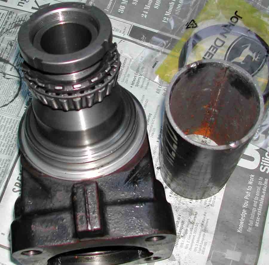

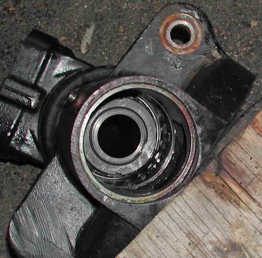

As for DIY repair of the front axle, it is not too bad. Remember when I posted about it years ago?
You have to make this special tool to get the nut out, and have a good set of snapring pliers. It is just a piece of pipe with a couple of weld beads on the inside.
As for the video, it was tough to watch the excessive use of a hammer....

Do you recall or have the inside diameter measurement of that pipe that you used to make the special tool? A clever way to skin that cat.
/ JOHN DEERE 4300 small leak #11
My first 4300 rebuild thread was 15y ago, and I did not separate the part about the front axle rebuild. It starts at post #115 here:
I was re-reading this old thread, and it has brought back memories. It was a fun read, if I do say so myself. :)
In my second 4300 rebuild, I started new threads for the various repairs/rebuilds that I performed.

Both wheel seals on each side are leaking. Before you go digging into the wheel seal for replacement. There's a couple small tricks you can try. First, drill a 1/16 hole in the fluid dipstick so the axle can vent and not pressurize. The other option is to replace the fluid in the axle with actual gear oil 75w-90 instead of JD Hygard.
I know JD recommends hygard for the front axle but it is not ideal. Its got too low of a viscosity. The front axle is self contained unit so if you put gear lube in the front axle you will not contaminate the hydraulic system.
I have a 4400 and 4310 that have the exact same issue as your pics showed. It's a well known problem with JDs and they still refuse to address it. There's aftermarket vented fill caps designed to address this very issue. After I went with gear lube and vented the axle the leak was so minuscule that it wasn't worth addressing. Every 8 month or so I might need to top it off.
/ JOHN DEERE 4300 small leak #13
Just leave the dip stick fill plug loose and it will vent. Works for everything except driving the axle underwater. At least has worked well for me. And don't use the low vis Hygard oil. Straight Hygard is what I use. Again, works for me but each can plan their own way.
