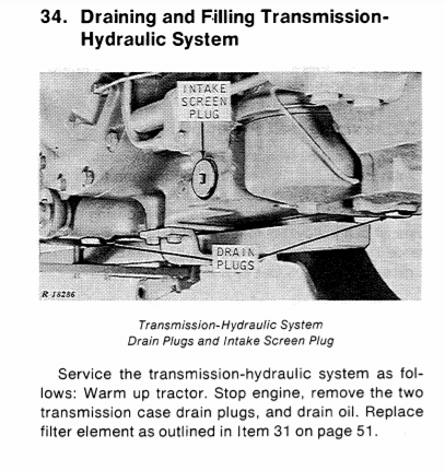

I suggest to drain hyd oil, place L/D control under seat in "min or D", remove 3pt draft arms & slide L/D shaft out of trans, inspect shaft for wear & replace if wear can be detected. Place seals in warm water to soften then R&R seals. place hyd oil on shaft then reinstall shaft & draft arms. Utilizing shim washers remove any side to side motion of the shaft. Now would be an excellent time to check hyd oil suction screen & filter. Refill trans with hyd oil that meets specs of J20C
