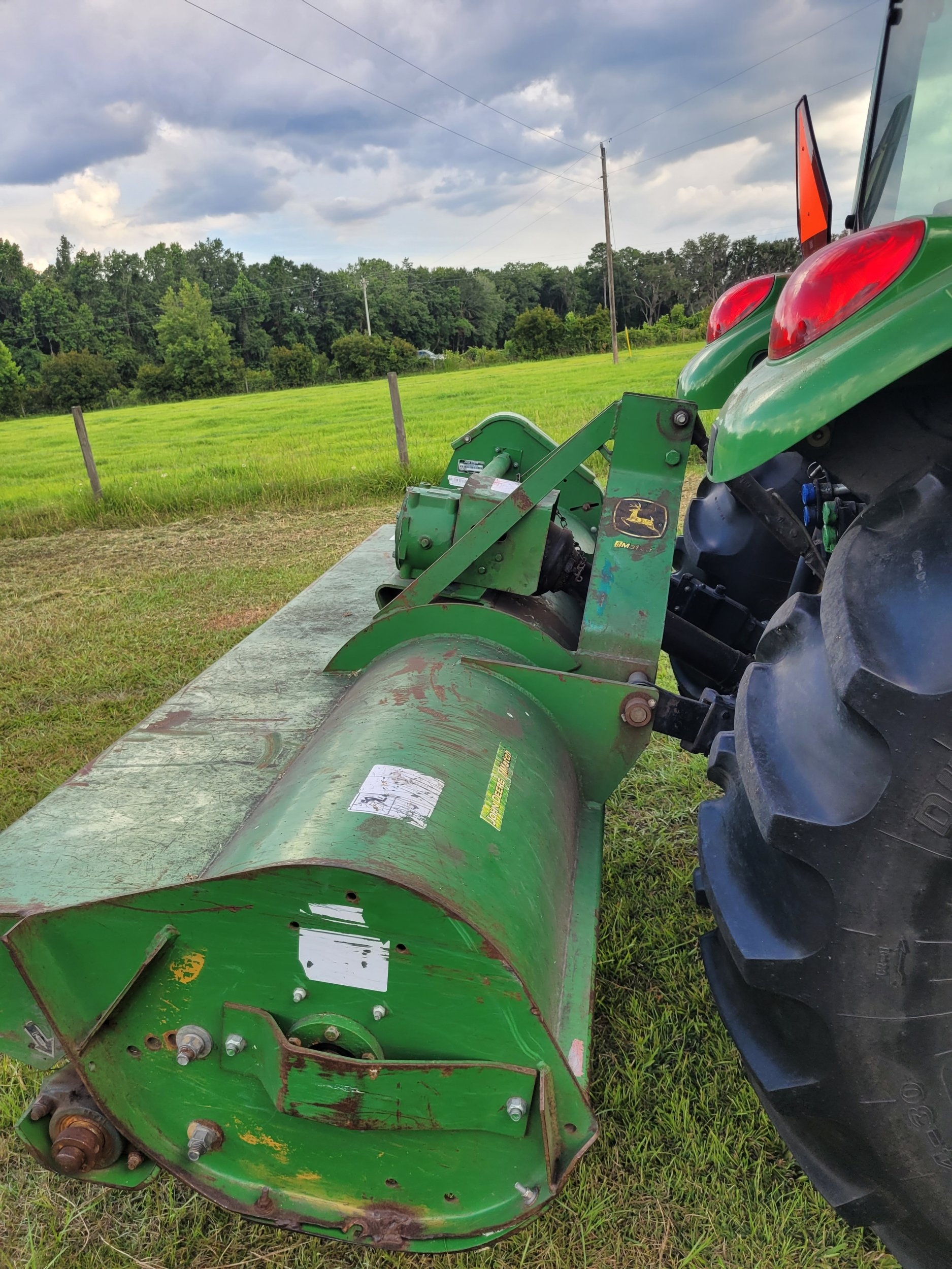

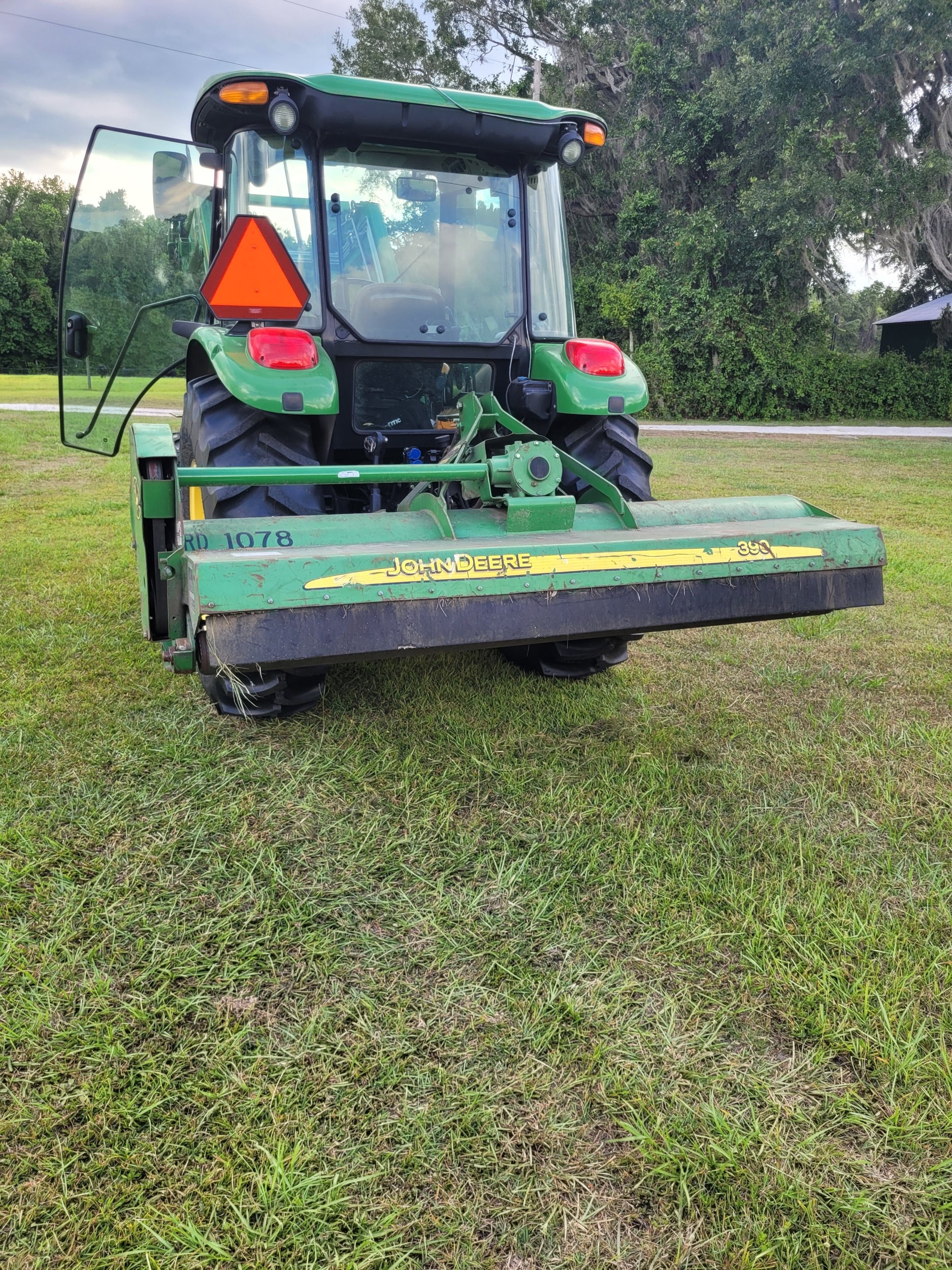

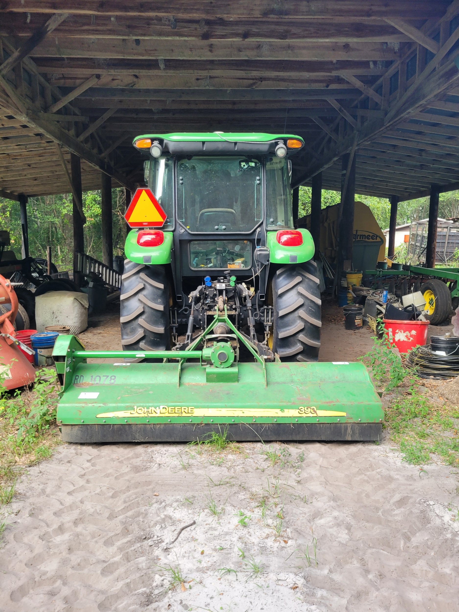

Here are a few pictures of it, I didn't have a lot of time this afternoon but I tested it and it seems to cut fairly well.

I'm going to work a job tomorrow and I am going to try it, probably a little trial and error learning how set it up and adjust for a good cut.
