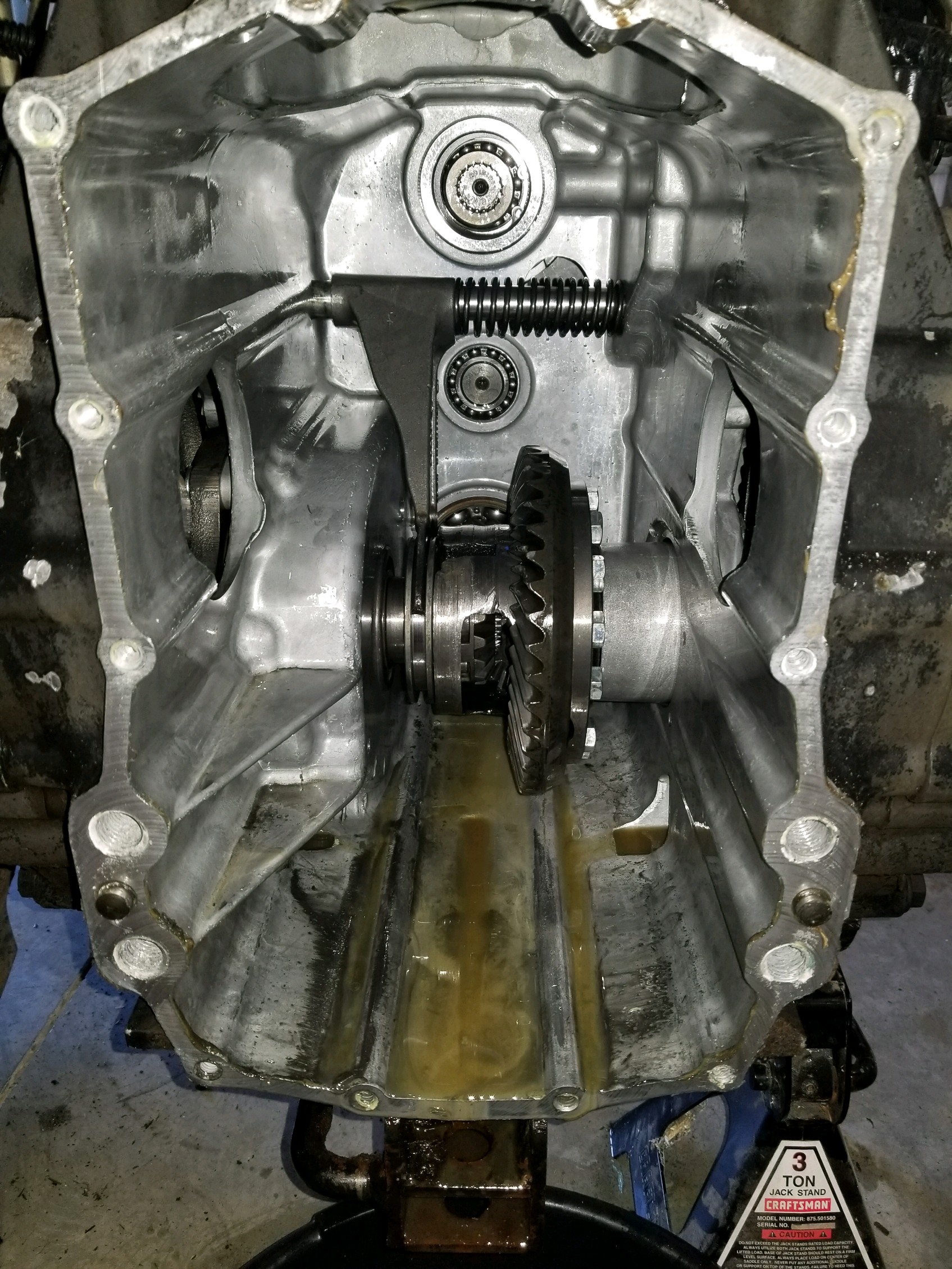

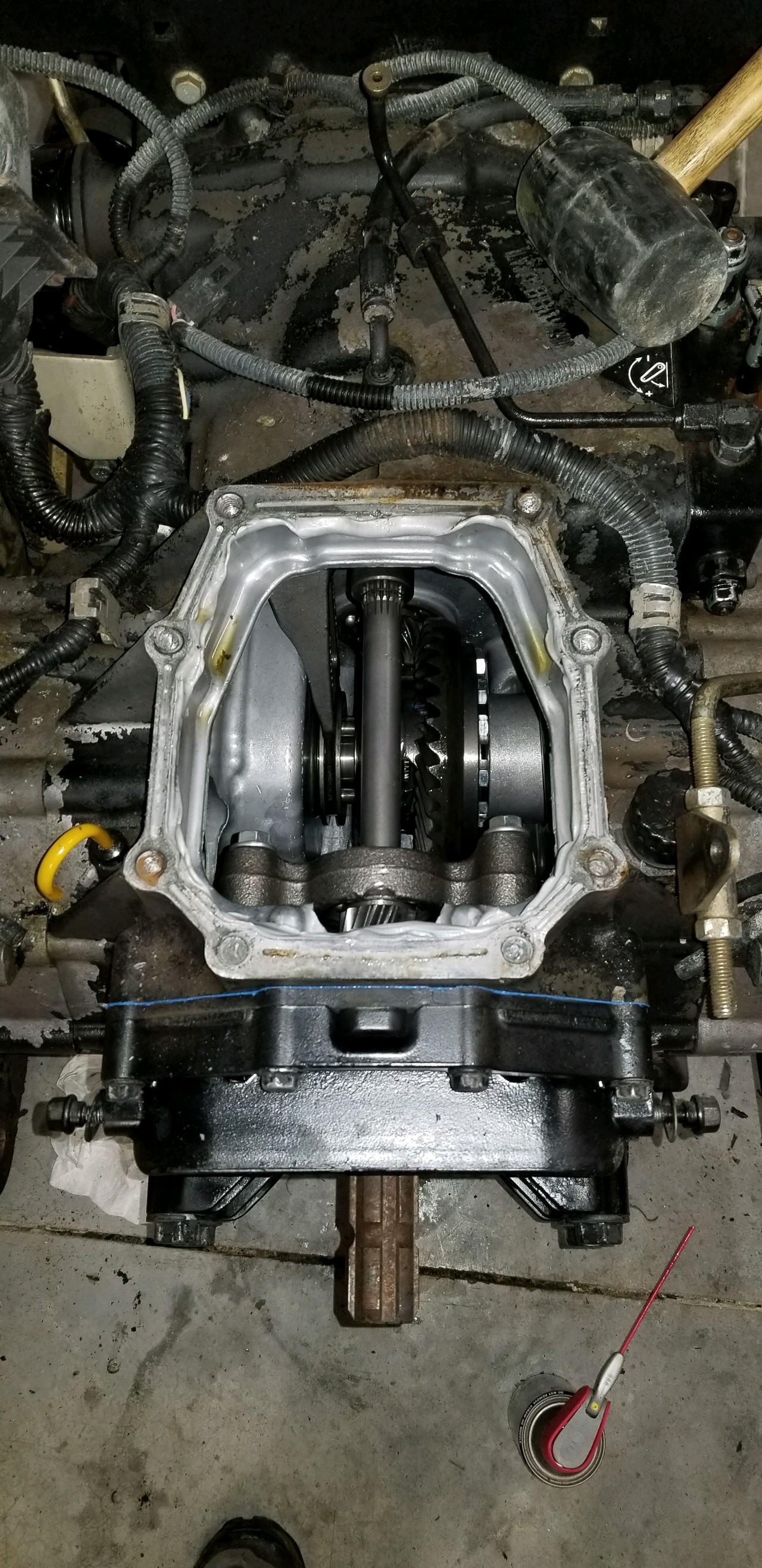

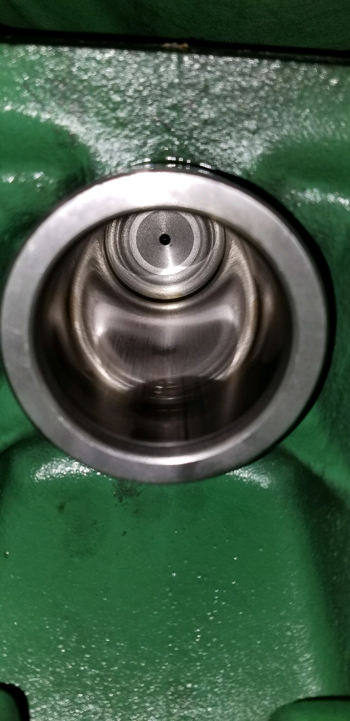

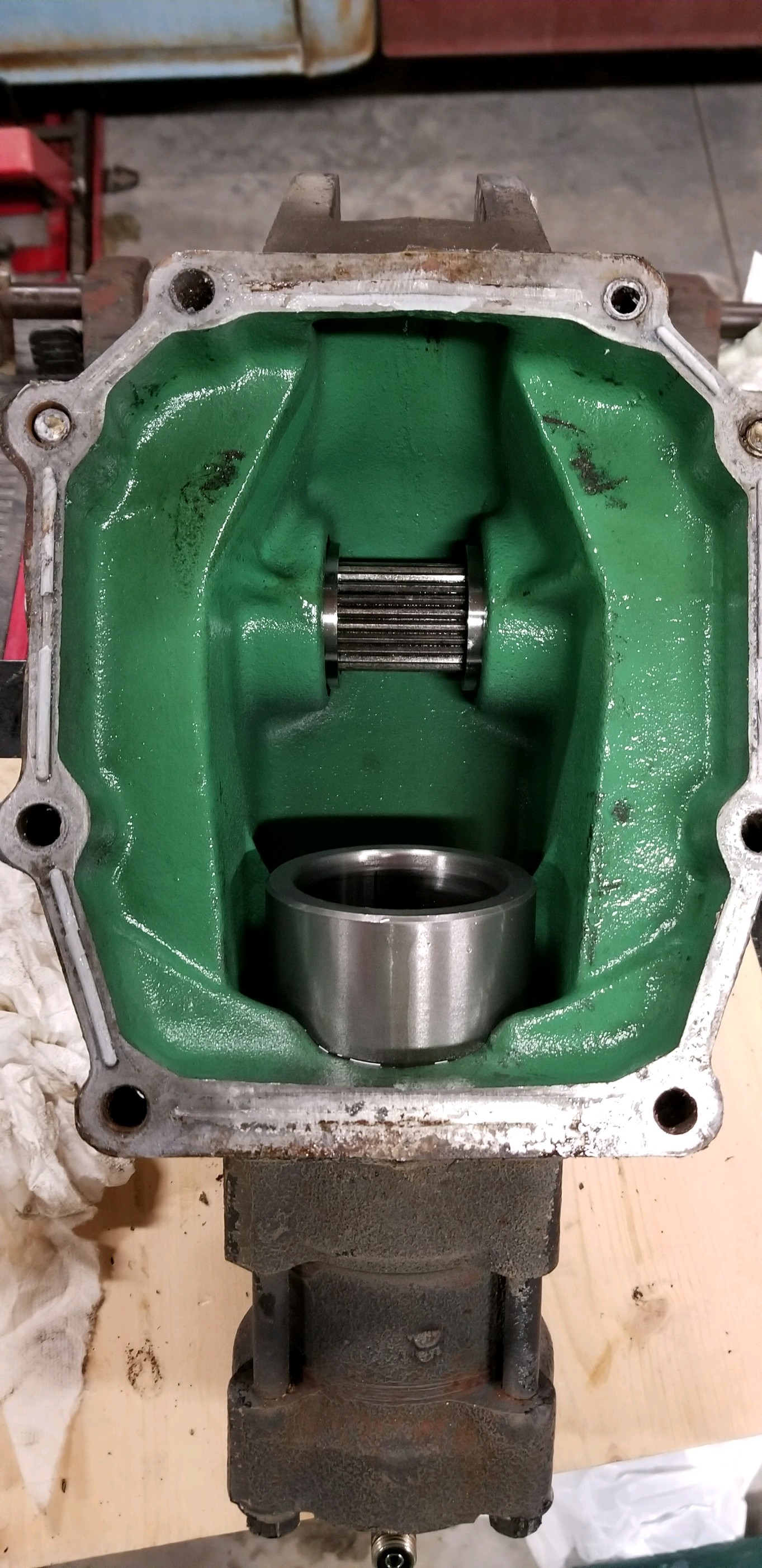

So after much anticipation I finally had time to strip the tractor down and remove the rock-shaft valve and inspect it. After tear down I found that it was in great working order with no defects found. so I then preceded to check the pump which I found no issue as of yet. However, After rechecking the hydraulic fluid and finding it a little low from removing the valve and such I was in the process of adding fluid when I got out my bore-scope camera and decided to inspect the rear differential. Almost immediately I found foreign debris sticking out of the oil.. Not good.... I then drained the oil and found that the drain was blocked by something heavy... I then removed the back cover to the PTO and found my main issue. the Piston and shaft for the rock-shaft had broke and fell in the the cavity below.. As well the previous owner mush have realized something was wrong and took the lift arms apart dropping the lever into the rear end as well... So luckily it didnt do too much damage.. it did enough but its still usable for my application. So now I know why my 3pt does not lift and what I need to do to fix it.... If anybody cares... 20180918_124243.jpg20180918_125248.jpg20180918_125250.jpg

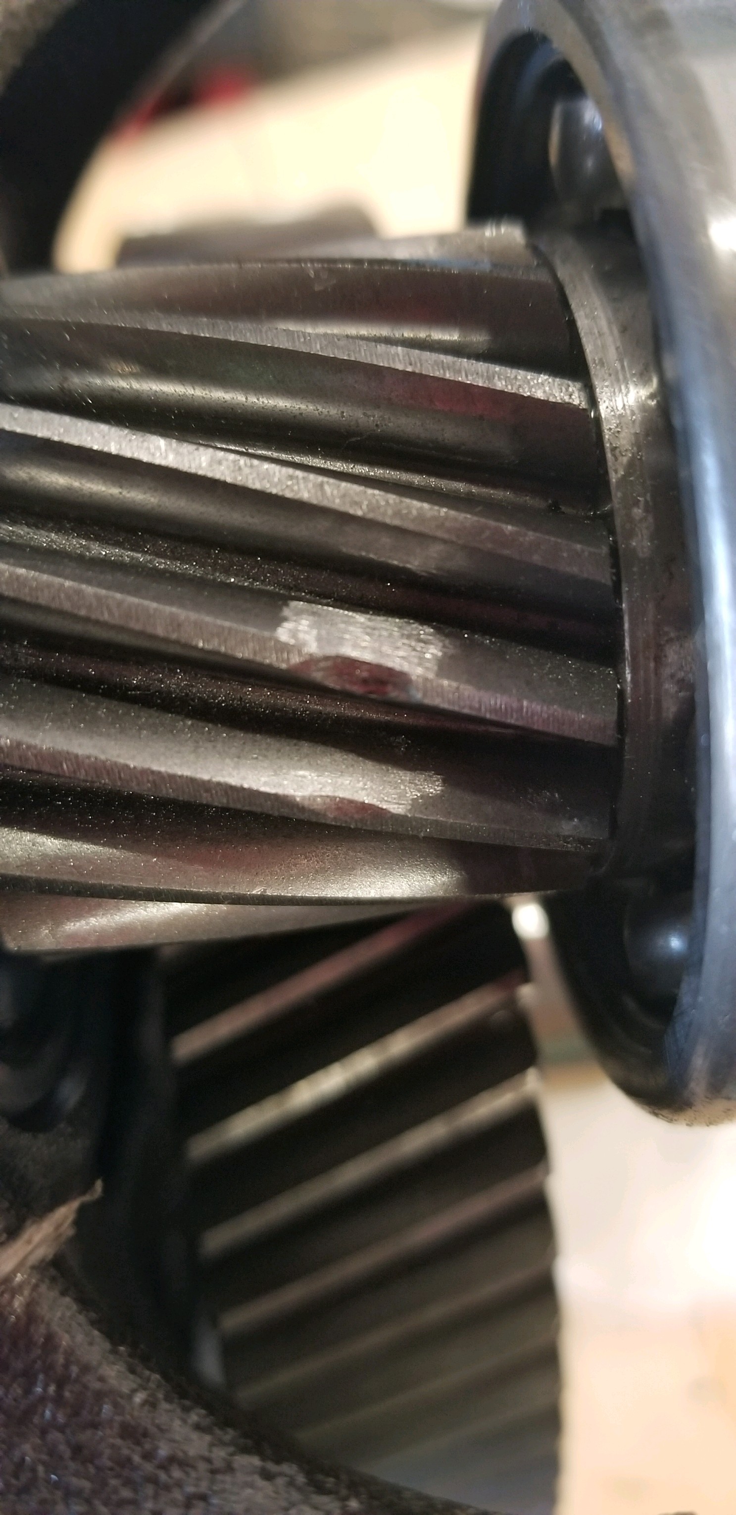

Or pieces of the pinion and ring gear.
Looks like some of the ring gear teeth are already damaged/chipped.
/ John Deere 3038e 3 pt not working. #8
Good catch Dan. I didn't look at the pics.

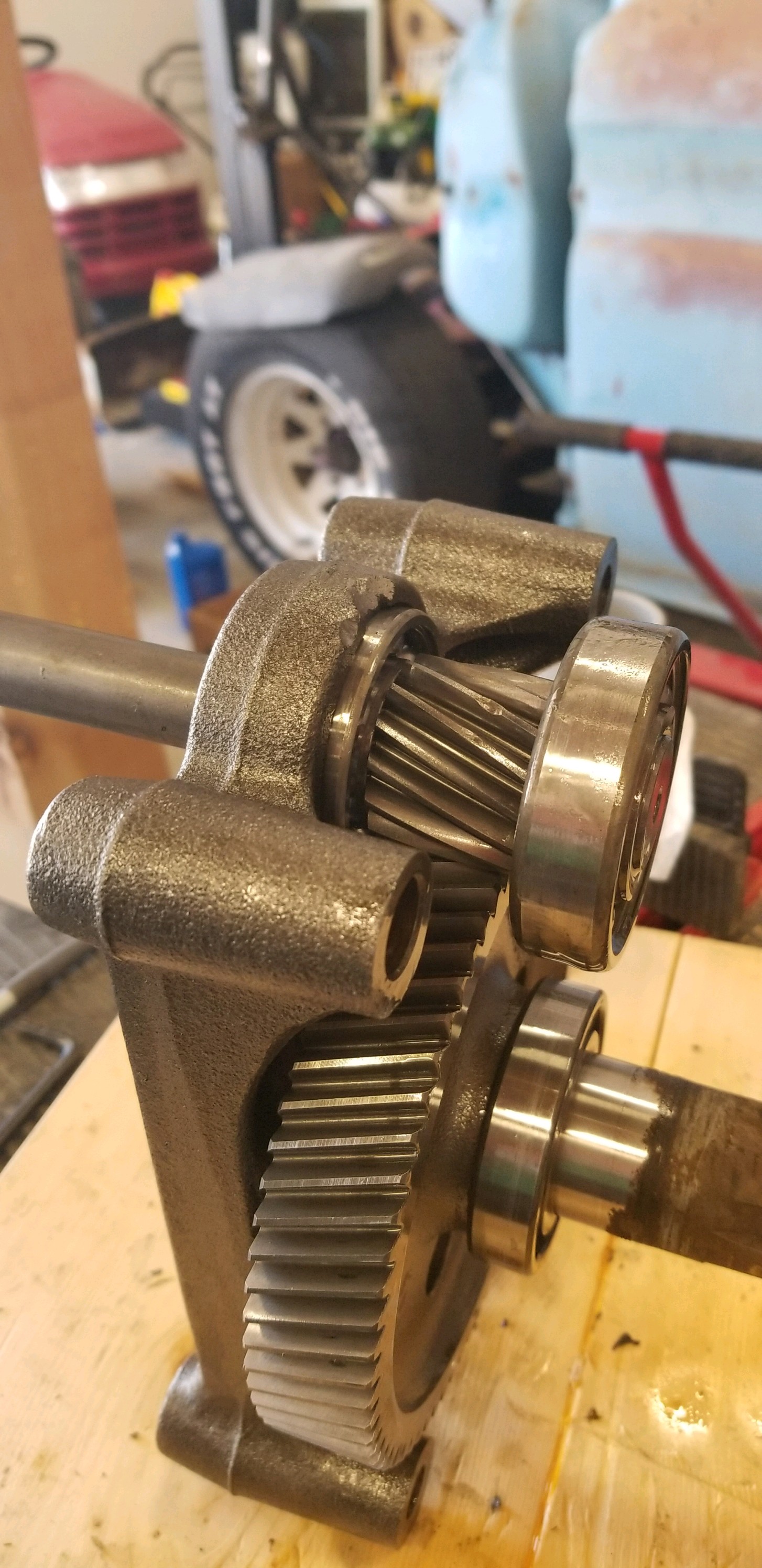

Agreed! In this case it definitely applies... it runs smooth and doesn't catch.. unlike my pto gears.. which I will be shaving down to smooth them out.. found out why the pto was noisy. It got hit by the lift arm. Luckily it didnt do much other than deform the gear tooth a little.

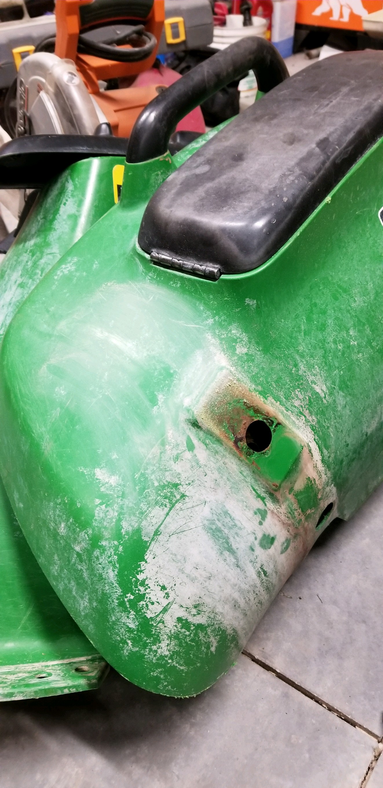

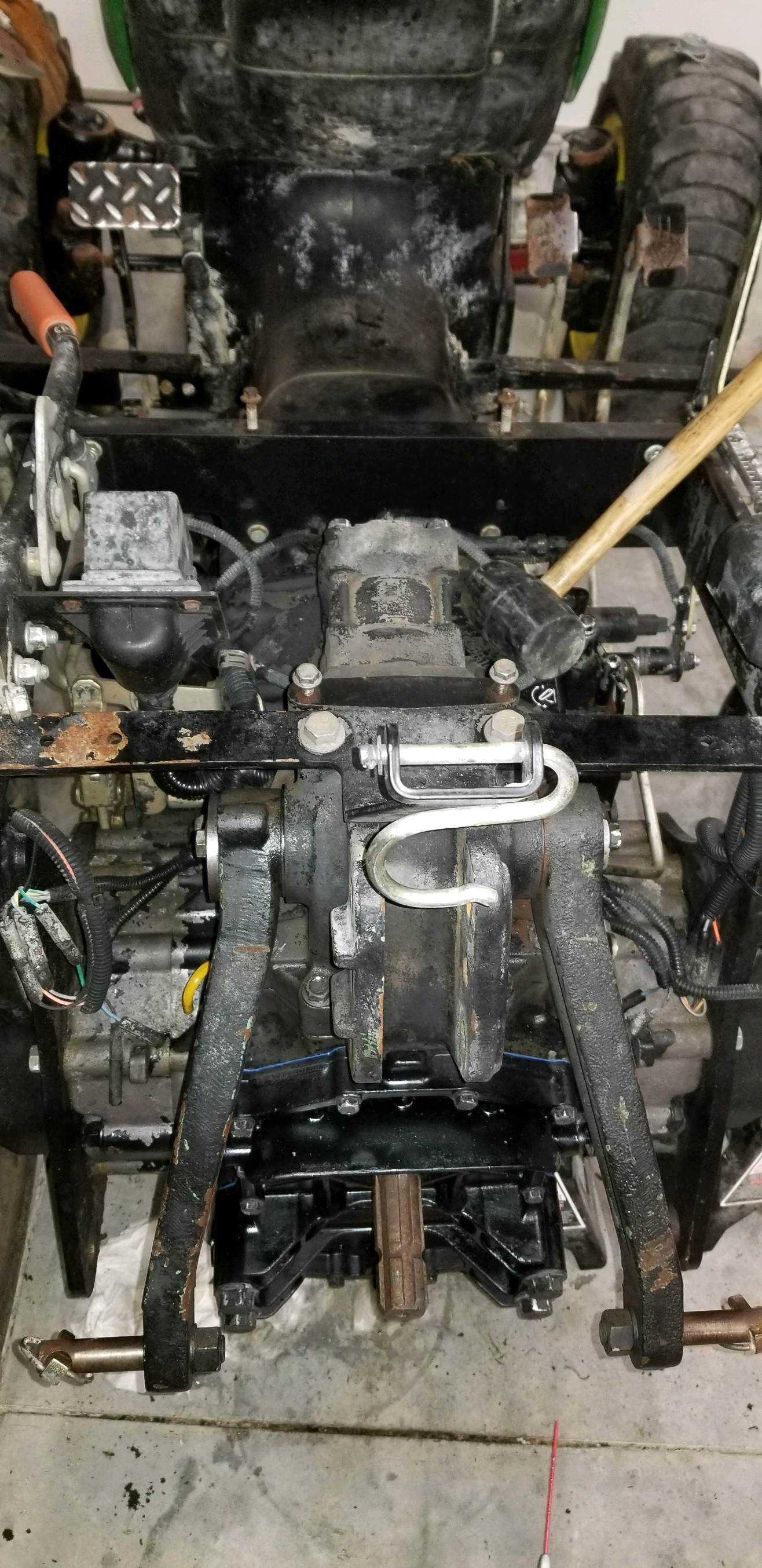

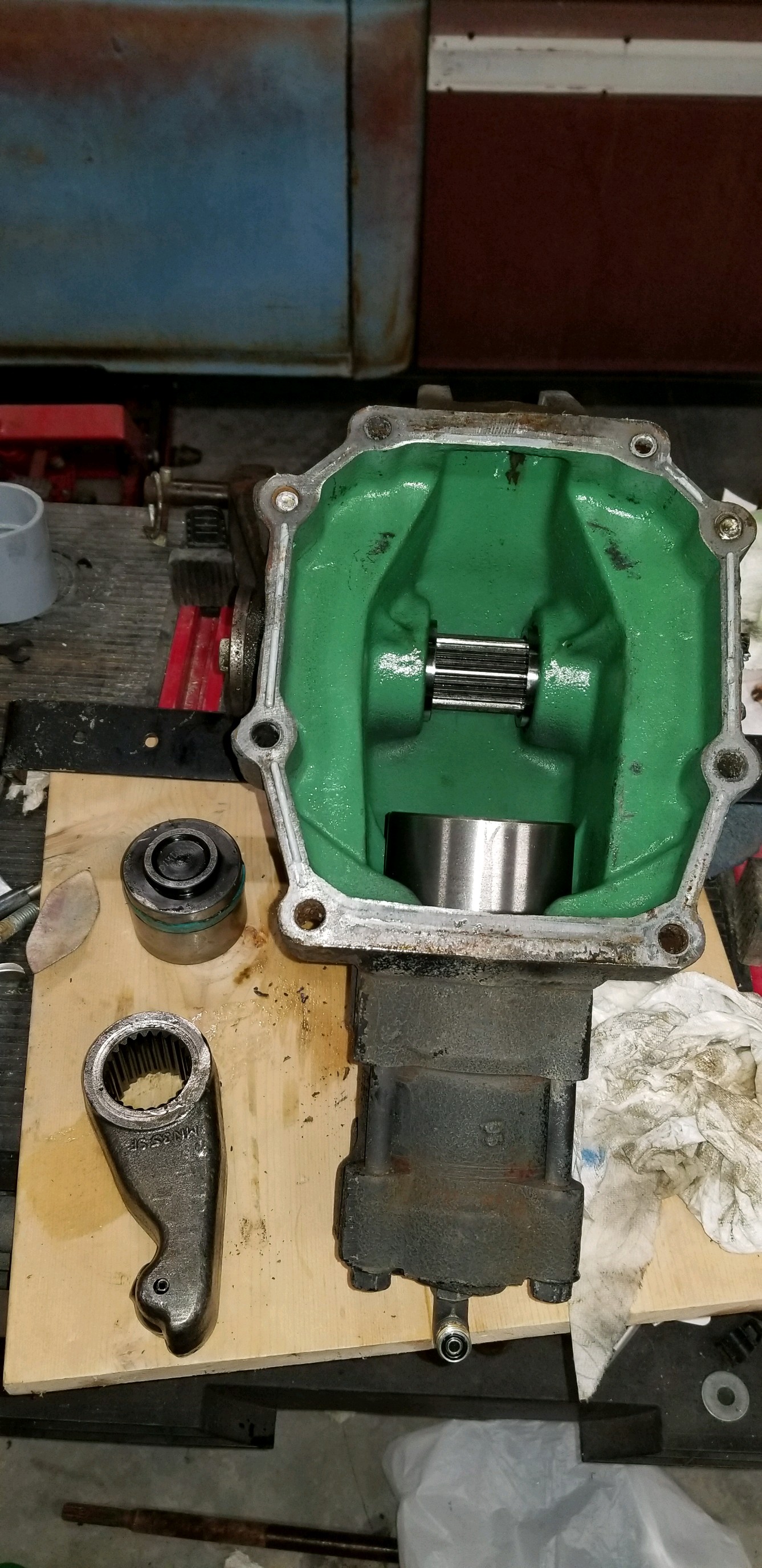

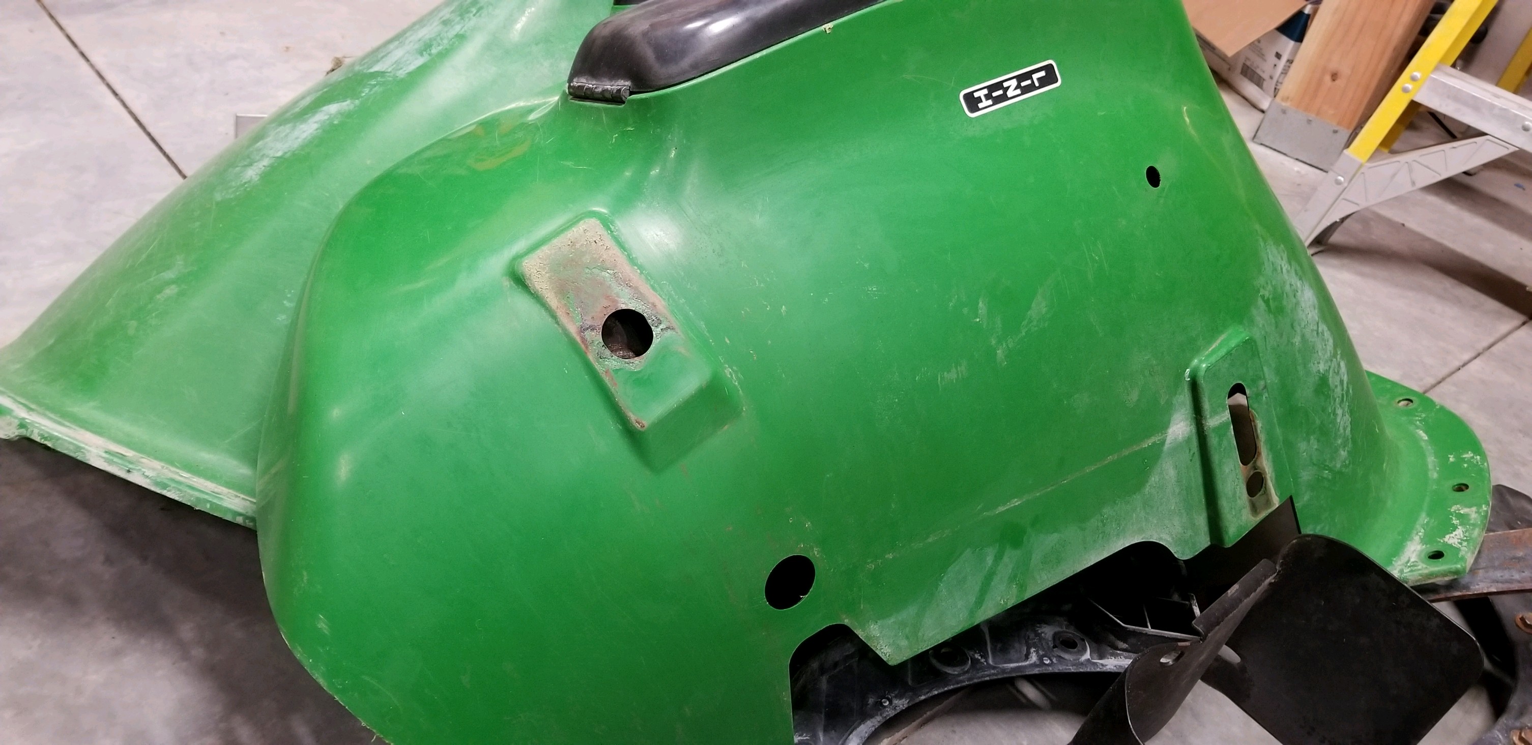

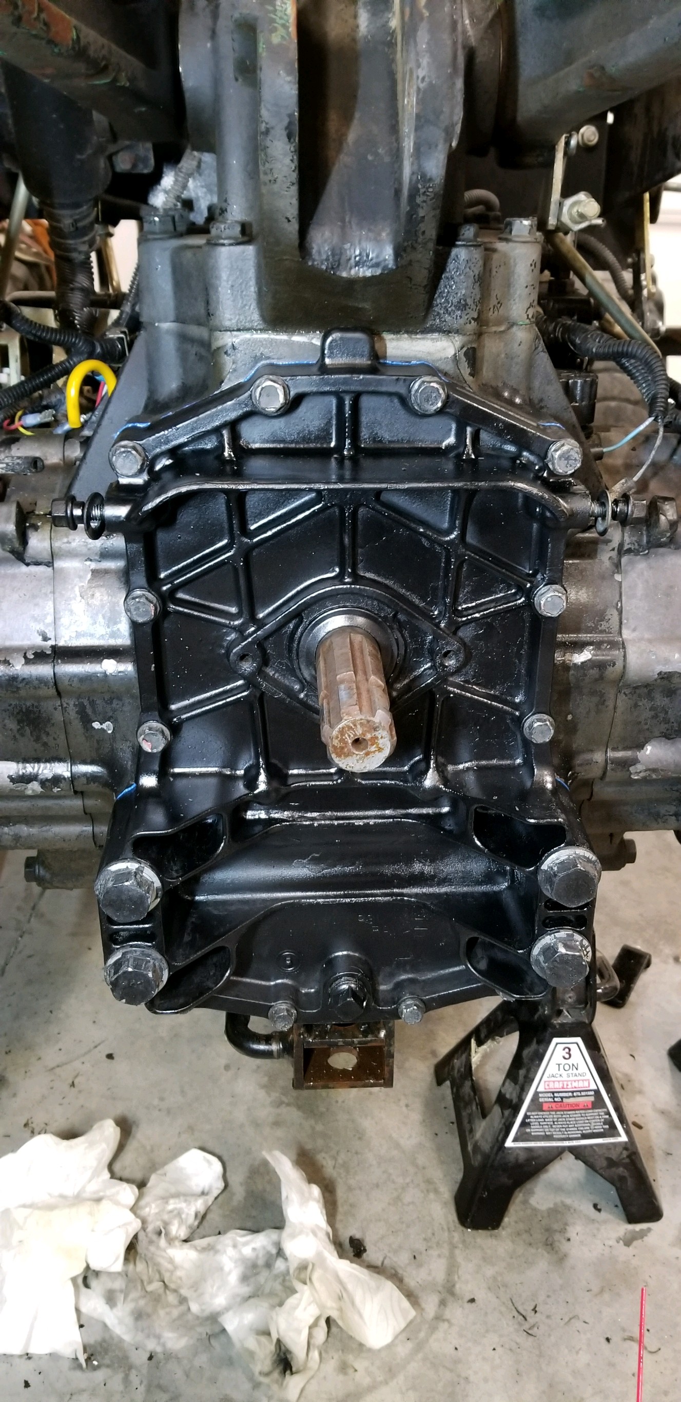

Still waiting on parts from Illinois but that isn't stopping me from getting things ready for when they do arrive. So today I took the time to de-burr the PTO gear and got it running smooth again. I then cleaned up the cover and put a coat of black on it and reinstalled it onto the back of the tractor. I took the rock-shaft cover off and inspected it for damage. Surprisingly I didn't see any... But with the cover off you can see how vulnerable the rear diff is if anything breaks... I also decided to start cleaning up the rear fenders. They are covered in hard water deposits. In order to remove them I used #000 steel wool and then some plastic polish. Its been a good day. I just wished my parts arrived today like they said they would. Included are pictures from what I did today.20180925_142850.jpg20180925_204238.jpg20180925_204226.jpg20180925_204040.jpg20180925_203156.jpg20180925_201511.jpg20180925_195300.jpg20180925_195126.jpg20180925_144106.jpg20180925_205011.jpg
