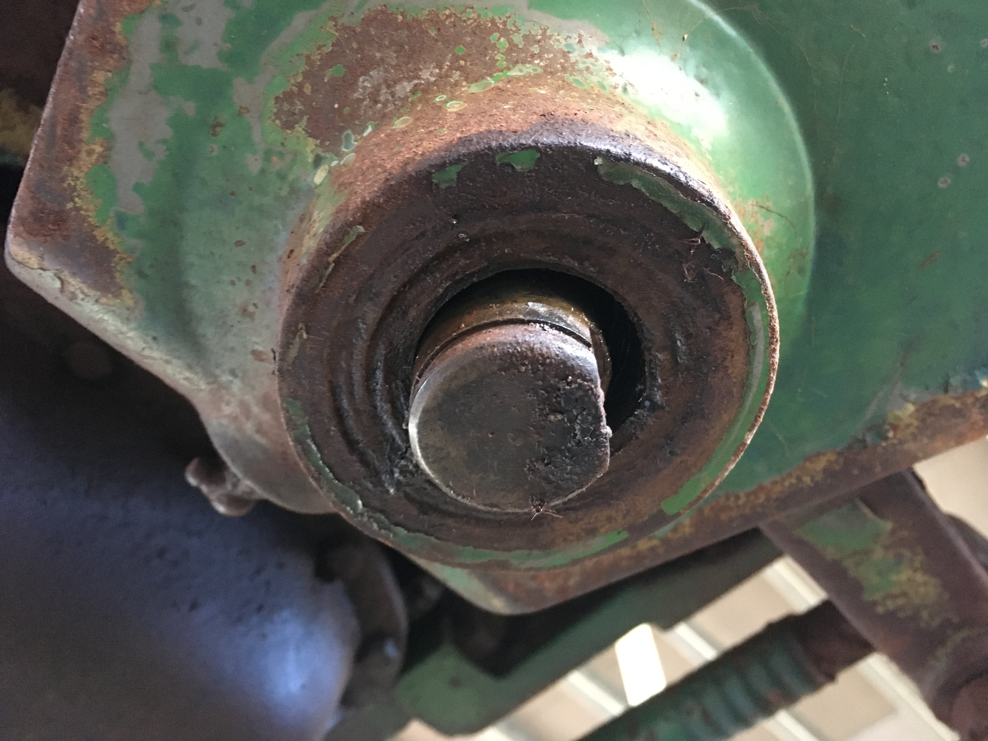

Mine was the same when I drove it home. Due to the lack of needle bearings there was so much play. It did a number on the bell crank and was past home repair so it is now in at the local machine shop. They are going to line bore it and bush it to suit new bearings. I also have them making a spacer up to fill the void between the bearings as there is nothing stopping the top bearing walking to the bottom which I think has happened. Also the circlip was missing from bottom of bell crank shaft which probably did not help.

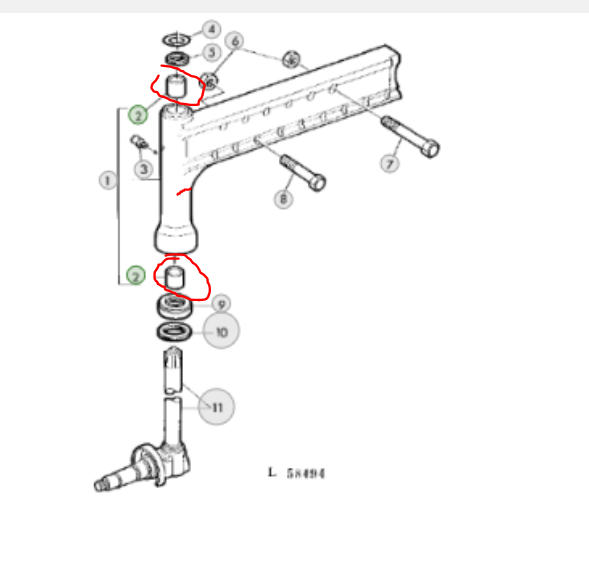

I rebushed the knees on my 2030. It might not have needed that, I did not see any improvement. Upper and lower bushings, two per side.

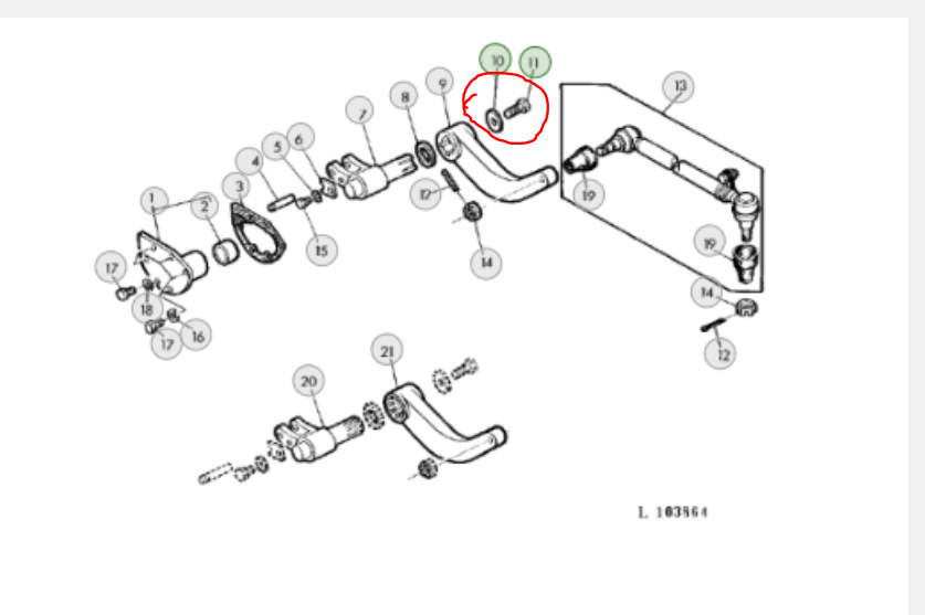

A BIG improvement was to replace the washer that bolts the draglink arm on. Recommended by user jd110. IIRC he stated JD came out with a fix for loader tractors, that was a thicker washer. I don't know if it was the thicker washer, or torqueing the bolt to spec when the new washer was installed.
The bolt is also longer, 5/8 x 1 3/4" (was 5/8 x 1 1/4") The old washer was .250" thick, the new .510" thick. P/N T42971 $24
Mine no longer "death wobbles" at road speeds when "roading" the tractor.

Zebrafive I will have a look at that washer and see it it stays tight. The knee bushings seem to be in good condition there is minimal play in them. A bit up and down but side to side minimal. I am getting the machine shop to make up an interference bush to go between the two needle bearings when he line bores it as I can稚 see any other way the bearings would sit in the right spot in the top and bottom of the housing other than the press fit. A needle roller race is fairly thin and it wouldn稚 take much to upset them, although I got a new bell crank pin so it is all new and standard size.

The torque is also higher for the thicker washer/longer bolt. It went from 170lb-ft to 240lb-ft. I was told to use a bar (against the bolt head) and heavy hammer to strike the bolt, then retorque.

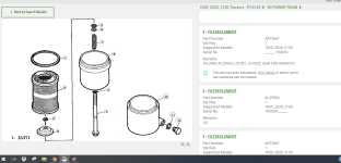

Hey Jim quick one, is there two types of transmission filters for a 2130? One for tractors with hi/lo and one for ones without? I got an AR75603?
/ John Deere 2140 #37
AR75603 fits most JD tractor models built from '61-'92 for sales in N America.
Tractors built for European sales can have different filter part #s which are AR75601 which subs to AL25554. My knowledge of these tractors is sketchy at best.
According to my JD parts cart AL25554 costs 2X what the AR75603

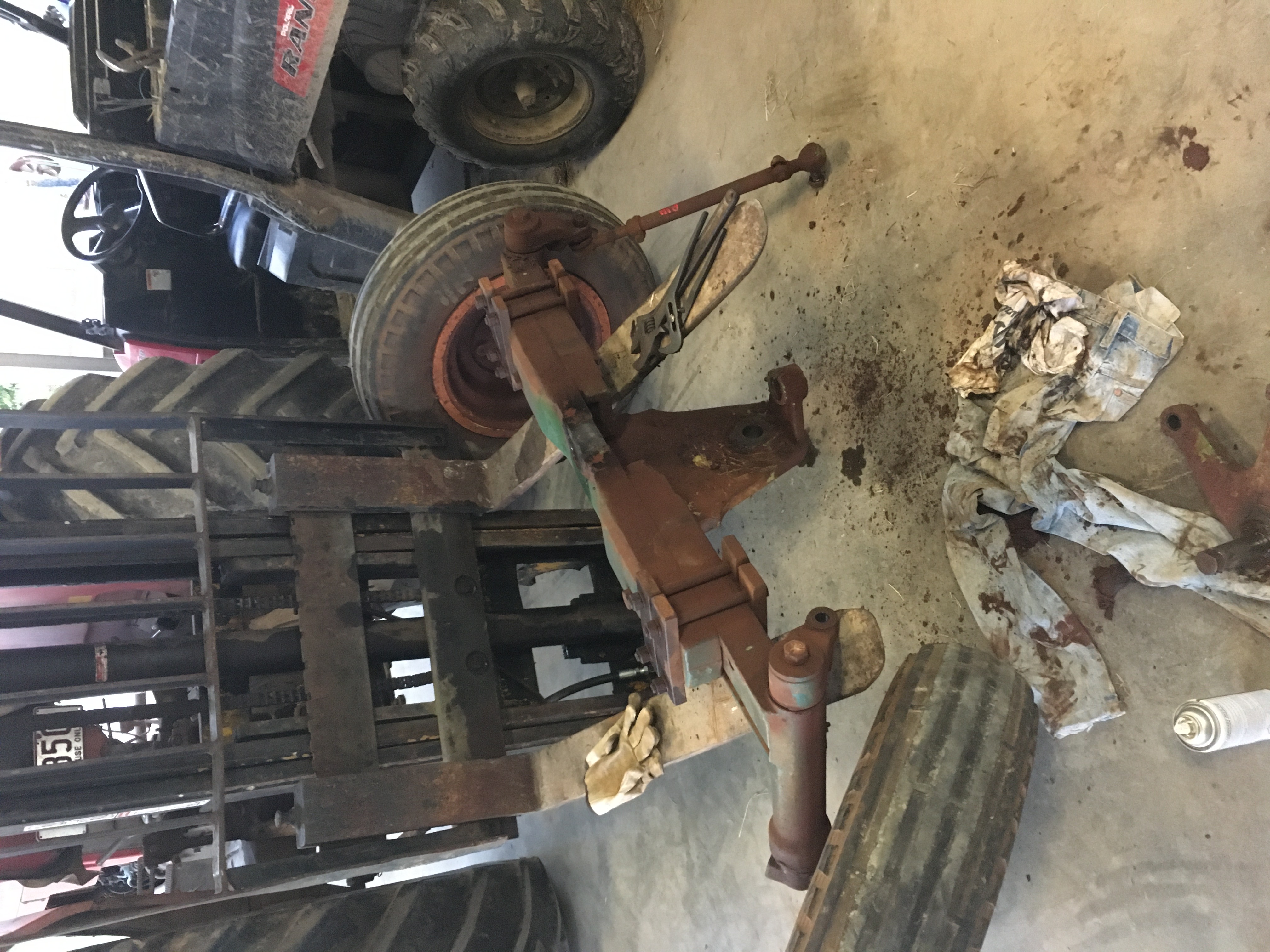

#38
Well we are back on four wheels after two weeks. Definitely a two person job. Took a lot longer with one. Jack up, forklift down, forklift up, jack down. Got there in the end. Had to buff out the new bush to fit the hollow pin, guess it shrunk pressing it in. All works though so tomorrow is the full fluid and filter change. Will check the screen when I have the trans empty. Not sure if this model has the filter bypass, can not see a plug where it should be. The sump plug for the trans is beside the filter housing but there is another plug on the bottom of the right side axle housing. Do I need to drain both plugs? Or is the axle one not a drain? Will get a pic tomorrow if anyone needs it. Cheers for the help with everything, hopefully I can repay the favour in years to come.

Which bushings did you have to buff? If the knee bushings, when I put mine in I ruined the first one, just hammering it in. Then I got smarter and put each on the spindle and used that as a driver to drive them in. So it took buying 5 to replace 4. Probably a repair mine did not need, I saw no difference.
