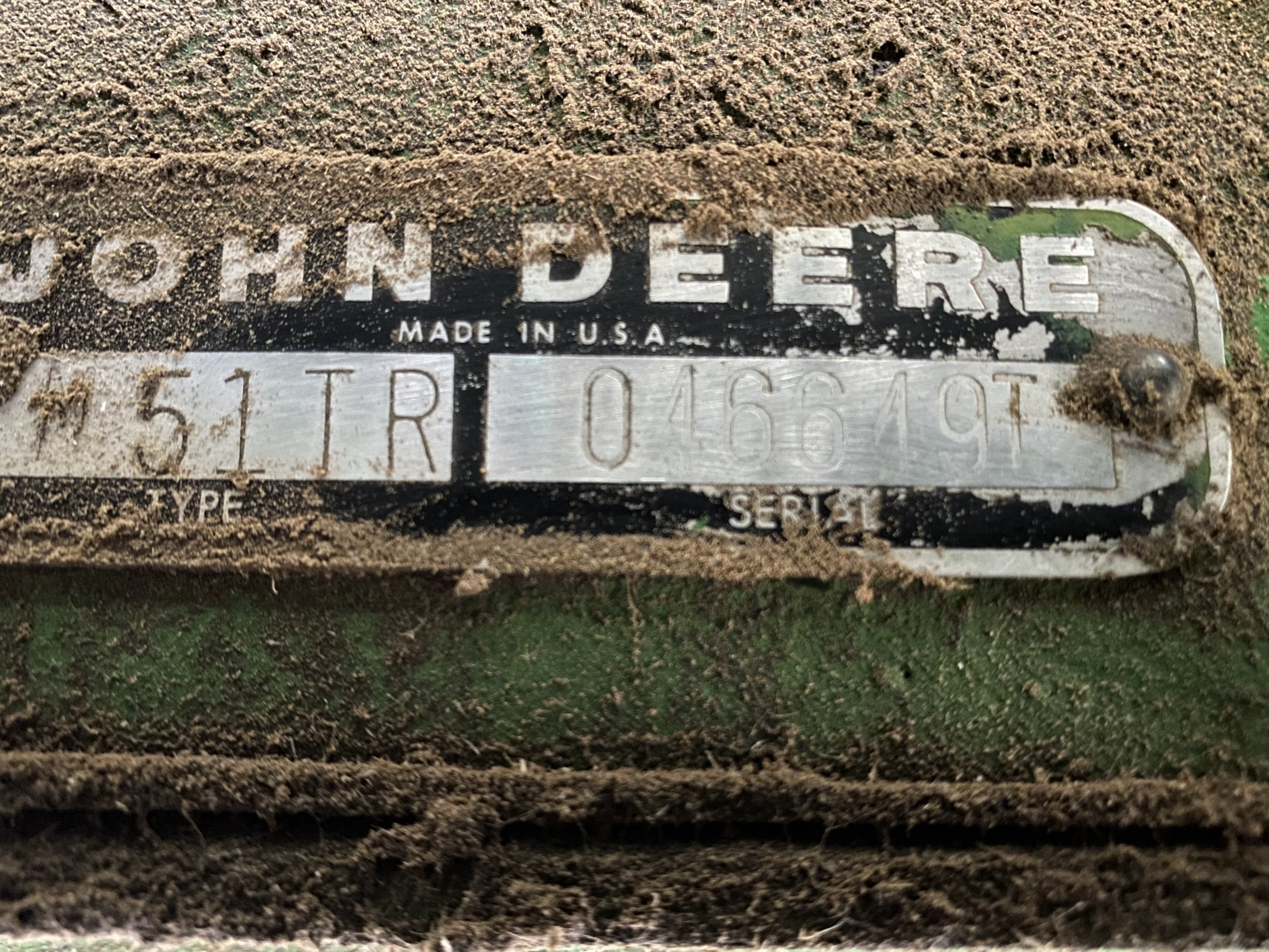

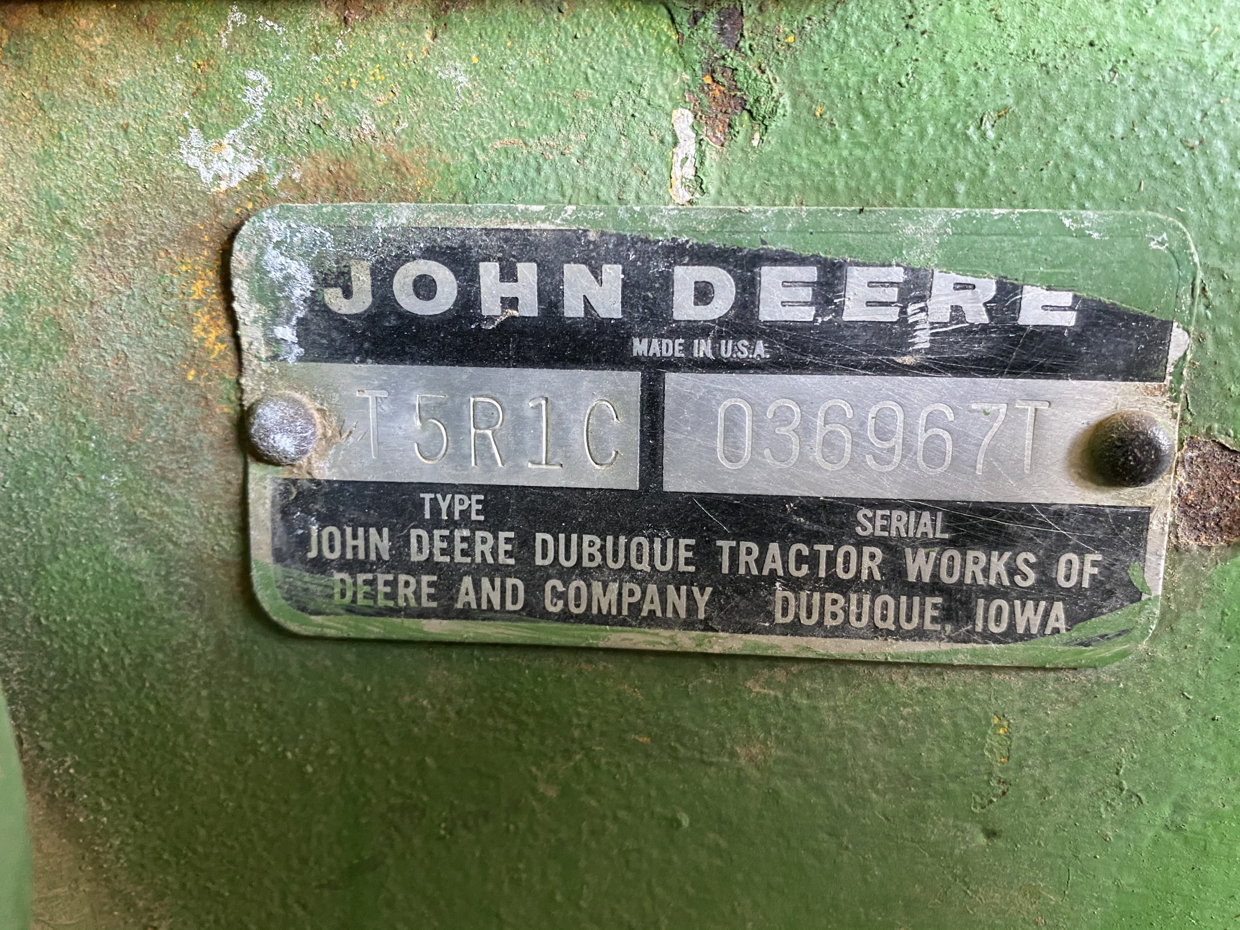

/ John Deere 2020 hydraulic issues #7
Power steering,scv,FEL valve or rockshaft are places for internal high pressure leaks.
I'll advise to cap power steering supply line if your tractors serial # is >045,199 & then test loader operation I've forgot if I asked on other forum is your tractors serial # is below or above 045,199

I had forgotten that your tractor had a hyd "T" fitting in RH side of trans case in lieu of a pressure control(priority) valve. Therefore if your tractor has power steering it will be open center not closed center PS which won't affect FEL hyd operation
