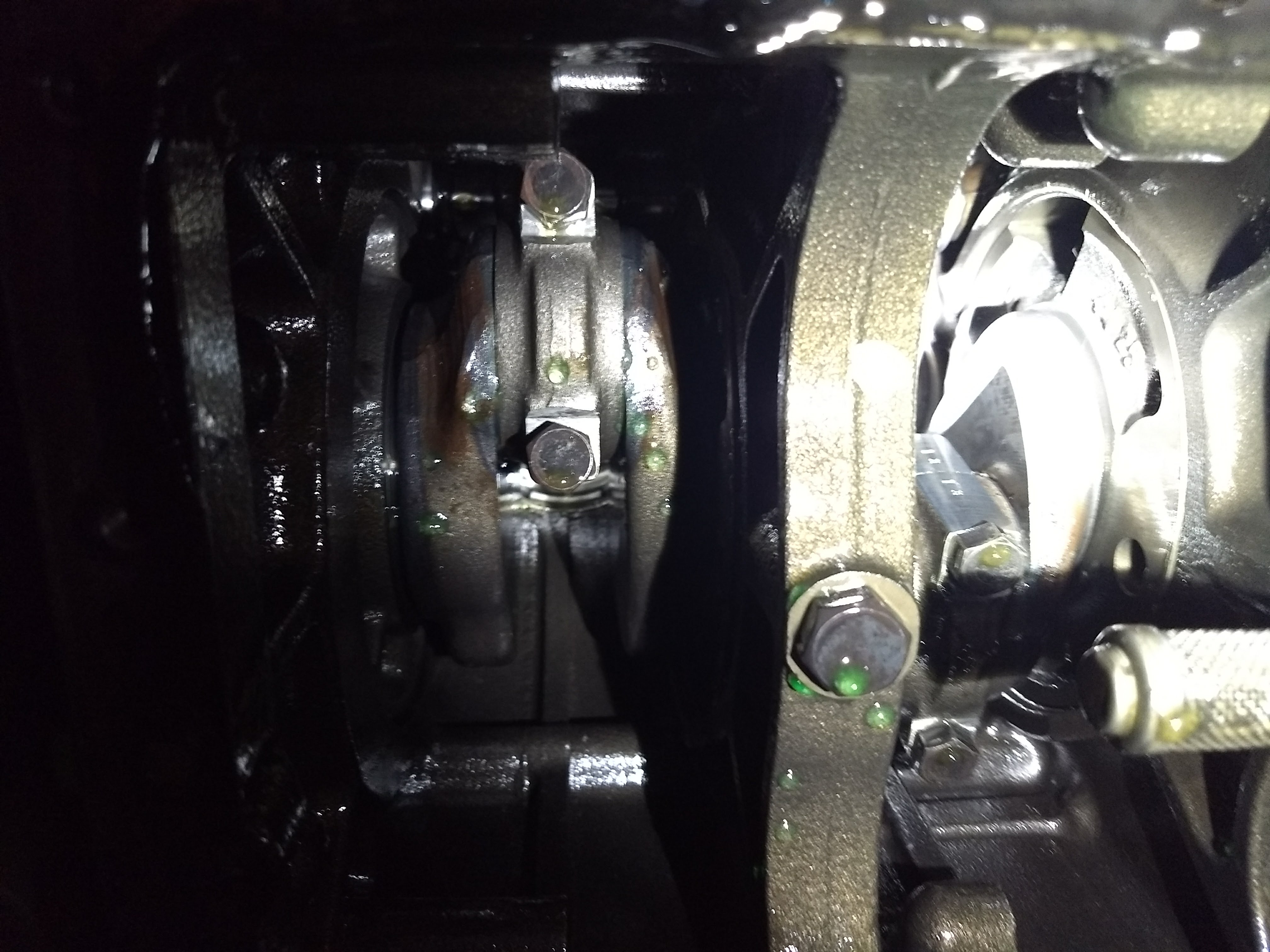

Okay, thanks... I'll use that method to clean the threaded holes in the block. I'm just waiting for the machine shop to get back to me about the head. They were just finishing the hot tanking on Friday and told me the magnaflux would be done by Wednesday of next week.
I plan on measuring the rod bearings with plastigage and pulling the sleeves/pistons/rods next weekend. We've had lots of rain here this past week and this weekend so it makes progress hard.

Today I was able to measure the bearing-to-journal oil clearance with plastigage for all three rod bearings. They all measured within 0.003 in which is within the JD 1050 spec for new parts (0.0016 to 0.0035 in). The wear tolerance is 0.005 in. Bearings looked good with minimal scuffing.
I was also able to pull the first piston and sleeve. The sleeve actually looks pretty good with minimal pitting. I'll have to measure the bore to see if it is within specs. The piston and rings look good too. The sleeve o-rings were toast but I'm guessing by pulling the sleeve, they would get somewhat destroyed in the process. The sleeve o-rings looked like every other o-ring and gasket on this tractor that I've replaced since I bought the tractor... baked, dry and cracked.

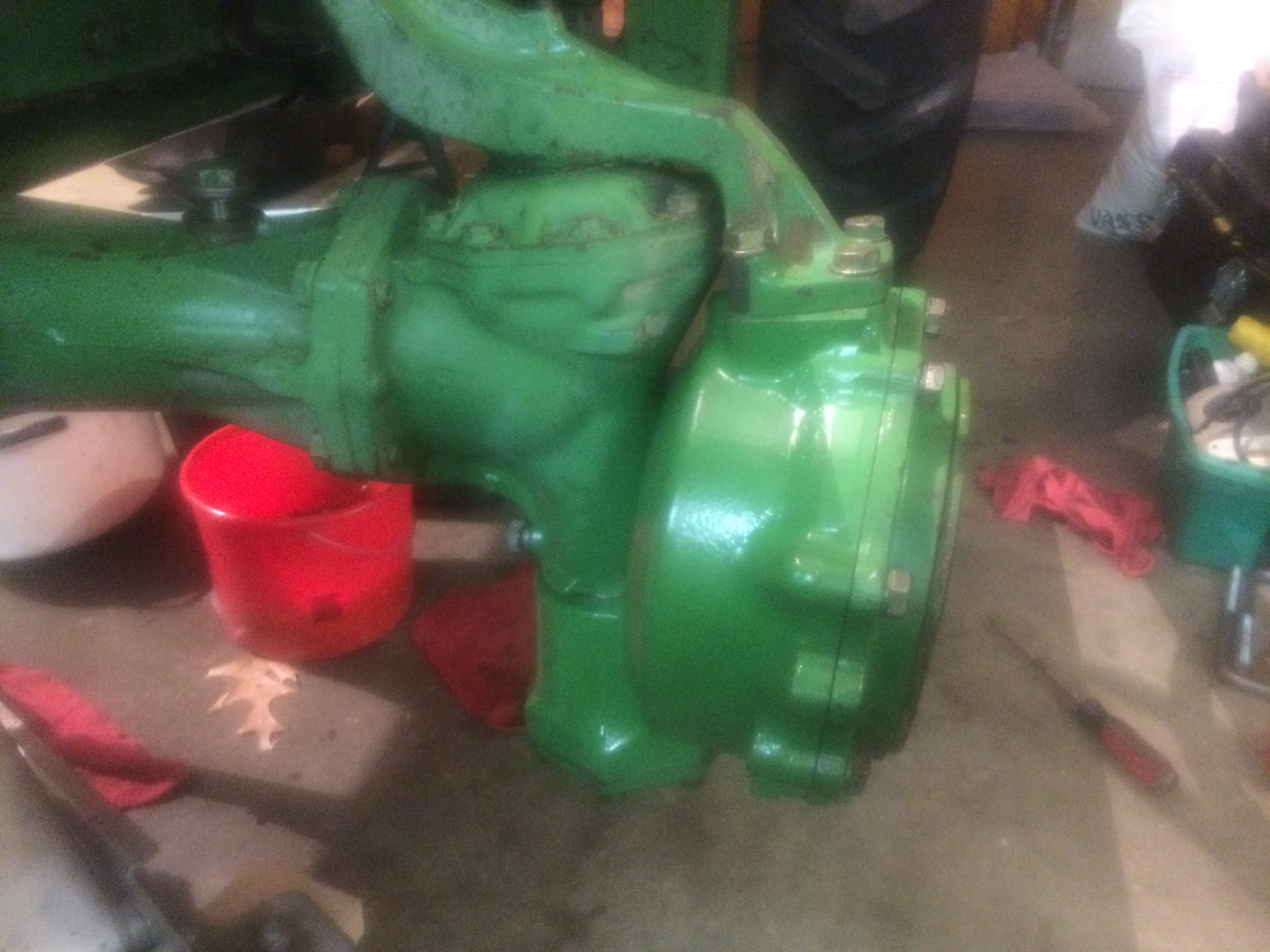

My front hubs (MFWD) were leaking like a spaghetti strainer. I've been working the last few nights to reseal. It's amazing to me that the gears look new after all these years and 2,800 hours. These are tough old tractors and well worth the effort it takes to maintain them.

I have to reseal the front hubs and axle on my MFWD as well. I've been putting it off until the engine was sorted out but I know that is next in addition to re-sealing the Selective Control Valve for the rear hydraulic remotes.

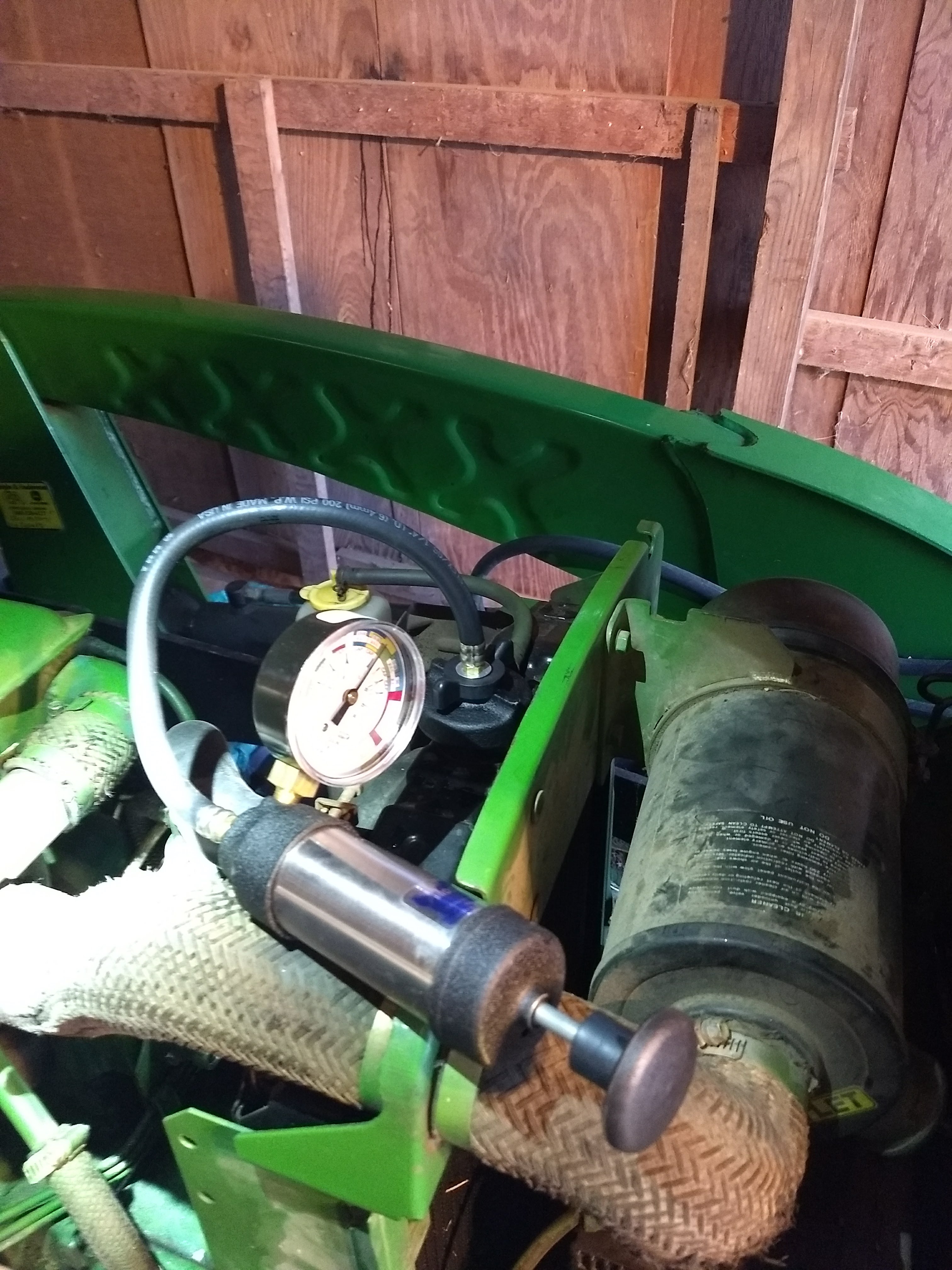

Have you thought about about having your radiator boiled and serviced? Seems like going thru the water system would be cheap insurance for that new head. I did this on both my tractor's and spent about $100.00 per radiator. Just a thought.
/ John Deere 1050 Engine Opinion
#35
I would but I recently bought a new radiator for the tractor when I was troubleshooting pressure loss in the radiator. The original radiator was pretty rough and was leaking at several places in the core. I thought about having the original radiator re-cored but I ended up buying an aftermarket one. I also bought new coolant hoses and thermostat...

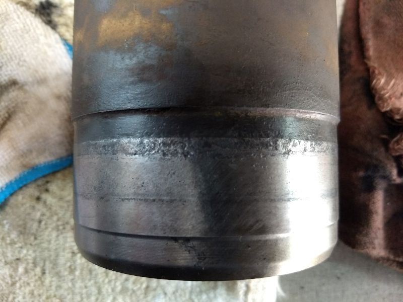

Hey Timberhole, I cleaned up one of the sleeves today and see some pitting down around where the o-rings would sit. Question is whether the pitting is bad enough not to reuse the sleeve. I guess it could come down to a choice as I the sleeve bore doesn't look to bad and measurements indicate it is still within spec...
Would you reuse it?
/ John Deere 1050 Engine Opinion #37
That's the very same pitting I saw on mine. The worst pitting is above the top oring. The witness mark for the lower seal is clear in the pic and the surface doesn't show any pitting at that location. I'm guessing the lower seal will seal perfectly and the top seal might seap a little.
Would I use the sleeves? Yes, if they mic good.
I would consider putting a little stop leak in the radiator. It won't hurt anything and would help seal any minor imperfections at the top seal. Either way I think the sleeve will seal. Obviously you can't go wrong buying new sleeves but they are expensive and these in frame repairs are not really full overhauls. Have to draw the line somewhere. That's my $.02.

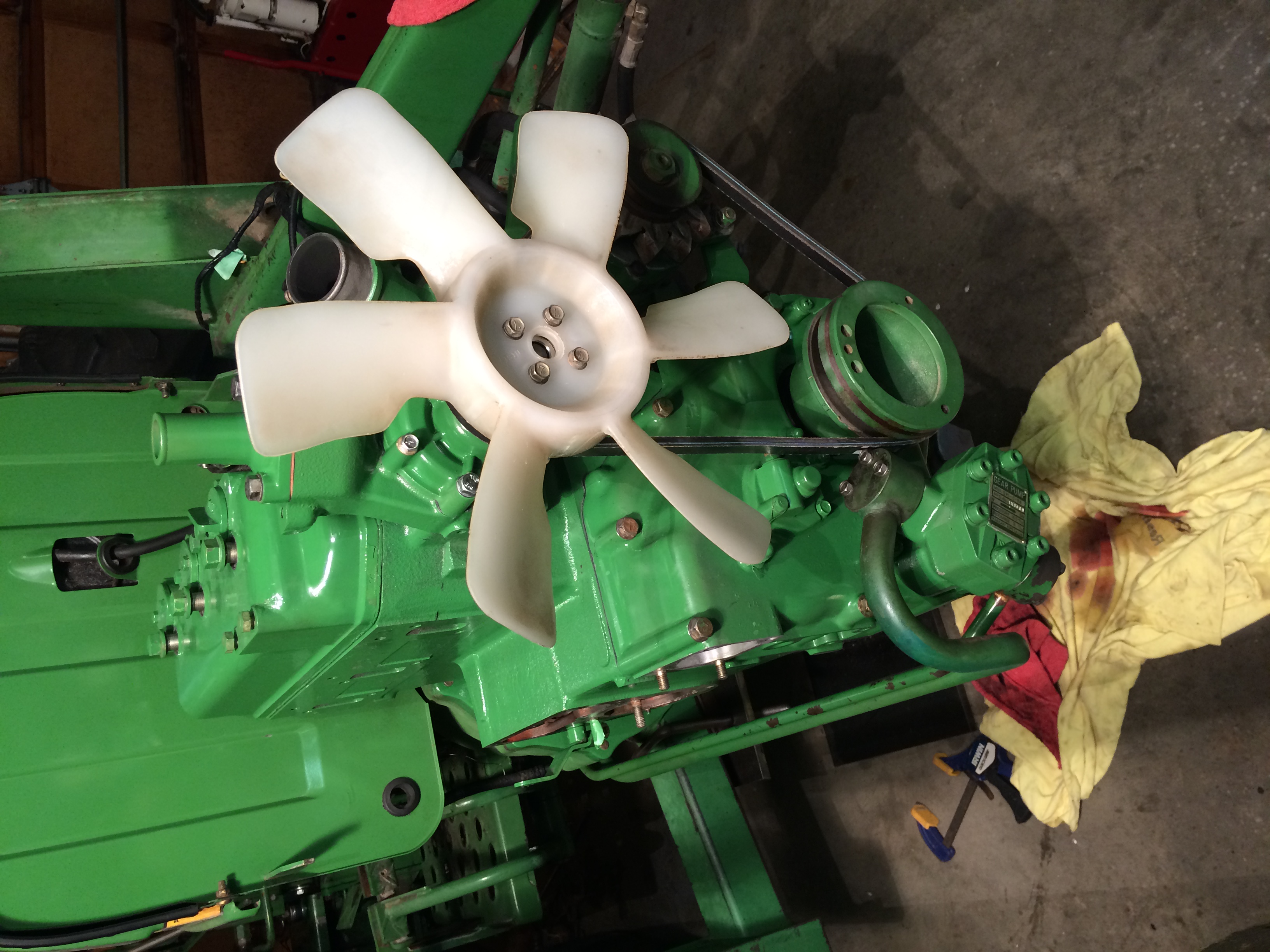

Just wanted to update this thread and thank TimberHole for all of his advice. My Dad and I spent last week (~6 days of work and 10 hour days) rebuilding the engine in the JD1050. At certain times, we weren't sure if the thing would go back together and we made one major screw up that we were able to fix relatively fast. But I can say now that the tractor runs and purrs like a kitten. Everything seems great...
We started the first few days by pulling the other two sleeves / pistons and cleaning them up. There was some scuffing on the pistons but nothing too major. The oil control rings on all three pistons broke when they came out though. We thought this was a result of an overheating event or water in the oil in the past.
After spending a lot of time cleaning and preparing all of the new parts, we got everything back together Friday night down to the last bolt tightened and started to fill the radiator with water. Well, we heard lots of water dripping and it was coming from the head gasket area. We were completely devastated. These JD1050 tractors have two head gaskets depending on a serial number break and I had called a JD dealer with my S/N and was told to order the early head gasket based on my S/N. When we put it on, we noticed that the fire rings on the head gasket laid on top of the raised edge of the sleeve that sits above the block surface and not around it. We figured that this was the problem and fortunately, I had the later S/N head gasket in stock that I had previously ordered thinking it was the right one.
Well, after dinner on Friday night, we pulled the head again and replaced the head gasket with the correct one. It was a marathon but I think we pulled the head and got it back together in less than two hours which is pretty good, in my humble opinion.
It wasn't until Sunday that we were able to fire her up but after bleeding the fuel lines, she fired right up and ran beautifully. Hardly any smoke at all! I'm running JD break-in oil in her and the proper JD Cool-Guard II coolant now. I'm hoping for years more service from this tractor.
