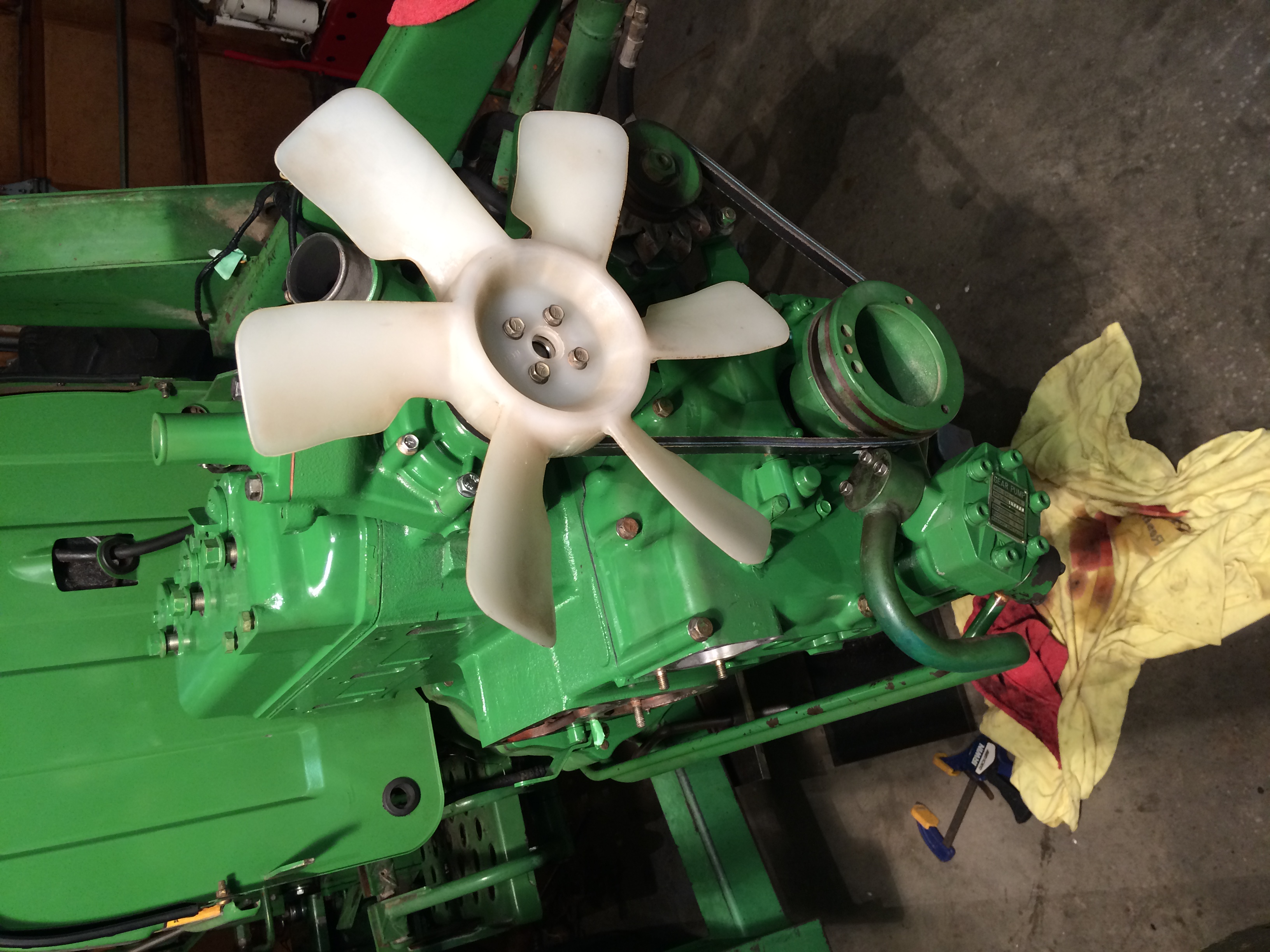

Here's a pic of the second machine getting close to done.
Not to derail your thread but do you have a backhoe on your machine?
