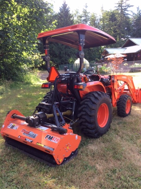

Sorry to just be getting back, had a gun repair for the neighbor to take care of. - My Sons are master mechanics on diesel and all else, when they say the Briggs motor is toast I accept that, cracked block. We have discussed another motor so that will happen at some point perhaps if they want to fix it up. Meanwhile, I am ready for new after 18-19 years. I talked to local JD guys and they had high praise for this Scott mower saying, the transaxle hydro is a good one being a model #51 in it's day and about equal to the X370 JD of today. For the space being mowed, they recommend the X390 at 22hp, power steering, and having a transaxle drain plug and being a mower they seldom see come in with issues. My place is flat, no hills and collectively for all areas about 1.5 acres. All else gets the flail and brush hog. Not married to any brand, we have JD, Kubota and many off brands here locally but I prefer known products with good dealer support. Our JD dealer sold my Dad his new model 70 back in the day then a new 4020 and 1020 so we know this dealer family well. my brother bought his 5320 there so we have family history. Our Kubota U35 has been bullet proof IMO plus the L2501 is a great tractor for us old timers who need them, easy on and off and very comfortable! I'd like a BX2380 with mid mount mower but hard to justify at this stage. With luck I'll be mowing 5-10 years before watching my Sons do it all.
