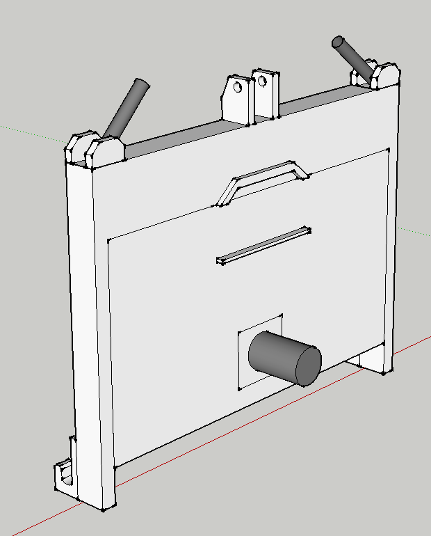

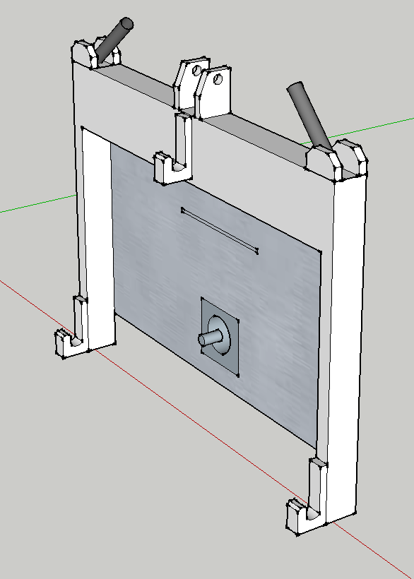

Maybe something similar to this?

Martt. I have looked into something like this, but I am not sure it will work in our application. First is that the quck atach gets in the way of the motor, the other part is that these type quick attaches keep the device too close, making odd angle PTO shaft lines. Either you have to back up a ways or direct connect.
If you look at the net, the ones I see for bobcat keep the implement far away.
I think you are looking at the QA from Harbor Freight to save a few bucks? Maybe we can make extending ears.
One other thing, I think you have to make the QA plate angled to accomodate PT's weird angle.
But we should keep looking on this. Has to be a cheap yet effective way to do this.
