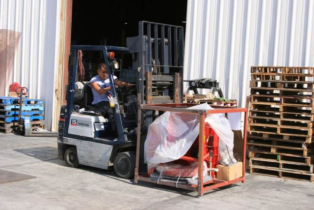

This thread has been rather quiet for the past month. I just bought a Jinma
chipper on ebay through Globe inc. I am going to LA tomorrow to pick it up. I'll keep you posted on how things progress, and thanks in advance for the helpful inputs.
/ Jinma chippers #157
Well, got the chipper home in my Dakota pickup. It fit with a few inches to spare but it sure did make the truck squat down. 350 miles later at home it took all three tractors to unload it. the Kubota on one side, Yanmar on the other and the Deere grader blade resting on the 3PH of the Yanmar for ballast. We were able to lift it up just enough to clear the bed of the truck, then I drove the truck out from under it. It took the wife & I about 5 hours to assemble it, could have been less if there were any coherent assembly instructions. The assembly manual, as previously noted, contains mostly safety notices.
Now the problem. . . . the power input shaft is about 4 inches higher than the pto shaft on the tractor. Looks like the only thing to do is to torch 4 inches off the base of the chipper.
Does anybody have any other ideas?
I would save the original heavy sheet metal base pieces and build me a new one out of angle iron and treated wood [skids, couple pieces of old RR timbers or something like that]. You could make it longer than the original [extend it under the chute some]so it would keep the unit from tipping. There is no problem making it lower, as long as you keep the pully/belt assembly up off the ground. Lower would also make it a little easier feeding the bigger pieces. :) Good luck ! , Jerry
PS: I just used mine to chip the tops of three trees last week. It works pretty good and chunk/chunk/chunk/chunks stuff up pretty fast. But nothing like a commercial drum chipper, where you throw a big limb in and 'eeeeeeaaaaannnnt', it's gone. Fast enough for us old retired guys... :)
