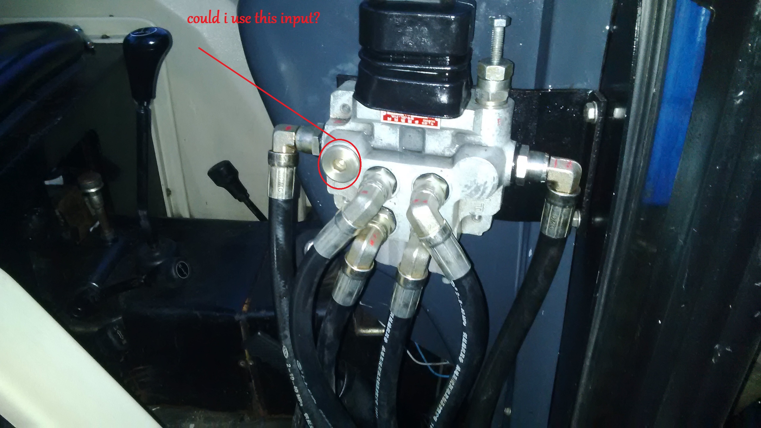

   / Jinma 254 current owner with Y385 engine help questions #38
Yes, 2,000 psi is about right. Am attaching picture or pressure gauge situated right on the FEL upright, by the loader control valve - where you can see what is happening.
#39
That is good Doxford, did you have a spare hole in the valve or you drilled one and tap after?
#40
Spool Valve.jpgI notice I do have possibly spare input on my valve....
