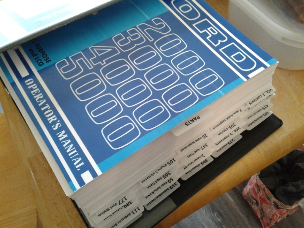

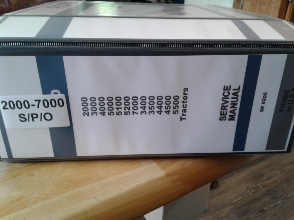

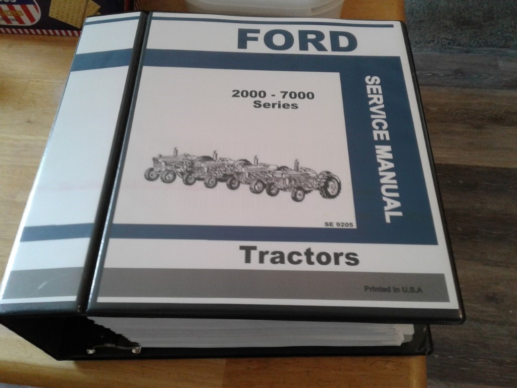

Yours is even older than mine!
Here is hopefully what you are getting if they haven't changed them.
I got all my info from members here, on YesterdaysTractors.com and Steiner tractor Parts catalogs and of coarse books on Ford tractors.

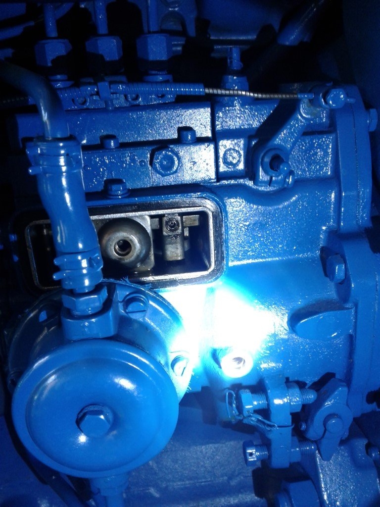

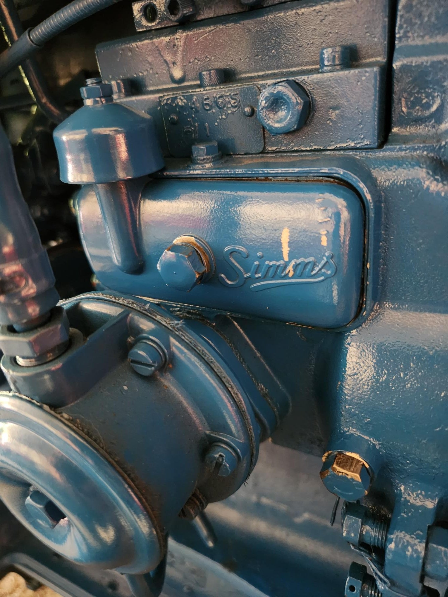

Here is a pic of the fuel pump where the engine oil goes. I had the cover off to clean the breather (it was clean) and the gasket was leaking a bit.
It's got a filler, a drain and a check plug. You just fill until it comes out check plug.

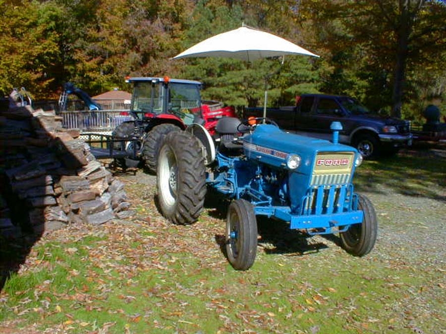

Yes headlights should be in lower grill. Aftermarket grills are still available from many places but I keep reading that they don't fit perfectly?
   / New owner of tractor (diesel engine question) #47
So you're saying my headlights are supposed to be in the lower grill? Where do I get all of these information details? Will this all be in the 4 manuals Paystar told me to order? ( I think they will be here in a few days).
This is my '73 3000 for comparison.
