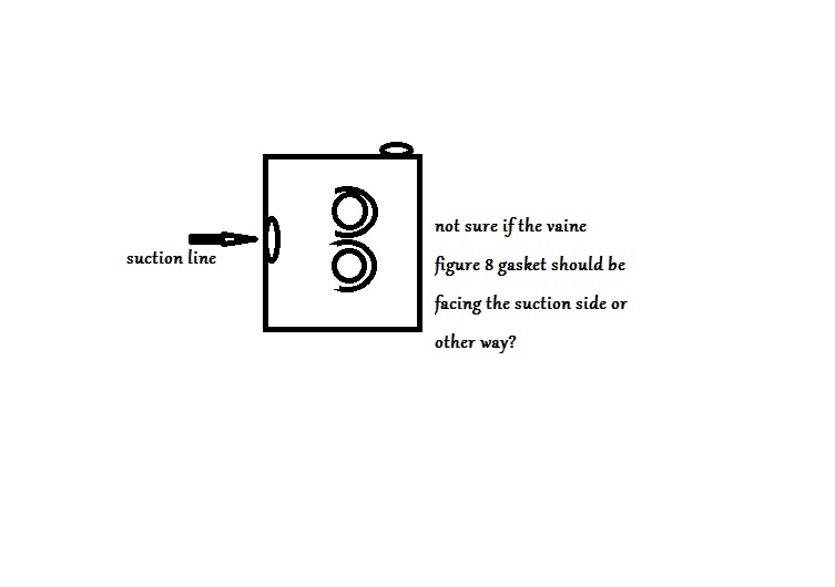

Okay no such luck on the numbers bands on mine... the casing looks perfect not cracks. yes I change the hyd filter, because the first few times i took the pump apart im not sure if I have the figure 8 gasket housing facing the right way in the casing I've been looking on line to see if I could find a good picture of that specific pump see pic i made Untitled.jpg

also when you reasemmble pump,do not over tighten the 4 bolts,you should be able to turn shaft with just a little force,trust me on this,you will think it will leak but it won't
I know what you are talking about the fig 8 or 3 gaskets,to best of my memory **** on gasket go inward,not 100 percent on that
