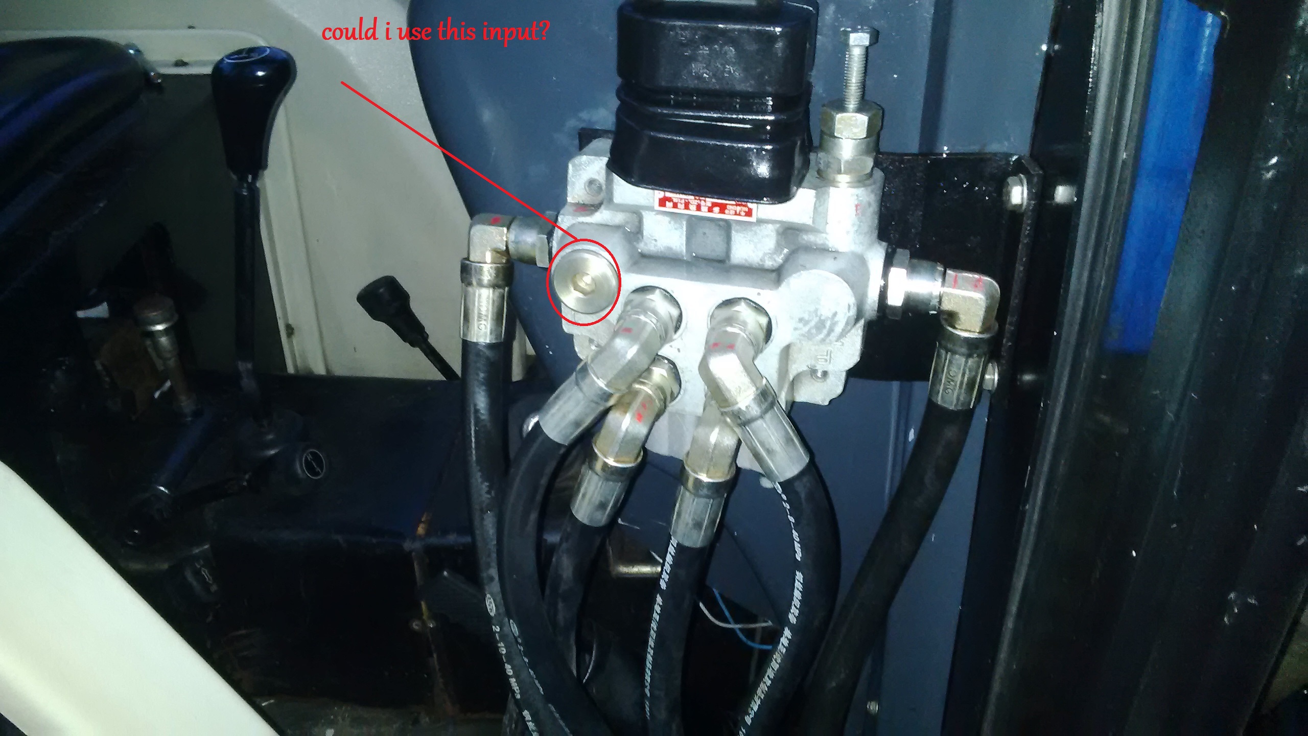

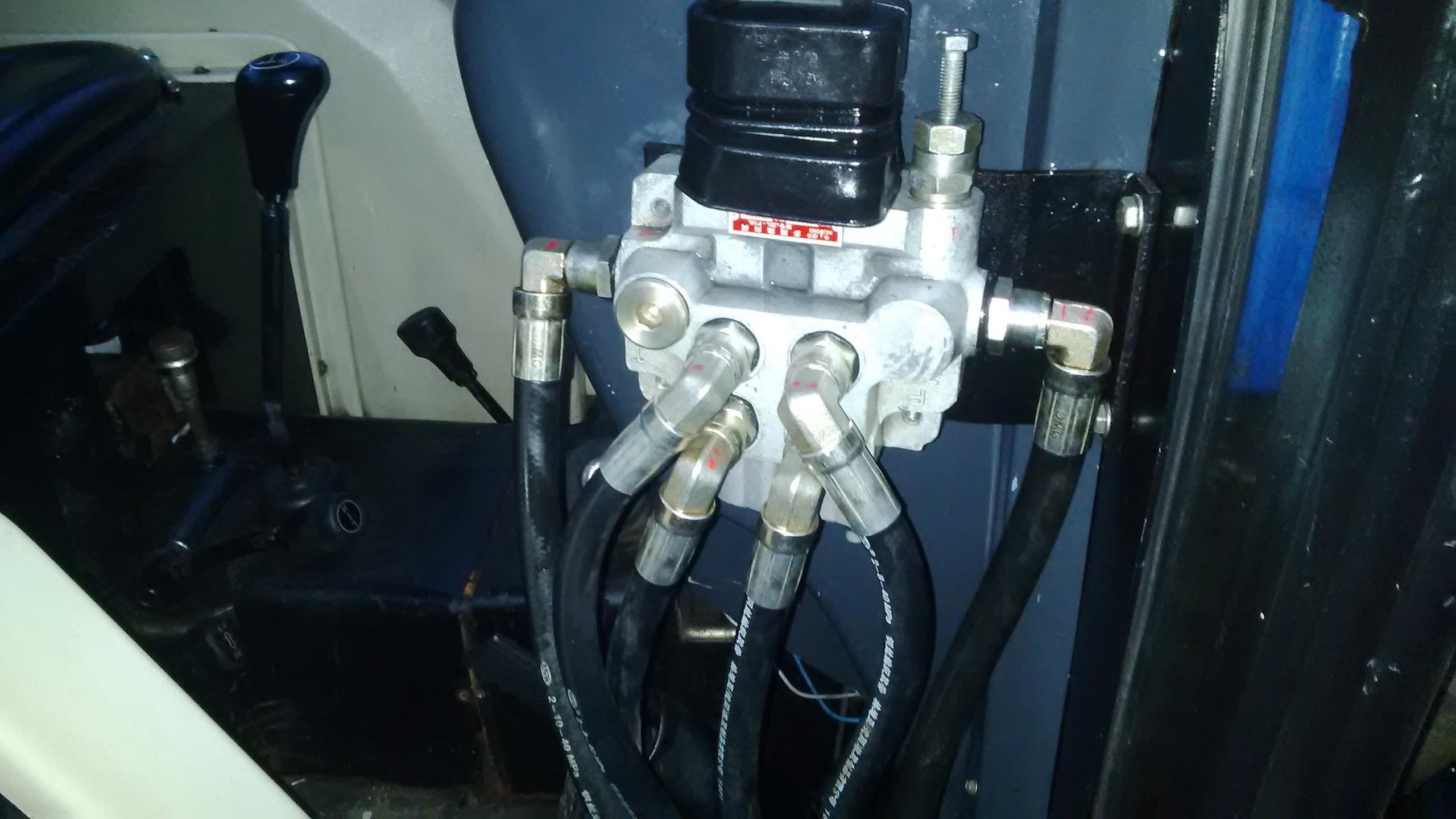

I am not sure what that plug is for - maybe it is for power beyond to use with another piece of equipment. If it is, it might work, but you would need to add reducing bushings.
I drilled and tapped into mine to get the pressure gauge installed. I had a spare valve block that I modified and it works just fine.
Maybe someone else who is more "hydraulic savvy" could chime in and comment. I have found out by making mistakes and it gets to be expensive. With a bit of luck J.J. or someone else will help.
   / Jinma 254 current owner with Y385 engine help questions #42
You can tee in for a gauge. Normally on a hydraulic system you can't tee, the flow has to have a single path, but since there is no flow through the gauge it's OK. You can't use regular plumbing fittings, you have to use hydraulic fittings, plumbing can't take 2000 PSI.
What I would do is get a pair of quick-attach couplings and a tee. When you need a pressure reading disconnect the input to the FEL and put the gauge inline. Take it out when you don't need it.

Good evening quicksand, I will want to end up with a visible hydraulic gauge permanently and yes will get all hyd rate to 2200 psi, right now im trying to figure out if I could use what seem to be a spare in out put on my spool valve see picture Spool Valve.jpg
   / Jinma 254 current owner with Y385 engine help questions #44
Good evening quicksand, I will want to end up with a visible hydraulic gauge permanently and yes will get all hyd rate to 2200 psi, right now im trying to figure out if I could use what seem to be a spare in out put on my spool valve see picture View attachment 424487
It's not a spare in or out port, it's a power beyond port. If you want to put a gauge in permanently take off the input hose and put a tee between it and the valve. You need to be upstream of the valve to get an accurate reading.

Okay that's what I will do thank you very much for the help. now I wonder if there is some hydraulic blue print / schematic on line for the jinma 254 layout of all the plumbing this sure would be handy to have to really understand all lines location and functions except the attachments such as loader

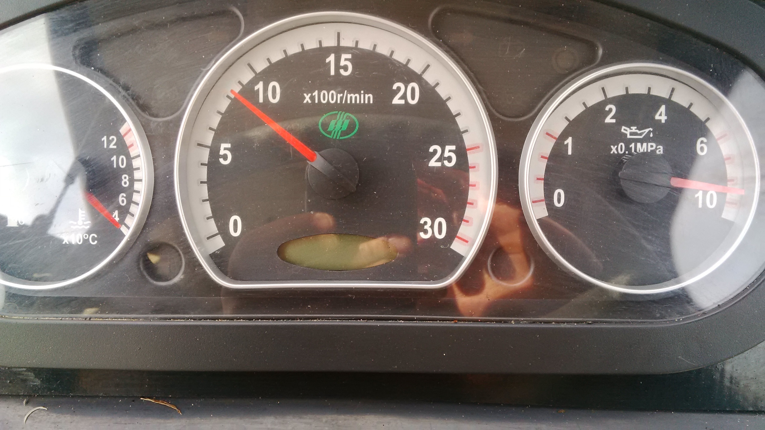

Question 2. I have is the oil pressure sender sensor has 2 connections and only a purple wire is connected to the sender and my oil pressure gauge is reading high almost to 10 and when I disconnect the purple wire the gauge still stays to 10, the only time the gauge goes back to zero is when I shut off the engine any chance one of you current owner could take a picture of the color wires going to the sender?
Hi my fellow acadian :) After reading how your oil pressure gauge is reacting I believe your oil pressure wire is on the wrong terminal. Please refer to the explaination of the oil pressure sensor.
the sensor is a dual function unit, one terminal to ground provides a path to drive the low oil pressure idiot light, so it is a short circuit measured to ground with engine off/low oil pressure(light on), and an open with engine running and normal oil pressure(light off)
The other terminal drives the oil pressure gauge. This terminal to ground is about 10 ohms with engine off/low oil pressure and 80 ohms to ground with engine idling.

Good day Dotcom, I figured out the problem, one bad sender and 2 the new sender when it stamp G does not = Ground :) so all is good thank you for your comments
