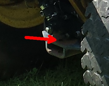

Can anyone advise me how a drawbar is connected to the slot beneath the transaxle on this machine. I use a towball on a towing A frame on the 3 point hitch, but now require a towing setup that has a lower centre of gravity and releases the 3 point hitch for other uses.

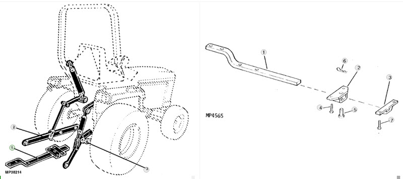

Does this help?

Very helpful, thank you.

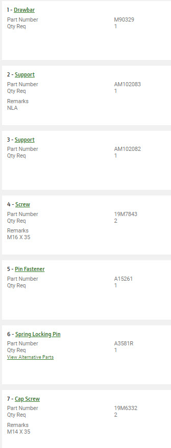

Do you have a key to explain the numbered parts?

You can go to the JD parts, put in model 855 and all the parts schematics are available.
John Deere Parts Catalog
Hope that helps.
What part(s) are you missing?

Thanks for the replies. I have lots of information there to fuel my research. I need to examine the underside of the transaxle to see exactly what is currently in place so that I can figure out what I need to get.
/ JD855 Drawbar #8
All you have to do is stick the drawbar in and line up the holes then put a pin in it.
I was too cheap to buy a drawbar and I couldn't find any 1" bar stock local so I bought two 30" long pieces of 1/2"x2" flat bar. I welded them together and bored the holes with a bi metal hole saw.
