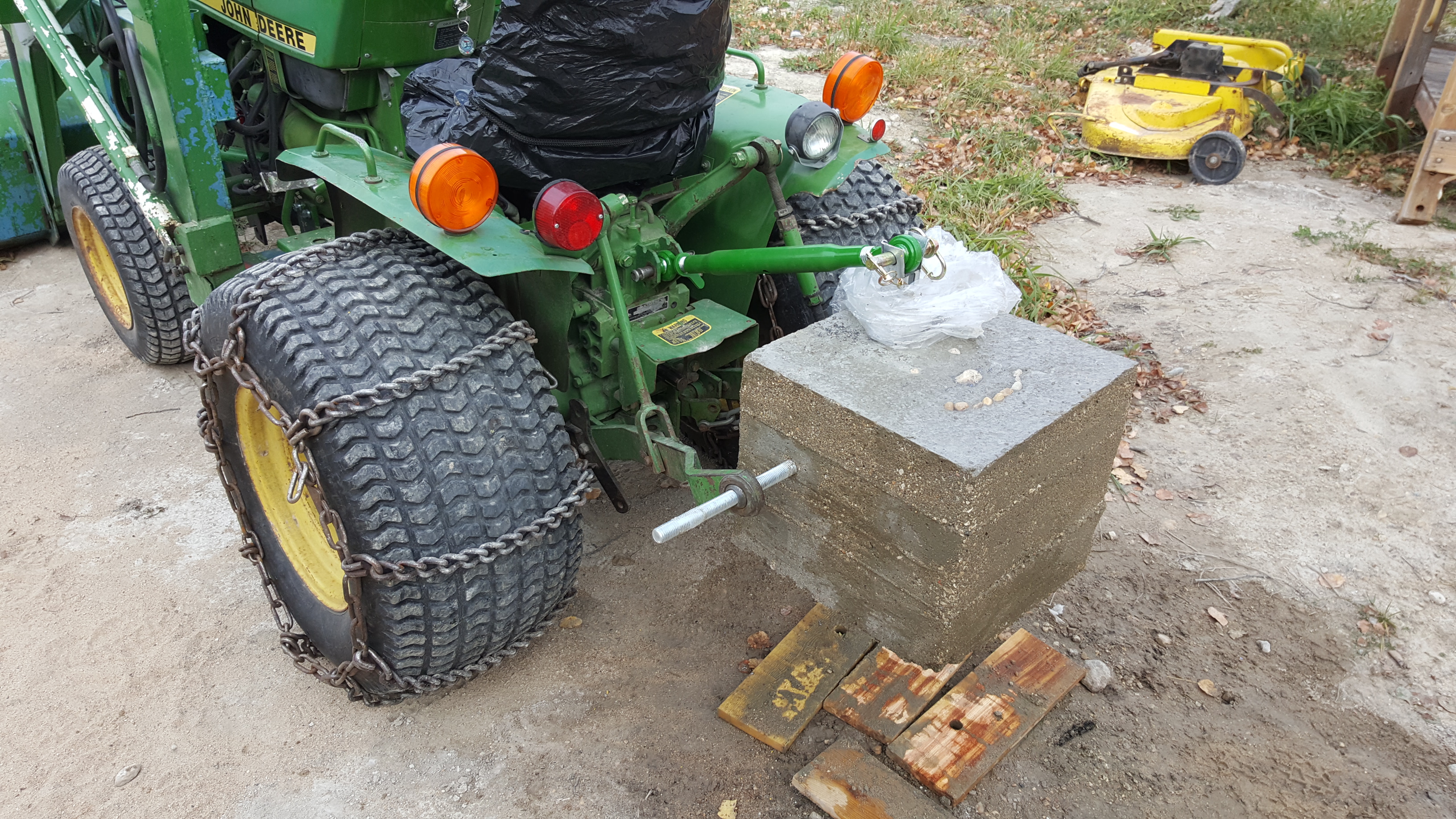

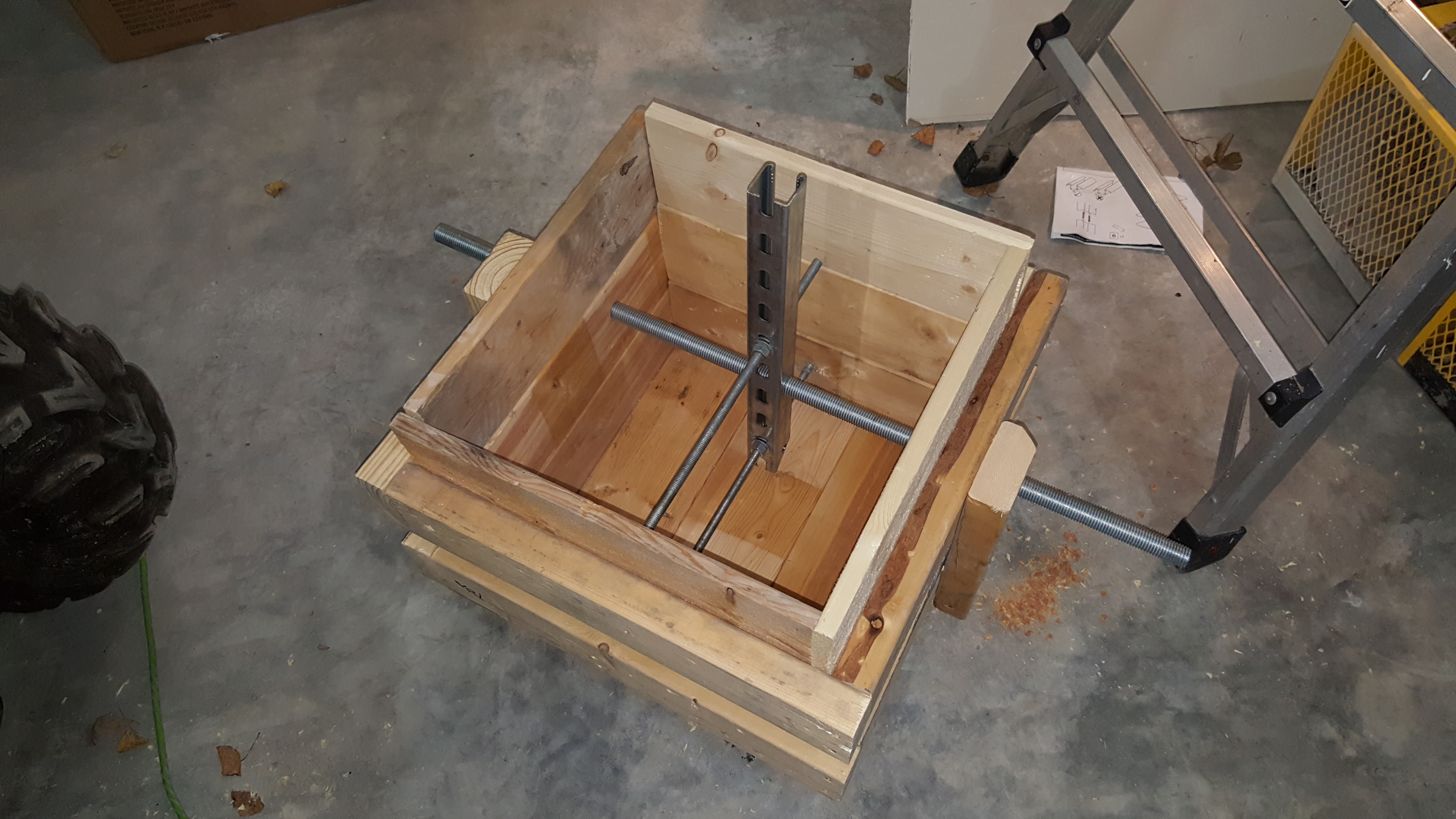

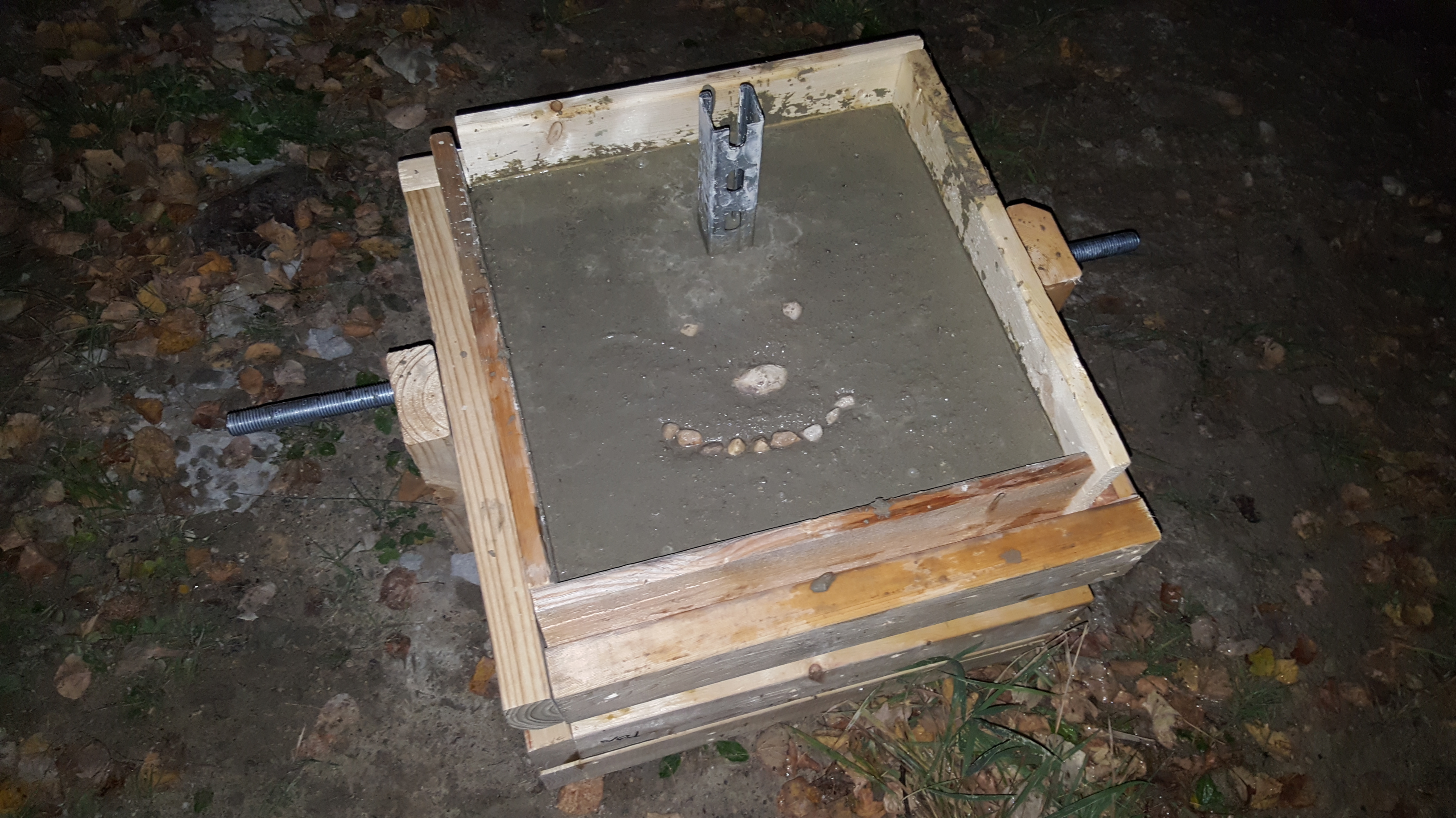

Excellent way to put a bit of weight on those rear tires. Under $30 (CND). Used about 10 baseball size rocks from around the yard as filler.
