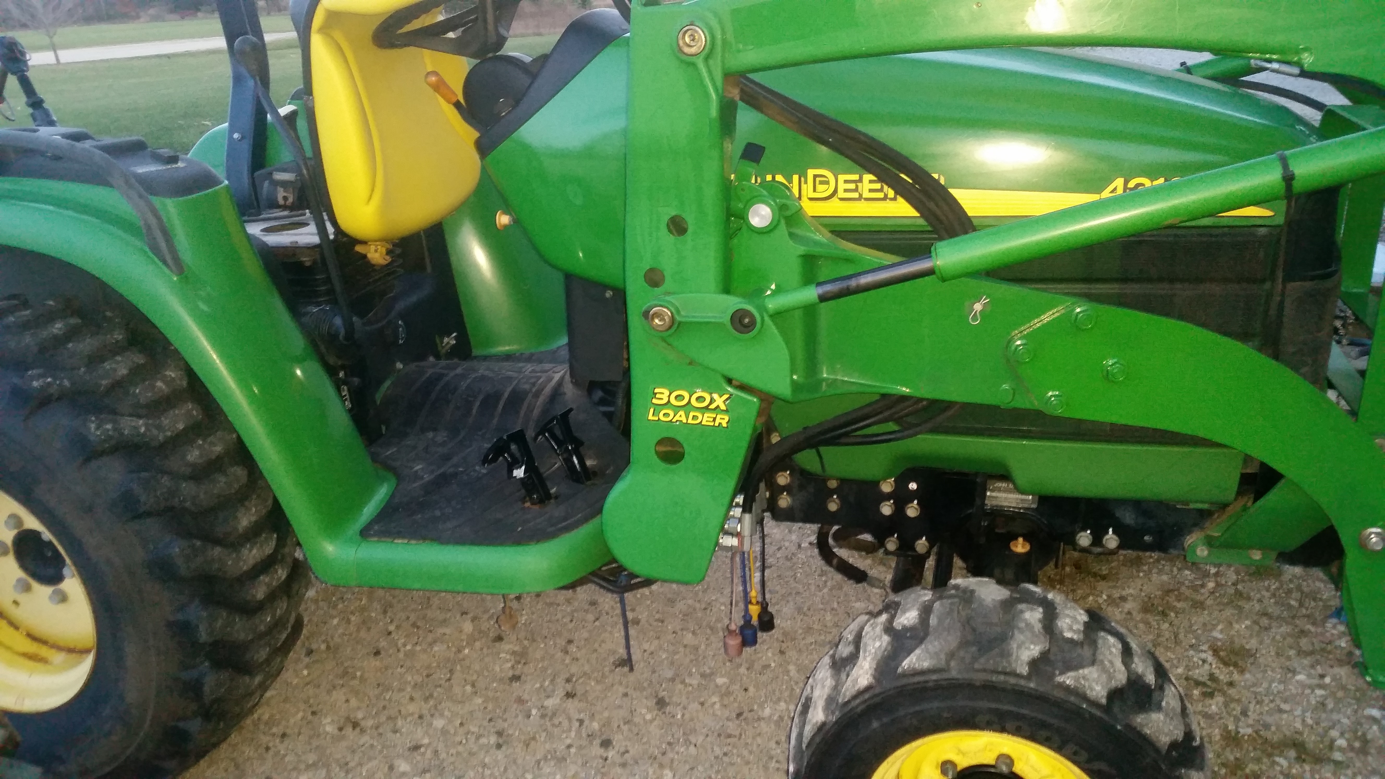

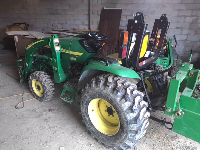

Are those hoses on a check valve or is there a valve you need to close to reroute them?
If you compare the 2 pictures, mine has a gold pin and hairpin clip on the loader frame just below the cylinder. That holds a plastic clip (on the inside of the frame) for a large heavy duty zip tie to hold the lines tight against the frame. Your picture shows the empty hole in the frame. Cheap fix, but you can reroute the hoses and het the clip and pin. You need the clip to keep the hoses pulled tight and secured.
/ Jd4310 ehydro
#22
AHH that explains it. Thanks!
They connect with a quick disconnect but it looks like they are just tied on the wrong side of the upright. I imagine you can just cut the tie and reroute them without having to do anything else.
