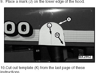

Further investigation finds the instructions for the kit, and they do include modifying the hood/side panel.
/forums/images/graemlins/cool.gif

I've seen the instruction sheet for these, a template is included for cutting the required notch in the panel.
   / JD Exhaust #14
I would think that a pair of shears and a little judicious cutting would solve the panel opening. Just be careful and you could make it look like the original. If you want the dimensions of the opening in the panel I would be happy to measure mine and send you a private message or you could email me.

The inside of the 4310 hood already has a couple of vertical molded in ribs for renforcement where the slot will be cut in addition to a relief in the left side panel to allow for clearance.
