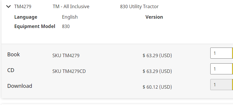

I couldn't locate a 820 utility tractor JD tech manual. My next choice would be the next newer model 830 utility tractor TM
