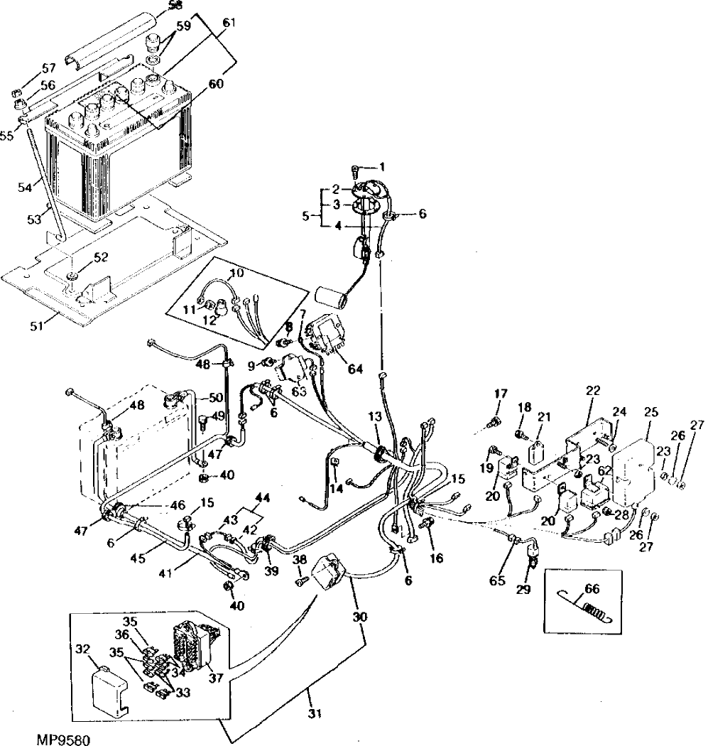

Not yet. Between a sick wife and 12 hour night shifts, I have pretty much left it alone. Here is what I do know, battery, links, fuses and main cables are fine but it sure is acting like a ground issue as I have zero power beyond the main infeed to the starter. I have tried every combination of +/- with the multimeter I can think of to find the break to no avail. I am having a hard time getting to the ignition switch as I need to drill out some screws on the side panel. Which terminal is the constant and which is the "on" (not start)? I would like to jump them out to see if it could be that. My schematics leave a little to be desired. Thanks as always guys.

Well, found it by accident this morning. I was reinstalling the ignition switch after finding no constant power there and the ground ring sparked. Hmm...there is power at the dash. All is fine now. All I can assume is that the ground ring lost connection though there did not appear to be major corrosion on it. Thanks for all the help guys.
