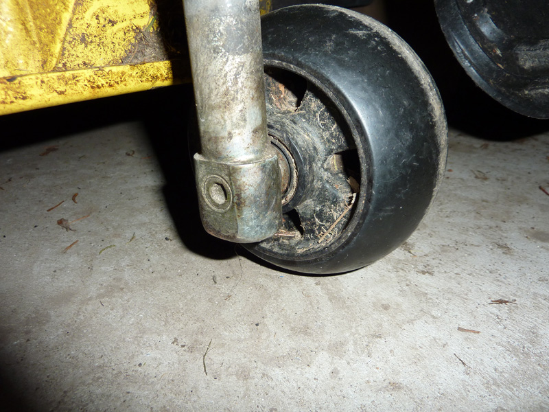

I'm replacing the gauge wheels on my JD 54C deck. I purchased the new wheels (AM125172), which come with replacement bushings. But I can't see how to remove the existing bushings (which are badly worn) from the axle bolt.
I'm guessing there's something obvious I'm not seeing. Suggestions?

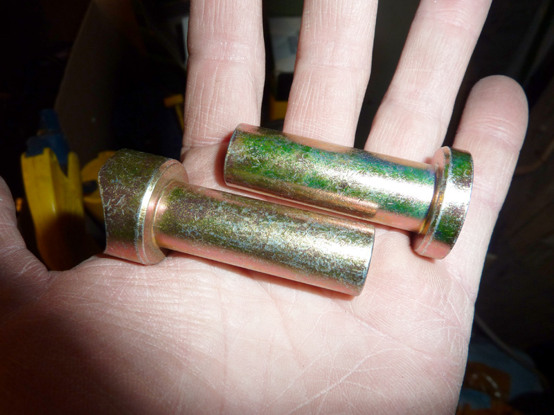

The existing bushing is badly worn on the bottom, where I'm pointing in the first attachment.
The new gauge wheels came with new bushings (see 2nd attachment), and I'd like to use them instead. But I can't figure out how to get the old bushing off of the threaded bolt that you see in first attachment.
Ideas?

Have you tried a hammer? Just tap on it and it should pop loose.
A pipe wrench to turn it some will likely work too.
Use the bushing that matches the old one.
/ JD 54C Deck--wheel bushing #5
Got some bad news. Your deck is the newer version that does not use the replaceable spindles. My 345 uses the bushings, the GX345 does not. You will have to get new spindles. Be careful as there is different pn on each corner.
I just replaced mine this year. I think they were like $39 a piece.

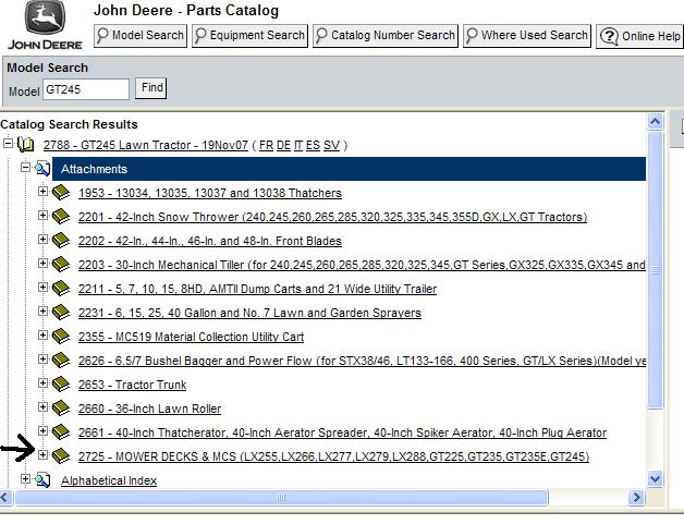

/ JD 54C Deck--wheel bushing #12
Not exactly sure, but when I get to the home page and after I sign in, then I click on the JD Parts Catalog (book cover image - see arrow) and go to this page next (add the model in the blank). That takes me to the second page and under model search can go to attachments and then to the decks.

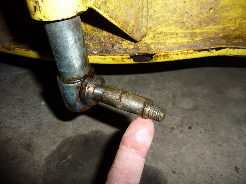

Is that a bolt/bushing or shoulder bolt?
I think it's a bolt/bushing, but I've attached a picture of the backside so that you can see for yourself.
It seems to me that I should be able to drill the "axle" bolt out from the backside, and then perhaps replace it with a shoulder bolt over which I would install the new bushing that came with the gauge wheel. Does this seem like a reasonable approach?
I find it surprising that I would have to replace the whole vertical assembly (the part with the holes that are used to adjust the gauge wheel's height off the ground) in order to replace the worn bushing. I would expect JD to design parts for better maintainability than that, expecially when you get up to a robustly designed product like the LX and GT series tractors.

OK, thanks. The secret was that I needed to create an account and log into the site. What I showed you is what you see if you browse the site without logging in first.

Good luck drilling! I tried it and it is pretty hard steel. When I complained at the parts counter about the bad design, they said the mower wasn't meant to ride on the ground. I guess they were not aware of the jd floating deck quality advantage. At least the one that was in all the sales pitches I heard growing up.

That looks like a allan head on the backside to remove a shoulder bolt.

The parts man was right, the Deere decks are meant to be carried (if adjusted right). And there is a greas zirk on each wheel that will take grease to reduce the wear considerable amount. :)
I think the decks being carried (deck wheels not touching unless to keep from scalping) goes back to the original 110's in the middle 60's. But I could be wrong. :)
