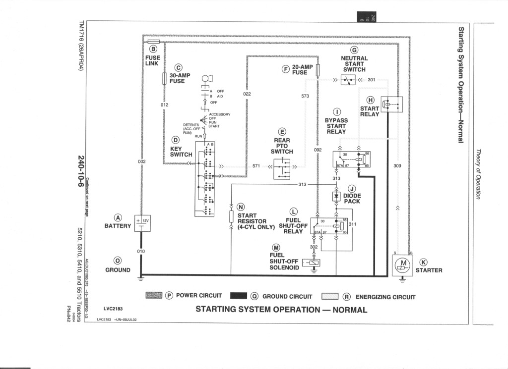

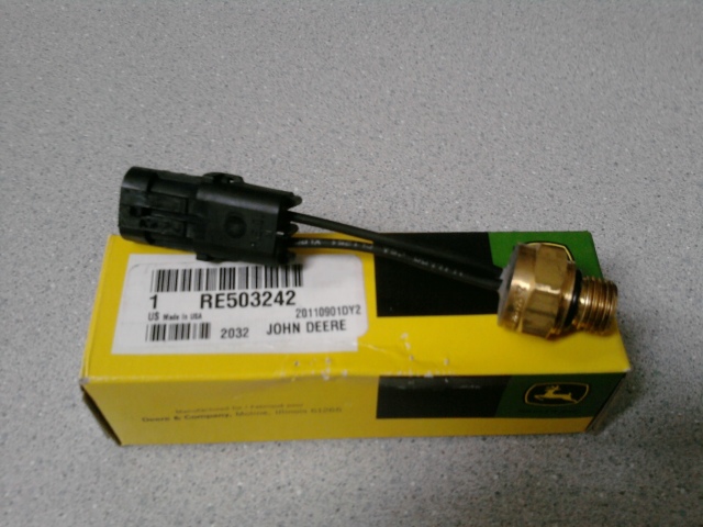

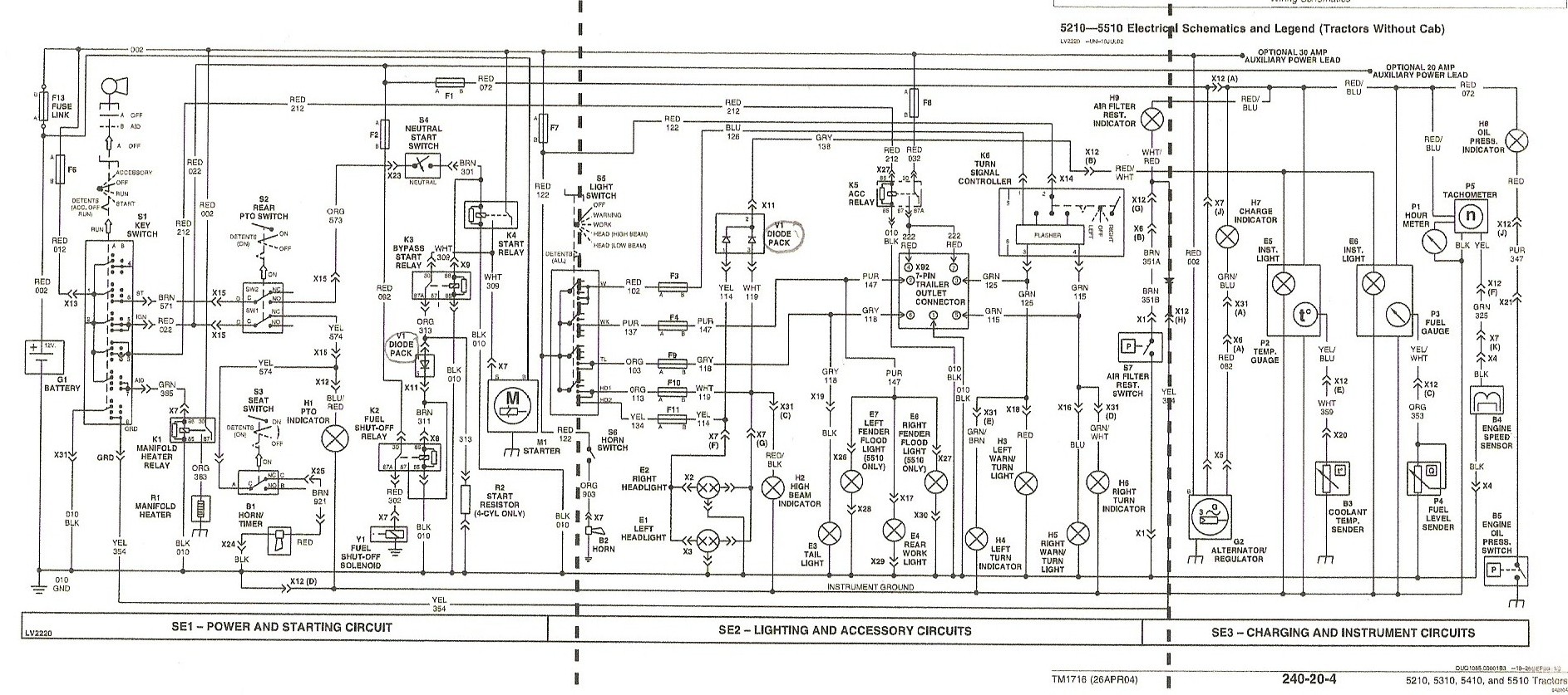

Have you looked at JDparts.com, on the left is a parts catalog with some good pictures. If your cluster looks like the one in the YouTube, it is not the original. Here is a wiring diagram. The engine link I earlier provided is the ctm125 manual. A lot of JD tractors use that engine JD 5X00, 5210, 5310, 5220, 5320, 5203 and 5303. Also current models 5045, 5055 and 5065, these are the E/D.
Keep use posted how things go. Engine part # RE503242 thermistor sensor is the only problem I have read on this site.

Thanks again! The schematics are great, and something I hadn't found elsewhere yet. I did find a parts manual for generator versions, and much is the same regarding internal parts/#s. Didn't see a thermistor anywhere else so must assume its the coolant temp sender.

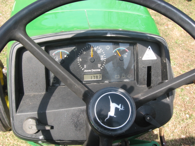

Don't know what to think about that cluster, my '99's being the same as is on the Youtuber's '98. O'all wear & tear suggests more than the 170-some hrs, and I suspected it might not be orig for that reason. btw, his seems to 'knock' uniformly on all three, where mine sounds a bit uneven by comparison. Otherwise everything does seem somewhat tight or fresh. Levers, linkages, etc don't leak or show much play. Clutch adjustment is to spec as it sits.
The tach doesn't seem to read right (a feeling/sound not yet quantified) and I wonder if the hour meter is a rev counting type vs a timer. They both seem linked to the engine speed sensor and I'll have some calibrating to do with a separate digital tach, maybe find if one isn't right and is then throwing others off. While I'm at it, I'd like to crack the case and see if I can reattach the cluster's face & get it flat again. It can't be too tough, as there is a replacement fog-resistant window offered by Deere with part#. Appreciate the help/interest. :)

If your cluster matches the one in the youtube, that one is a sealed unit. If you get a replacement, make sure it is programmed for 3 cyl.
Part number RE503242 is part of the cold start advance is connectted to the fuel solenoid. The hour meter comes off the alternator/regulator, this is from the tech. manual TM1716.

JD5210, thanks so much for additional info! The wiring & hydro circuit stuff is priceless. btw: I may re-route SCV lines/adapters from the rear bracket closer to the loader's QD hydro hookups. Don't see RR use ahead, but adding remotes to both loaders for the small grapple or ?? else up front. The NH is my go-to & the JD is intended for occasional heavy lifting (<2k lb shop machine moving, tree yanking with Brush grubber ...) & hopefully will sport a small tree spade soon.

Well, after nursing rusted bolts and frozen J-nuts from plastic body panels I got the cluster out and find it to be a sealed unit, not one that a typical user would replace a fogging OEM 'window' on. As far as my concern about this being orig and the hours true, check the label's date.
A warped 'dial face' suggests this guy has sit a lot in the sun in five or less years.
The back shows water-tightness and no access screws to allow changing bulbs, with a blanked plug in one of two unused bosses.
The 'window' is sealed on like an auto windshield. I should be able to slice it loose with a hobby knife and reassemble with Super Black or similar. I don't see clamping as a challenge, but any suggestions on an adhesive to reattach the poly dial face to the plastic backing it was originally stuck to? (looks like ABS under there) I guess it was a spray-on something that didn't hold up. Seal All spread sparingly? (pop rivets?.. :laughing:)

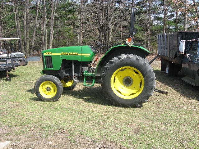

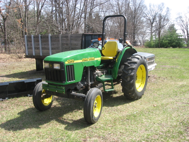

Well, I extended my uh .. break to take a few pics. Recent paint looks sharp, even up close. Nooks and crannies show dirt & rust I'd expect on a 15 yo machine. All gauges are working, seem ok. Light switch pinouts were scrambled & headlights now working, but turn & hazards are still goofy. If it's not the flasher/switch, I suspect one of the diode packs isn't right. That can be checked later.
I did manage to get two vids w/sound but will have to host them somewhere if my guys (the best) won't do .avi for me. I'm sure any would agree from the sound that either one cyl is weak or one is strong. (working on that upload) Its true hours are showing somewhere, if not on the readout.

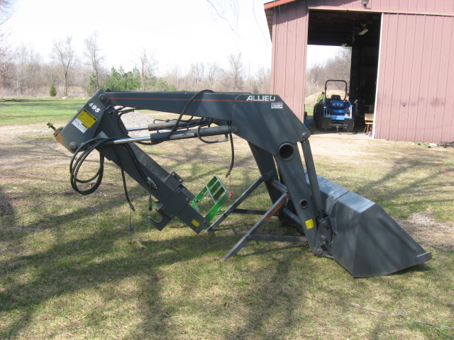

Here's the loader that I ordered the mounting kit for.
Now that 'er my pace can be better reconciled with my braggadocio :)rolleyes:), I'm hesitating on pulling the injectors before the lash job that I'm so sure hasn't been done every 400 hrs per JD. Didn't call DFI yet because I didn't have 'em out. No JD dealer in my county lately other than mower dealers, but won't need more than a rocker pan gasket for now.
JD5210, I have the digital tach now, promise to check PTO rpm soon. Nice to see what near PTO speed sounded like & know where I am above 1k rpm now. :) Guess I could Ultra Black the pan cover vs ordering a gasket. It's non-corrosive (vs reg silicones) and made for that ...
Ooops! Thumbnails below are from ... 'er too many thumbs ....

Looking good, glad you got the instrument cluster working as that would have sent you back a few bucks! There is only one diode pack, what does goof mean on the flashers? There are black tube plugs at the base of the ROPS on each side under the tractor one for positive and one for negative. There also identical looking plugs down there for fender lights that come on only the 5510. The fender light plugs have power when the work light is on.
I have never seen or read that there is any way to tell how many hours other than what is on the cluster.
The paint looks really good and I bet with a little light rubbing compound and an electric buffer that hood will look as good as new.

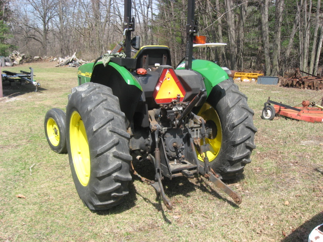

I am guessing you already figured out you are missing the cover over the PTO shaft and the cover over the transmission in front of the seat.
Nice loader even has its own hood guard. If you are planning on put a coolant heater on it, you may want to do it before you put the loader mounts on. The coolant plug is located at the back and top of the engine on the left side and requires a 5/8 allen wrench.

OK, here's 'what I got'.
Before checking into it the flashers worked, as did both rear light bulbs (here & there), but lotsa stuff didn't even light up. LT arrow on the cluster was on no matter what I did. While I had the cowl semi-off (#!&$ j-nuts) I pulled the HL and TS switch terminals, buffed one by one with SS wire brush and Hoppes #9 and corrected the Or/Yel mismatch. Voila! Head and instrument lights work fine and in correct sw positions. RT works ok, but LT and flashers still don't. Flasher mech is part of the TS switch(?) & I think having lost its seal & being on the 'wet & rusty' side I'm sure it's toast. Kinda OT here, and on the back burner for now.
Bodywork paint does indeed look good from >10' away, but shows a few scratches and some burned edges from being buffed when up close. Just about everything not green or yellow could use a going-over. That can wait a bit, too.
I noticed no PTO cover while on the lot. Trans cover was me removing foot-boards to see if the '2750' etc loader mount could be cobbed into working with only a few brackets milled/drilled, whatever. Not a chance. Green part on the front is part of the mount I bought FEL with and it's coming off. Lacking the 'right' 495 (S-model, for 'short') I was still able to order a mounting kit for the shorter wheelbase Deere, with Buhler/F-K's blessing and a caution only that it'll hang 6" or so farther forward than ideal. Oughta look BA vs the '395' that'd better suit this use. 2 1/2" cyls and 2800 PSI (if accurate) should be enough to get me in trouble. :eek: Don't plan to 'push it' or use the 84" bucket at all, but might have to add the old mounts to whatever ballast I'll really need with this setup. :D

http://www.farm-king.com/manuals/AbFK-FEL/loader-495-2005.pdf

I have included a link to the manual for the 540 loader. You may want to look at Section : 45 - Attaching the Loader, #12. To see how the hoses are support as that is a long run from the loader to the back of the tractor. The manual also has some recommendations on ballast weight. Looks like your dust covers are missing Identifying Hose Connections in the manual (bottom of page) shows which port does what.
http://manuals.deere.com/omview/OMW44993_19/
