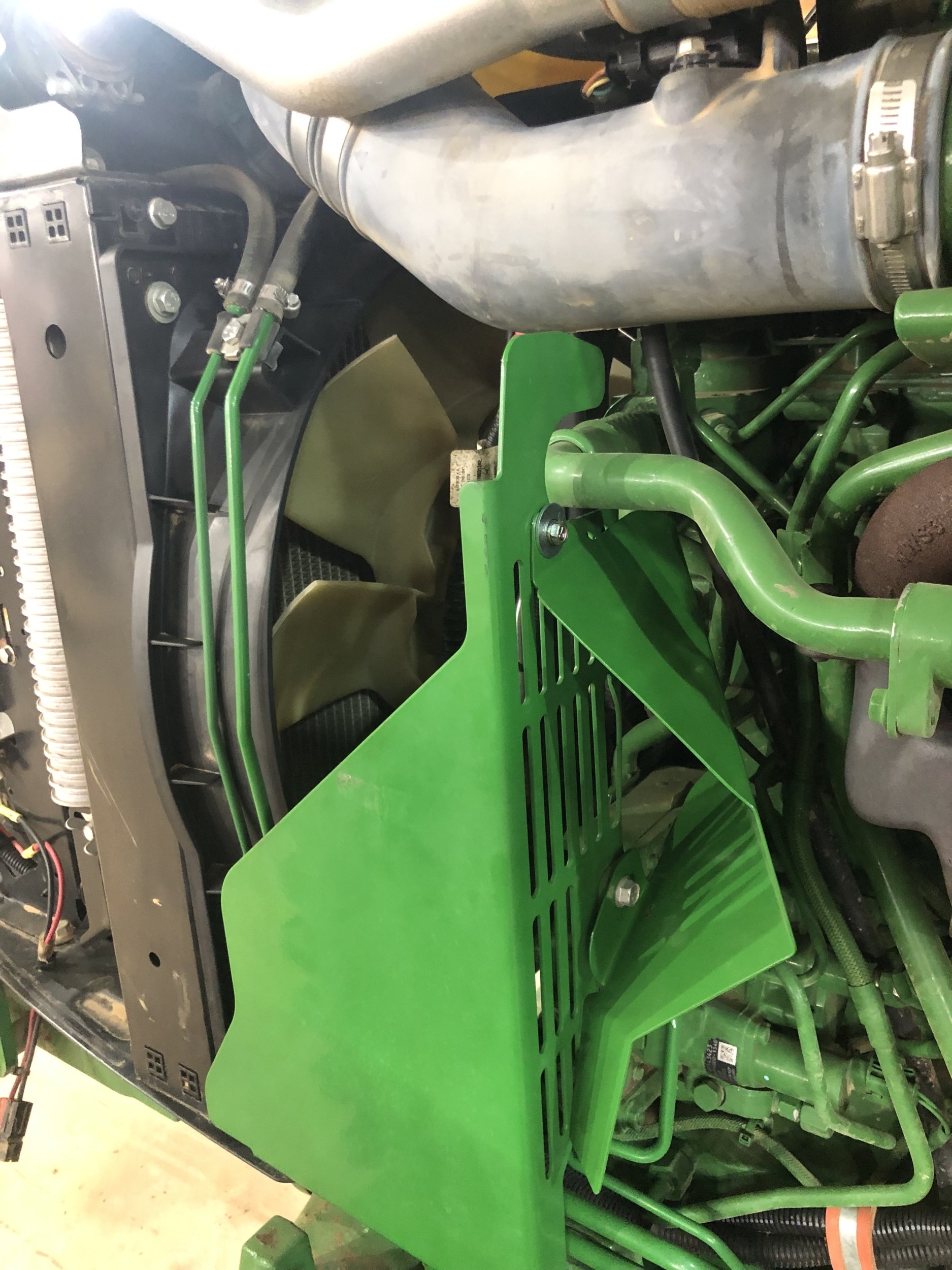

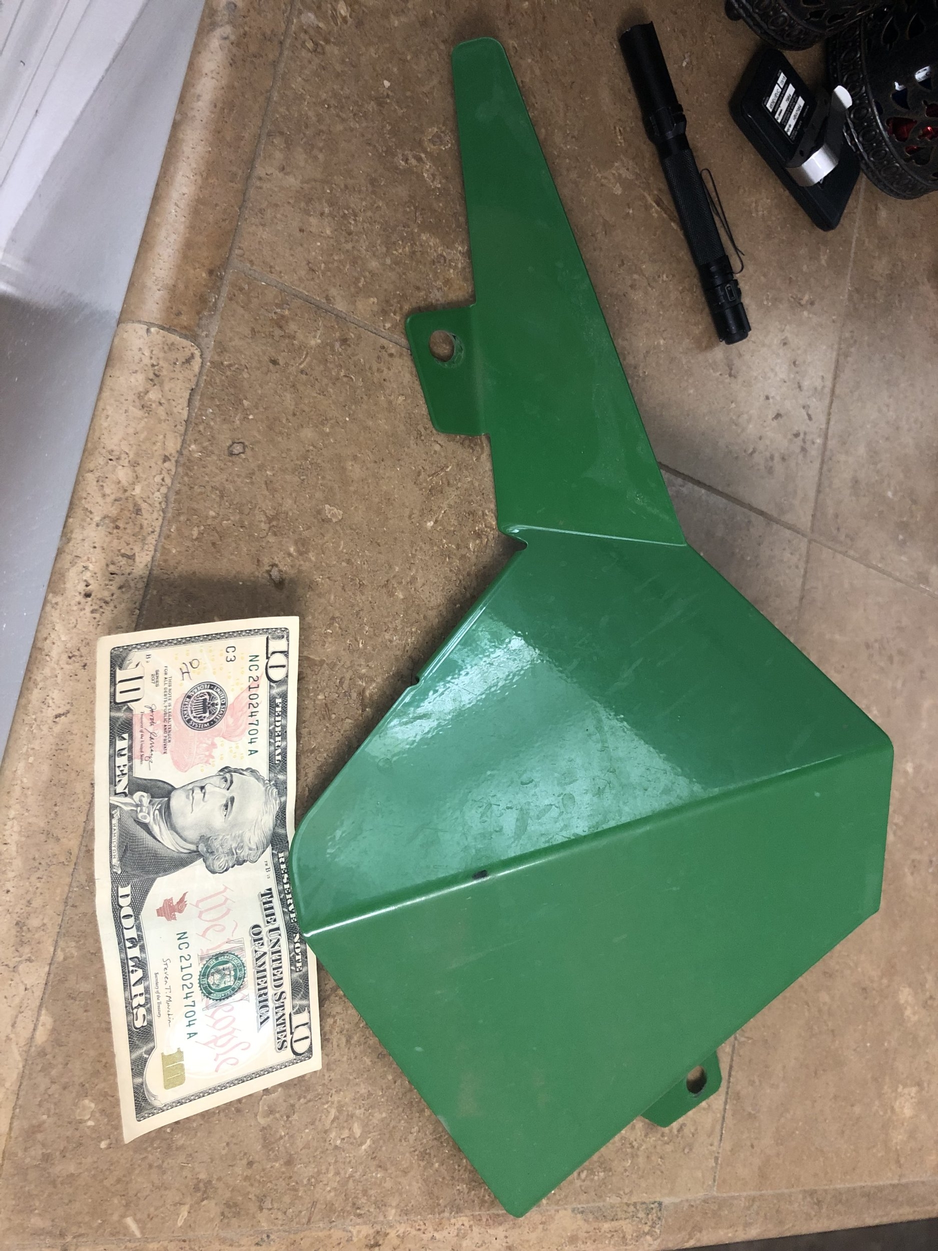

I’ve tried to buy one of these heat shields from JD & parts guys can’t find it listed so I’m getting my machine shop buddy to make me one for my other 5115M that doesn’t have this option.
I took my old one off to go by.

This shield keeps the hot air that’s blown from the radiator off the operator on my 2018 5115M open station.
My 2020 5115M came with this shield from the factory.
Makes a big difference after riding the tractor for Hours.
