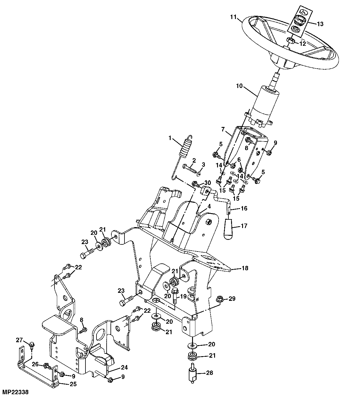

Feb 22, 2014 / jd 4600 steering wheel removal? #1 J jbteehee New member Joined Feb 22, 2014 Messages 2 Location burson Tractor john deere 4600 How do you remove the steering wheel. what is needed?

Feb 23, 2014 / jd 4600 steering wheel removal? #3 Tx Jim New Member Joined Jan 26, 2007 Messages 10,404 Location Coyote Flats,Tx Tractor JD 4255/Kubota M7040 HDC Pry cap off(parts key #13),remove nut and utilize a steering wheel pulling device Attachments MP22338________UN28FEB00.gif 29.2 KB · Views: 227 Capture.JPG 50.5 KB · Views: 198
