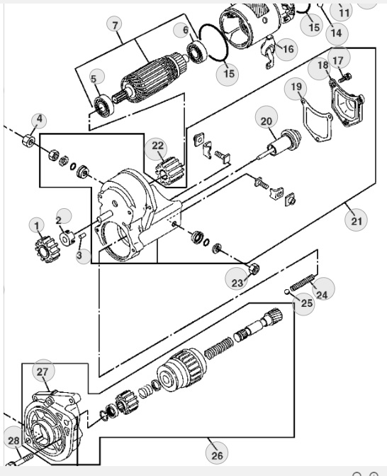

My 4600 has had an issue off/on with a loud "grinding" sound sometimes when I turn the key on. After one or two attempts the started will engage and turn the flywheel over and start. The problem is getting worse. Anyone else have a similar issue? Is it likely a damaged "bendix" type gear on the starter or a bad spot on the flywheel? Any suggestions to check?

it sure sounds like a bad starter, you can buy a new one, or have your old one repaired at an electric motor repair shop..
/ JD 4600 - Grinding Starter Issue #4
I found I could not get a new Bendix spring for my aging Mitsubishi. A whole new starter from a local starter shop was only somewhat more expensive than the Bendix assembly alone. I replaced my starter and I've not had the grinding since. The starters can be kind of generic. If you have a local starter shop take the starter there first.

Don't keep grinding the starter you will ruin the flywheel .....
/ JD 4600 - Grinding Starter Issue #7
At a minimum, I'd remove the starter and look at it to see what may be happening.. before grinding any more.
Parts showing what looks like a gear reducer, after the armature (key #7), then grouping #21 called the "switch" , and grouping # 26 called the "clutch". May be helpful when looking at the starter once removed. Wish you well.
Many thanks for the diagram and replies form all - -next chore on the list is to remove the starter unit and inspect.
For those who replied that you bought a new starter - any recommendations for purchase - - looks like JD wants big $$ for a replacement.

I had the same issue early on after I acquired my 4600. When trying to crank the engine, sometimes it would make a very nasty grinding sound that increased in pitch until you finally reacted and let off on the key. A good friend told me to take out the starter and hook it up with jumper cables. Have a friend complete the connection while trying to hold in the output shaft. He said that if I was able to keep the gear from thrusting out, then the solenoid is weak and the starter should be replaced. That was the case - it was pretty easy to hold in. I found a replacement on ebay for about $100, and it has worked perfectly ever since.
