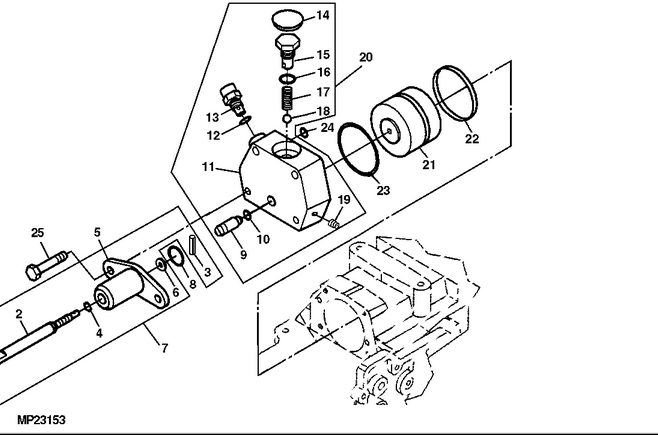

I'm not familiar with later model JD tractors as I left dealership in '87. Since no parts breakdown is listed in JD parts catalog my guess is valve is non-repairable(2nd photo) but I would think a novice mechanic could easily R&R the valve. I don't know what function ball(parts key 18) does but for 40 cents I think I'd replace it. I checked on the price of the relief valve(parts key 13) and it's $93.
R42849 Ball - BALL,STEEL ADD 0.40 USD

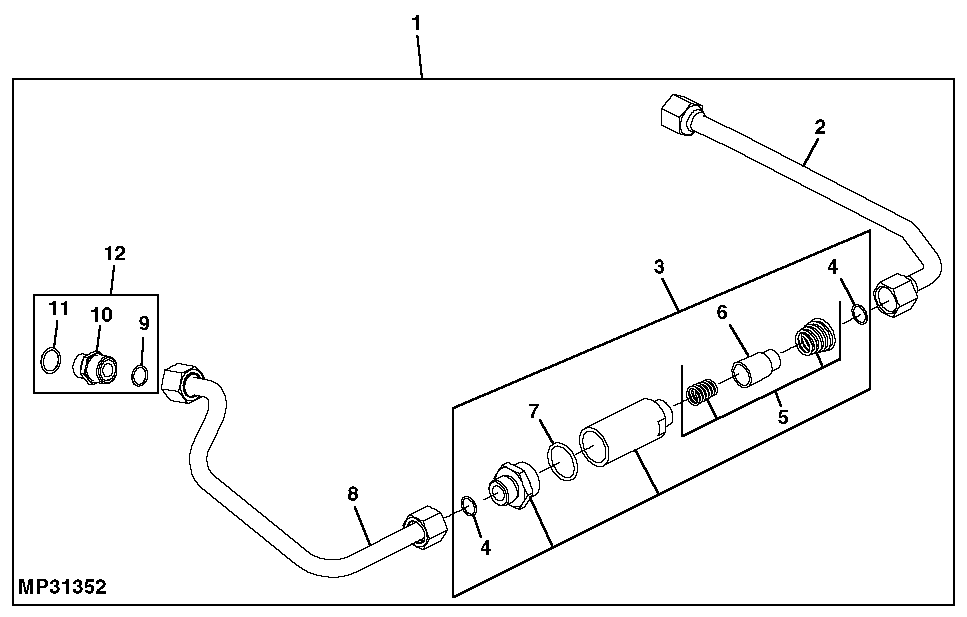

Thanks Joe. You were kind enough to send that to me back in November when I bought the tractor. I did find a transmission service bulletin that reads:
NOTE: If fitting screen is found to be dislodged, the rockshaft control valve must be removed and inspected for debris. See your John Deere dealer if this service procedure is required.
So it looks like the valve can be cleaned. I will hopefully be pulling the valve this weekend to clean it out. If anyone has any tips on cleaning the RS control valve please let me know. I'm assuming solvent and blowing it out with an air nozzle will do the trick. At least I hope it's that easy.

The dealer installed the updated line with the new inline filter. I noticed this morning that they installed the filter backwards. I will flip it around tonight to see if that has any affect.
/ JD 4200 Rockshaft Control Valve Question #10
Did they (dealer) say anything about the original screen being dislodged when they installed the updated inline filter? The problem, IIRC, was that screen becoming dislodged and ending up messing up the control valve.. either sticking in there or the metal parts scoring some of the important surfaces. Thus the comment "the rockshaft control valve must be removed and inspected for debris".
And if the new inline filter is indeed backward, take some pics and notify the dealer before changing it.
#11
I installed the filter correctly and the problem seems to have been resolved. No bounce and no bleed down when engine is running.
