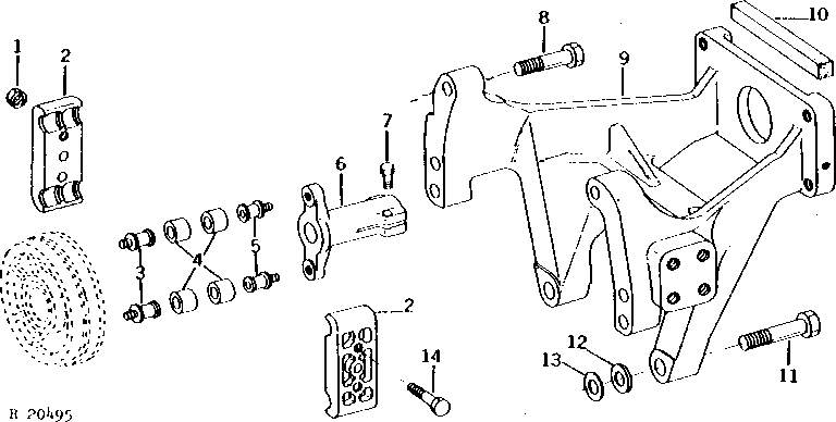

Belt should fit between fan & shroud without loosening/removing fan. You'll have to disconnect frt hyd pump drive coupler by removing clamps(parts key 2) to R&R fan belt which would be an opportune time to change bushings(parts key 4) 4ea-R45822 Bushing - BUSHING 2.43 USD

The a/c belt is behind the fan belt. You will need to loosen alternator and remove fan belt from pulleys. Then loosen the a/c compressor and tilt it in to have room for new belt. Then as TxJim says, the hydraulic pump coupler needs to come apart to get the belt on. I would recommend replacing the fan belt at the same time since you will have it off anyway.
