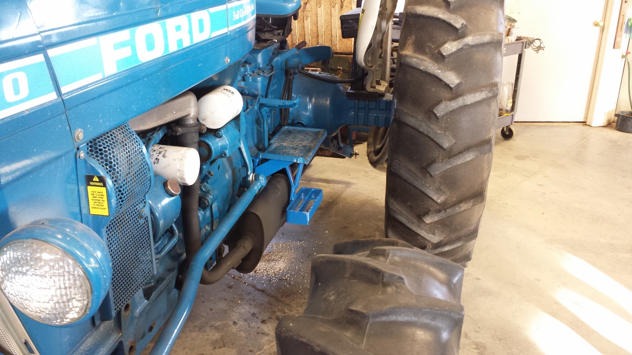

I built horizontal exhaust for my Ford. Painted it satin black using Van Sickle exhaust paint in a spray can. Man that stuff is good paint!!!!!!
/ JD 3005 exhaust mods/replacement #82
Here's a pic. I cheated and used the stock vertical muffler. Just showing the paint in this pic.
Have you had any troubles with the muffler getting hit by those phantom flying sticks with this setup Richard? I hate the position of the L3600 exaust.
/ JD 3005 exhaust mods/replacement #84
Not so far. I'd rather not talk about it. Soon as I do I'll yank it clean off...... :)
I kinda worried about heat but don't feel any. I did it because I'm in the timber a lot and knew I couldn't deal with it being vertical there.
