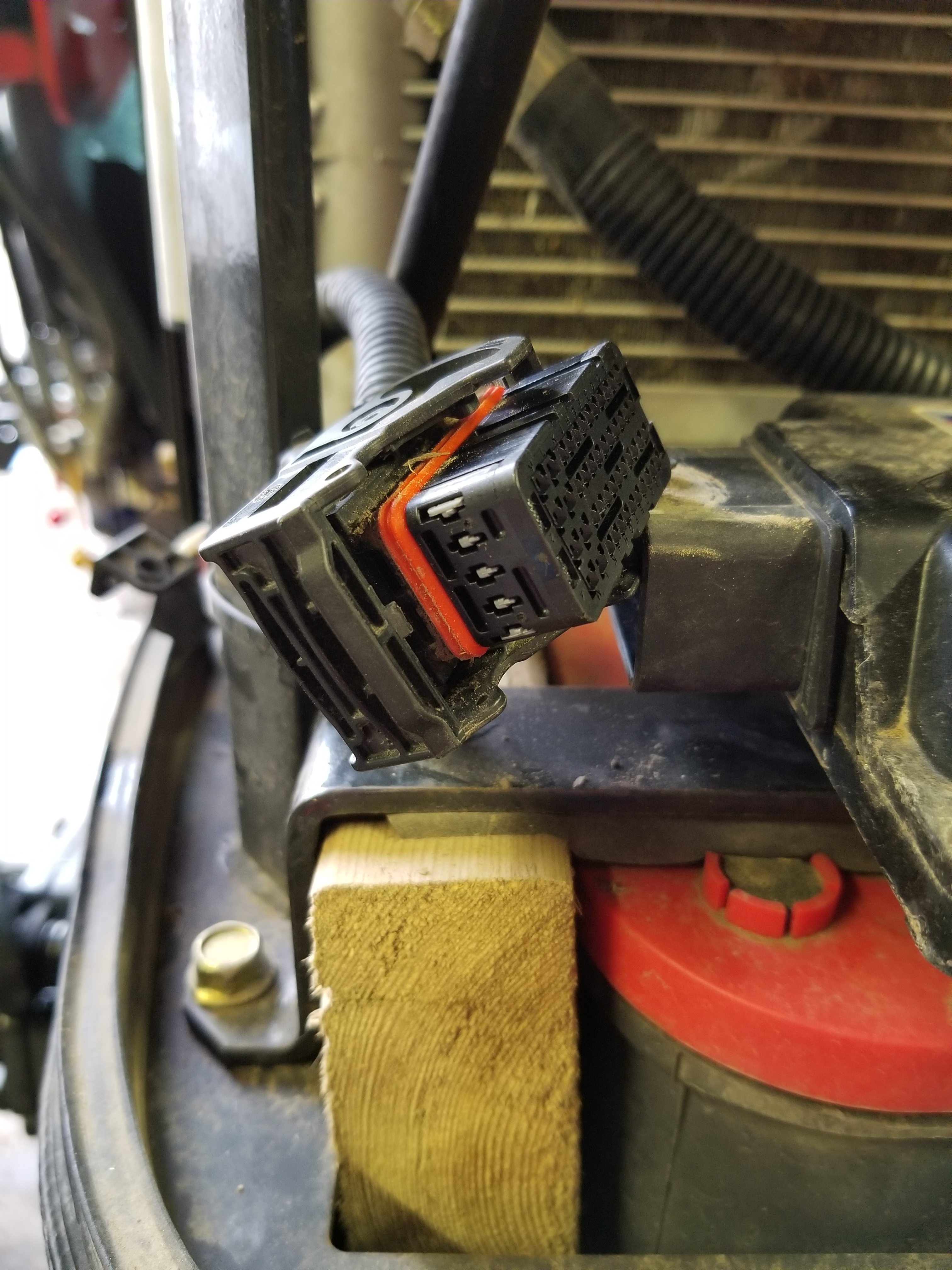

I have unplugged my data logger, and removed it from the tractor. Since doing that, my dash light never comes on.

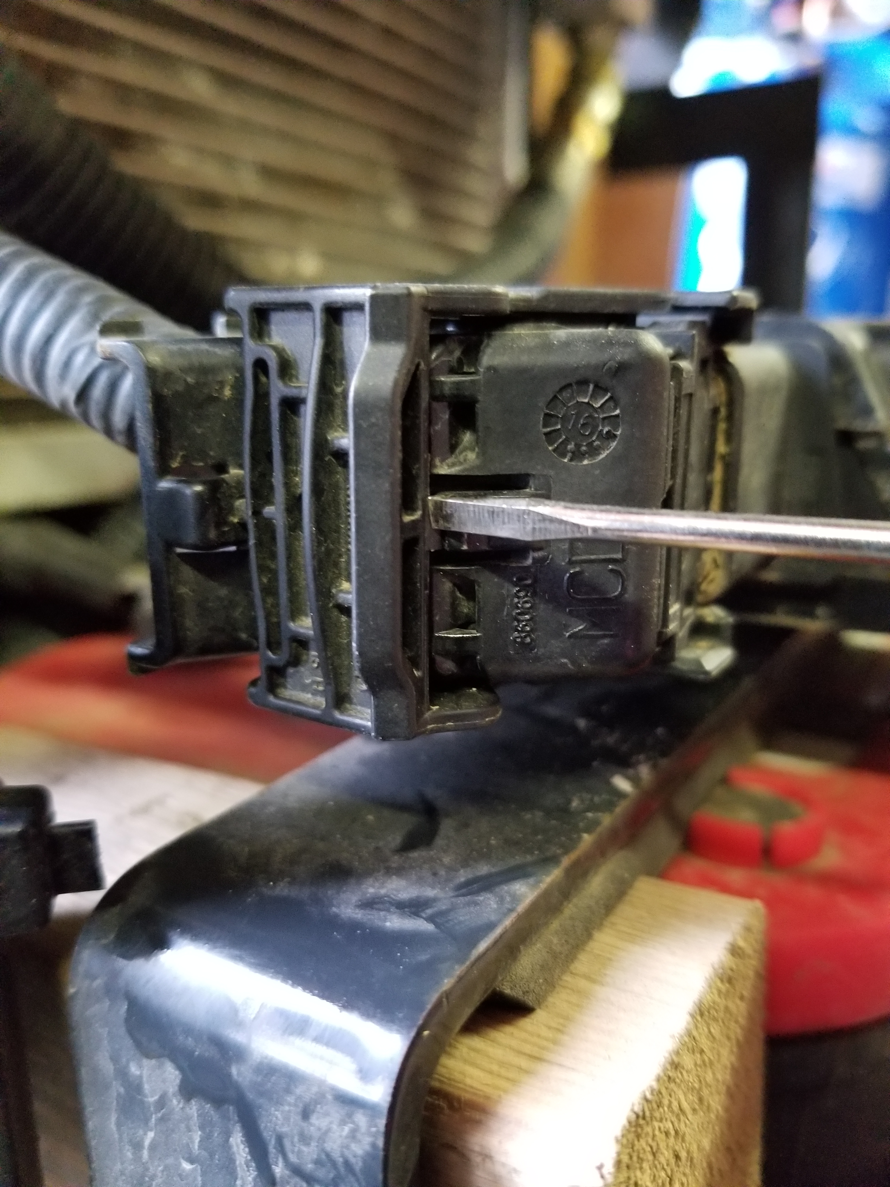

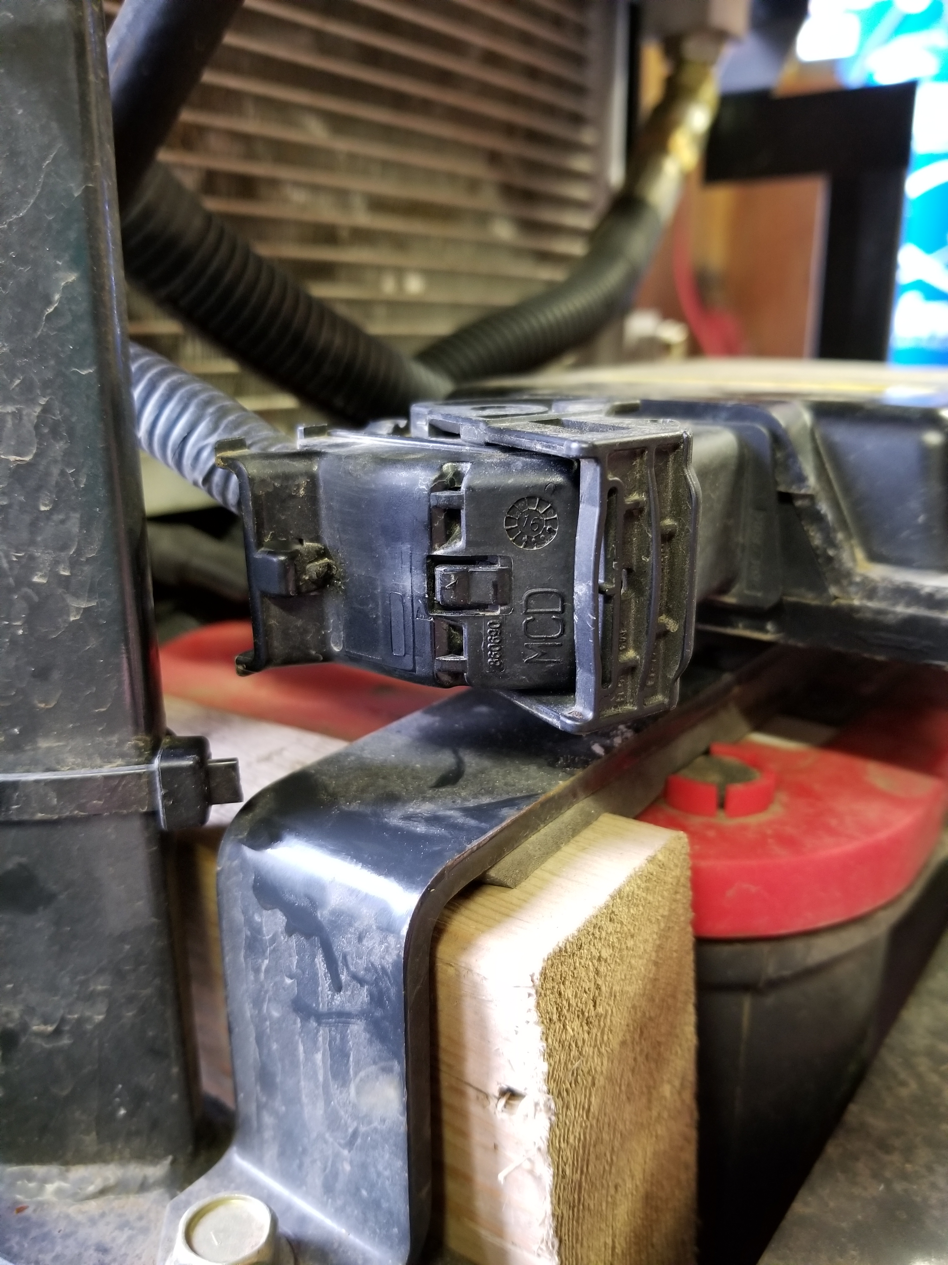

Data Logger, at least on the 25 series (mine), it is located on the battery hold down bracket:
This retaining clip must be released, small screw driver in previous pic works well to press in tab, then rotate clip to right (in pic):
Then pull connector straight out the side of the logger. It was in there very solid, with a tight seal.
I was originally going to take the entire harness out, but it is woven into the main tractor harness, and I just didn't want to take the entire thing off, separate it out, and put the rest back. So I wrapped up the plug in plastic and tied it back to it's harness. The sensor wires are also tied back to the harness at the other end.
It's been this way for over a year now, and I haven't had any issues of any kind.
