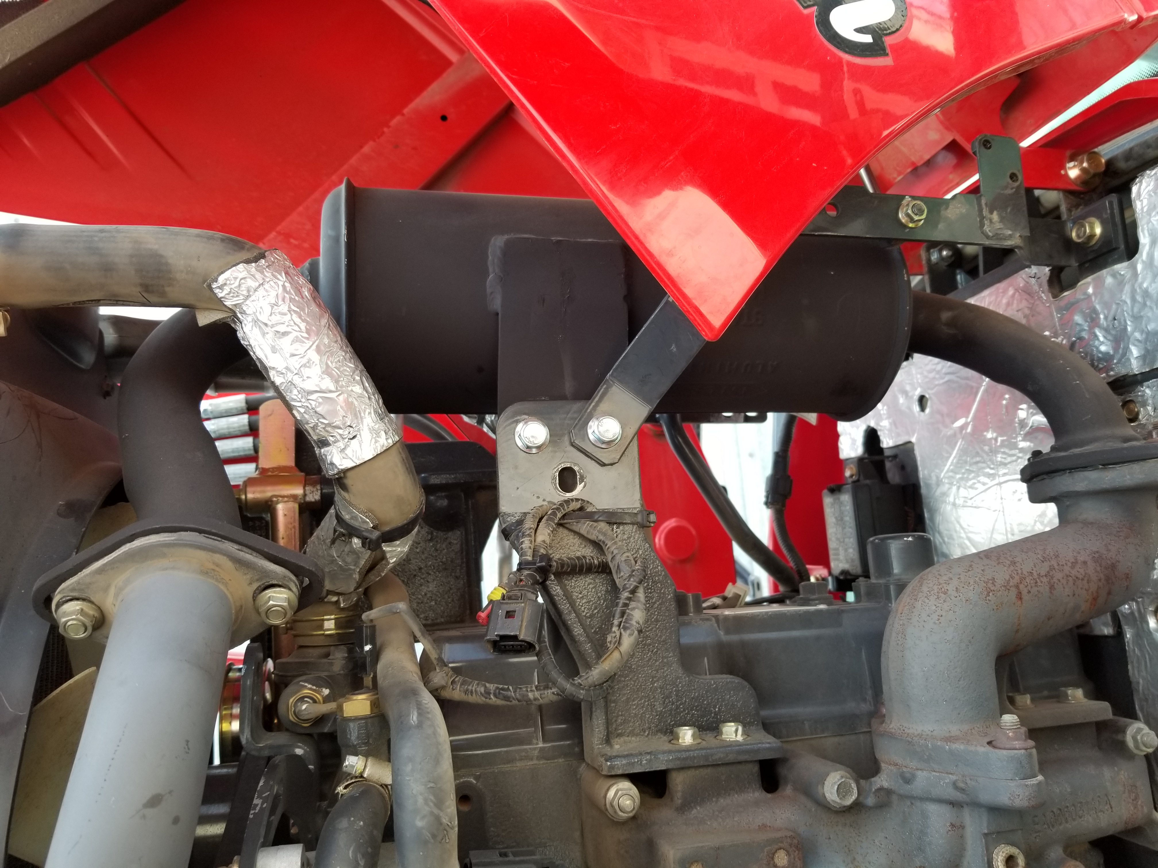

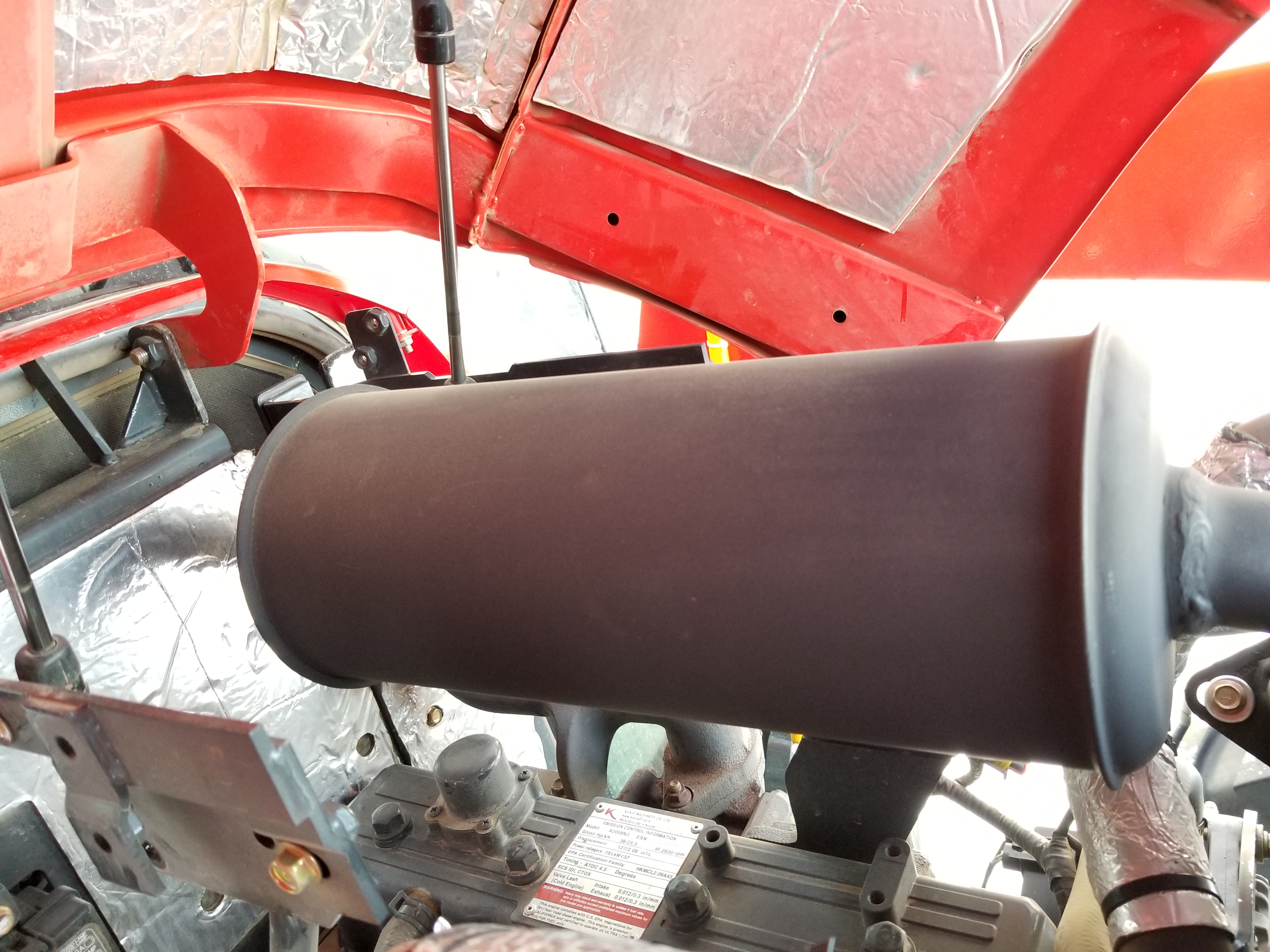

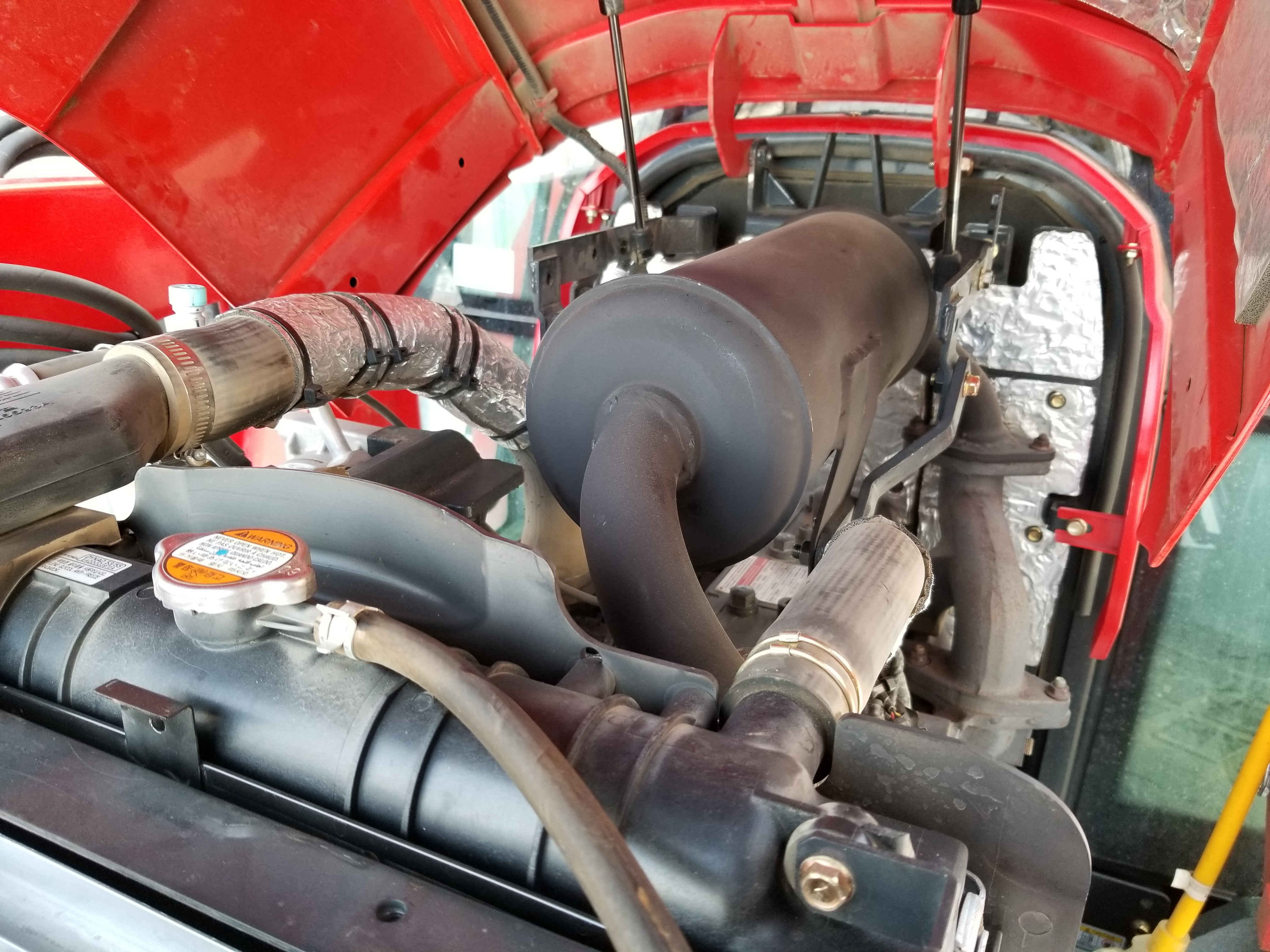

Here are the obligatory pics:
The OEM flanges on the exhaust manifold, and the bottom pipe were not touched. New pipe was bent to line the inlet and outlet of the muffler up and new matching flanges were welded on. Exhaust shop even belt sanded the new flanges once welded to the pipes, to make sure they were perfectly flat for a good seal. He even painted the muffler (I hadn't asked for this, but thought it was a nice touch), which now looks like it could be a stock configuration. He also did a very good job tying back the wires from the harness. You have to really look to see them, and they shouldn't cause any issues. I fully plan on removing the entire harness, including the data logger, but I confess I plan on waiting until its much warmer out to do this (unheated garage).
