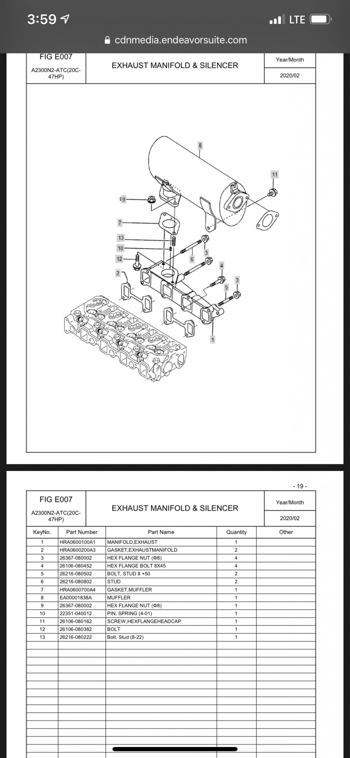

kukje a2300n2 engine.
muffler ea00001838a.
that is the model of the bolt on muffler for my 4820ch. Any of of our overseas guys able to send me a link to buy one? I have tried every search. No one sells the factory muffler

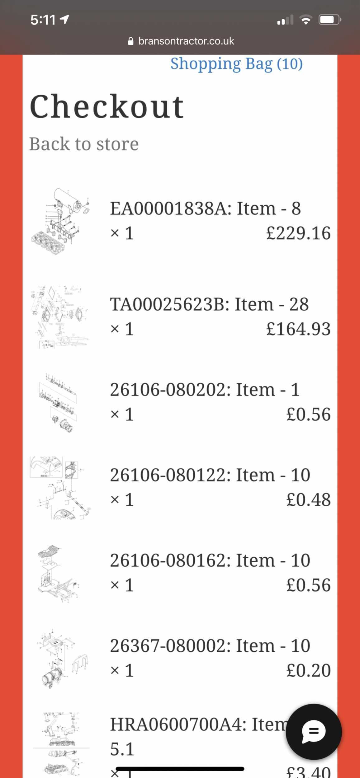

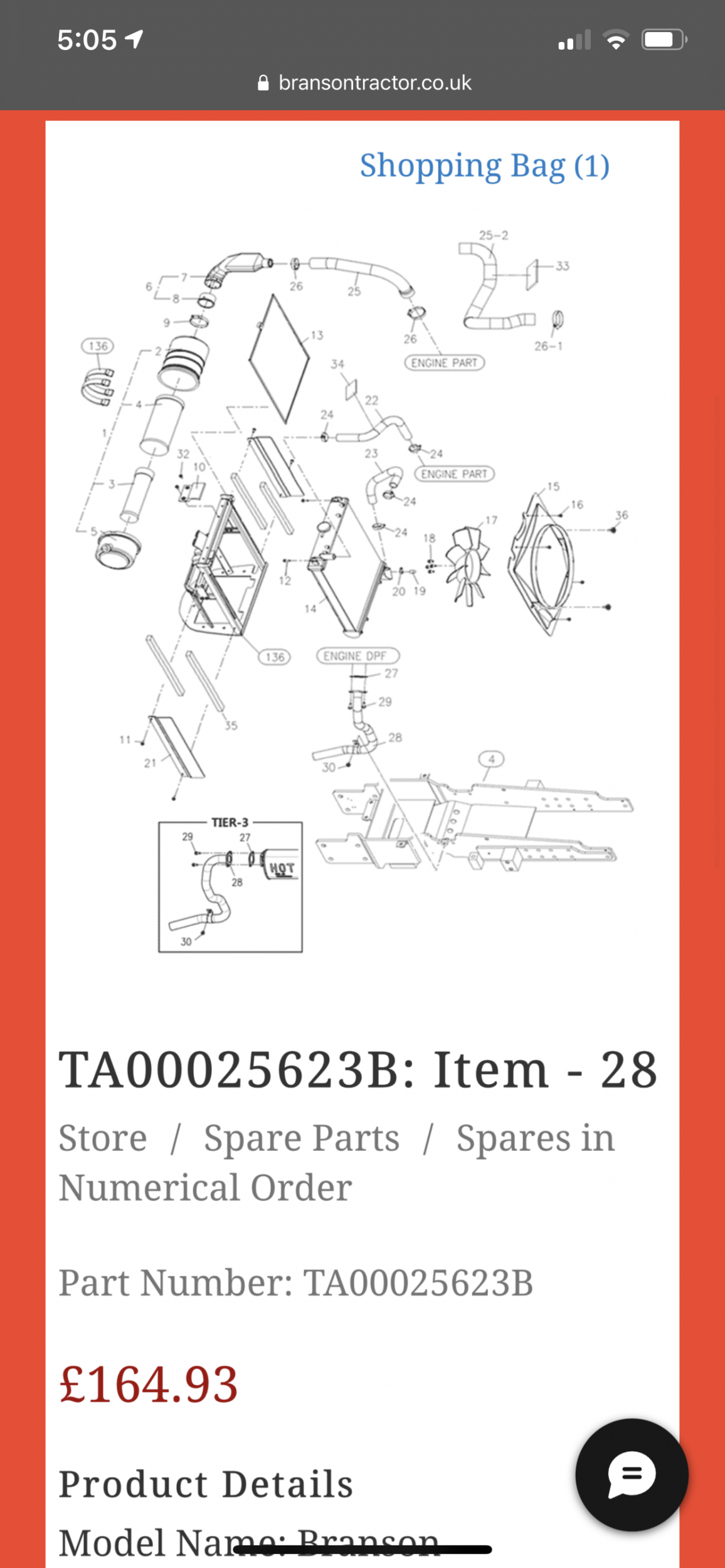

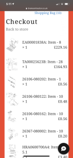

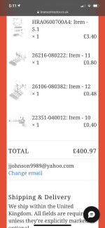

I put the full list together down to the bolts. I emailed them the list waiting to hear back if they will in fact ship. Here are the part numbers to convert a a2300n3 engine to NON DPF
