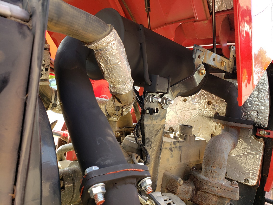

I made the mod exactly as Slowpoke slim did with the Stanley IH4 muffler on my 2018 3520 Branson. I am very happy with the mod. I have had it like this for about three months now. Data logger completely removed and no issues at all runs great, rpm gauge works too. THANKS SLIM!
I do landscaping mostly so never really had to get the tractor that high in rpms. I was constantly having issues with DPF and having to run it full bore on the street for at least an hour to get the light to go out. One time it gave no indication of an issue just shut down and would not stay on, I had to have the DPF cleaned which cost 250.00. It was more than the mod. The muffler shop charged me 150.00 for the mod and I spent 38.00 on the muffler.
I feel like it does have more power, I definitely go up hills a lot easier and it lifts more than before. I attached a a couple of pics it came out really well muffler man did an excellent job and I still have the old unit in case I need to put it all back on.

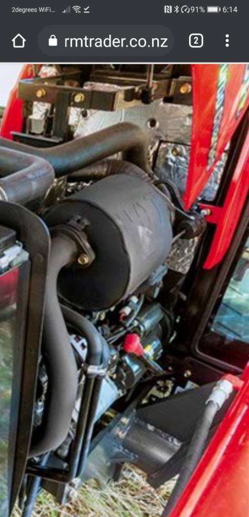

I'm in New Zealand and have 2021 6225H that is equipped with a regular muffler, no DPF.
