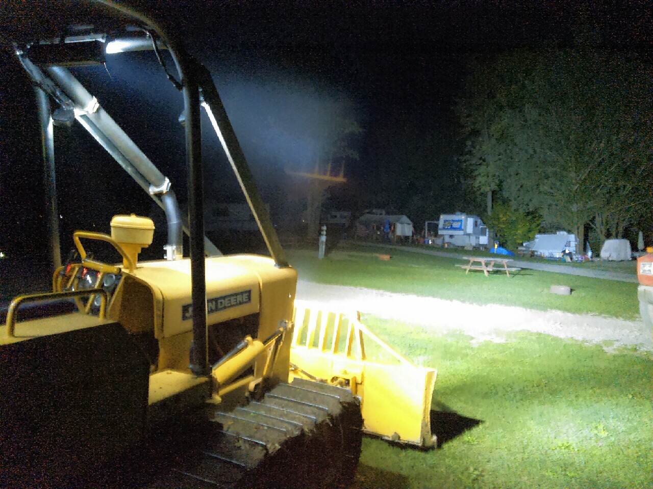

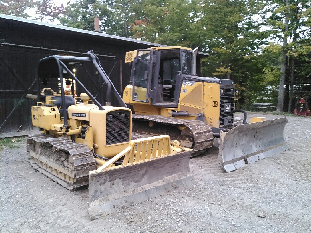

On my dozer I have an exhaust that runs up the limb riser to the roof and the muffler has a 1-1/2" or 2" pipe that protrudes about 5-6" through the hood , the exhaust stack is clamped to the hood and is a 3" pipe the muffler is not sealed to the stack, just stubbed up into it, a lot of John Deere dozers are like this. Or you could do wha t deer did with some of thier skidders and after the muffler plumb the exhaust into the bottom of the limb riser tubing and have it exit out at the top, but I could also see that as a burn hazard on a tractor that is lower to the ground and you or a child might grab on to it while it's hot.
In the pictures the the muffler pipe ends about 3" above the band clamp holding the stack to the hood, and there is an air gap the pipes are not conected , on a cold start when cranking it over you might get a couple puffs of smoke for a few second til it fires up .
