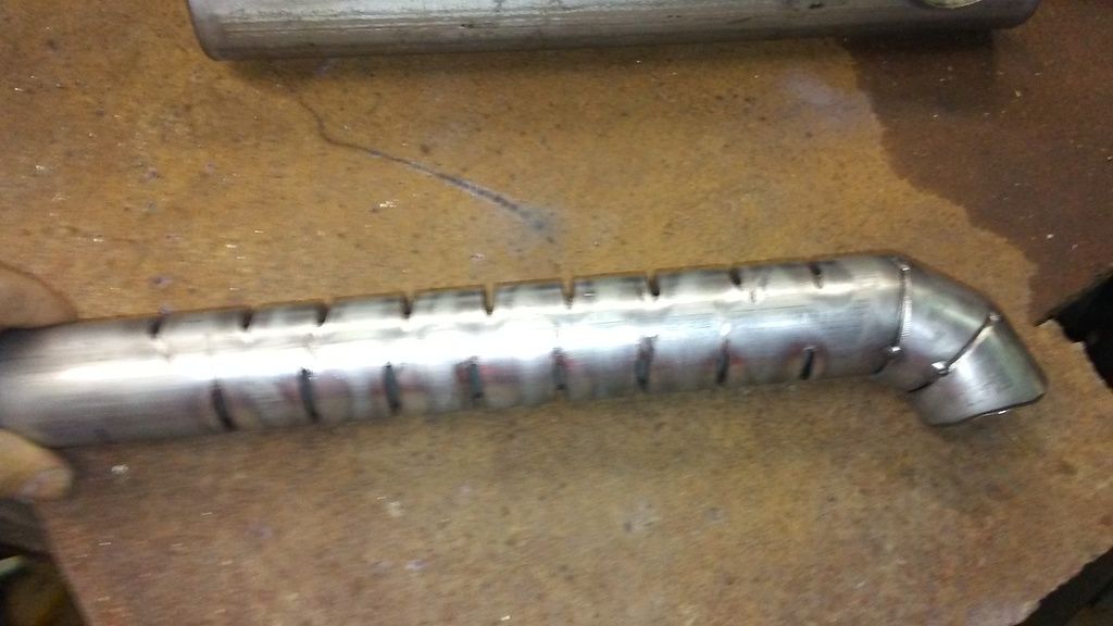

Got the muffler opened up today...
   / JD 3005 exhaust mods/replacement
#102

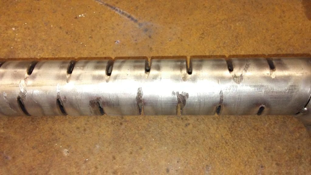

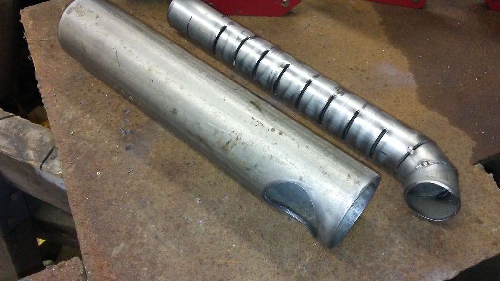

Frustration is setting in... 5 minutes here, 10 minutes there, mostly as Im in the barn doing the evening feeding chores. But... Better than nothing.
Chopped up the inner pipe inside the muffler. Not pretty but it HAS to change the sound somewhat. Whatever it is, it is.
I think I will tack the shell back on, put it all back on and 'sound check' it, then remove to finish welding and painting. I will cover the unwelded seams with foil tape for test purposes.

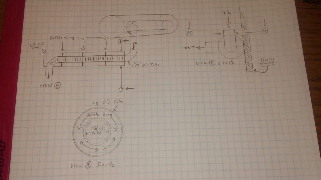

From homemade mufflers I have seen, they have partial plates inside the muffler that baffle and "restrict" the flow and force it back and forth from side to side. A good example was in one of the muffler sites I saw a couple of years ago. Flowmaster I think. That's just what I remember.

Thanks for the compliments and for tagging along...
I gave up on a 'test listen' and after tacking the shell in place, welded in all the seams. I plan to smooth up some of the welds, and paint every thing, hopefully this weekend if I can... Want it done.

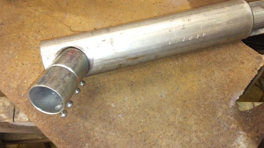

I finally got things painted and put on the tractor last night. Aside from running it for less than a minute inside the barn, I have no idea if the sound has changed enough to suit me. Future testing required. I did find an exhaust leak I need to deal with at one of the slip joints I made.

Had the tractor out to clean Horse stalls today... muffler mods helped the cackle a little, mostly tolerable noise level now... but an hour or two of brush hogging at WOT may tell another story. Will update as events happen.

It still this that 4 cylinder glass pack 'brrrAAPPPppp' at certain RPMs under light to mid load.
I'm with holding further feelings of dismay until I get a chance to really work it hard, brush hogging, etc. The combo of long and small diameter pipe at the end of the run is likely a major part of the cause.

Brush hogged for about an hour this evening. The noise level is noticeable, but tolerable, for now. I'm going to just live with it, but may still add another 'muffler' towards the end of the last long straight sections. Having the end of the pipe less than 2' from my head, while pointed away, is still 'right there'!
