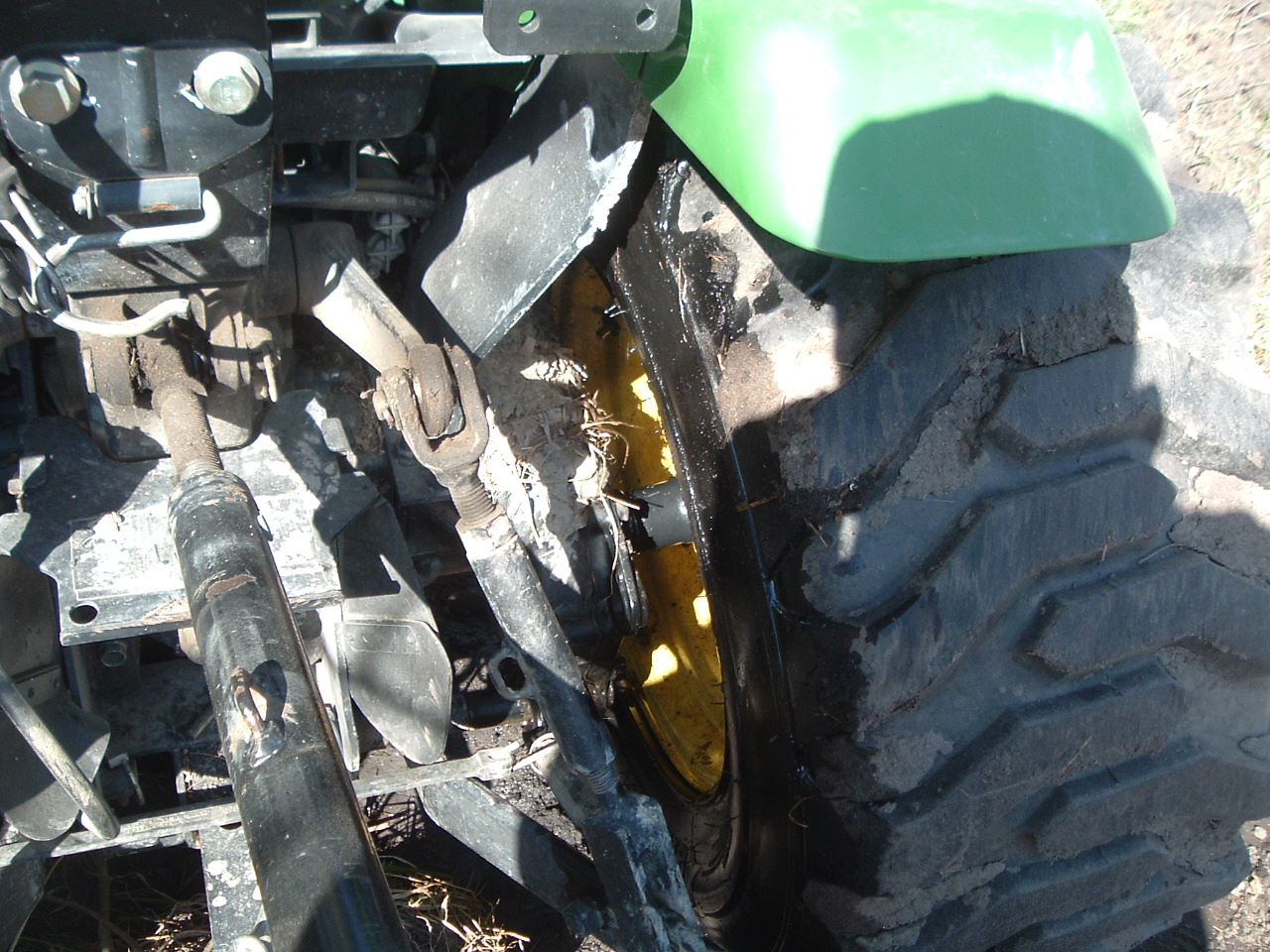

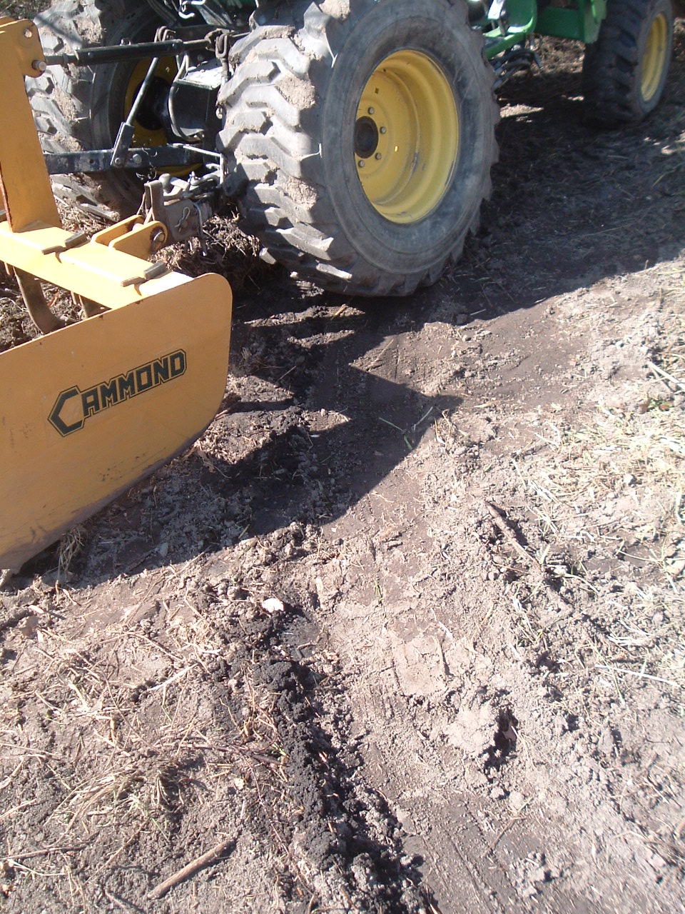

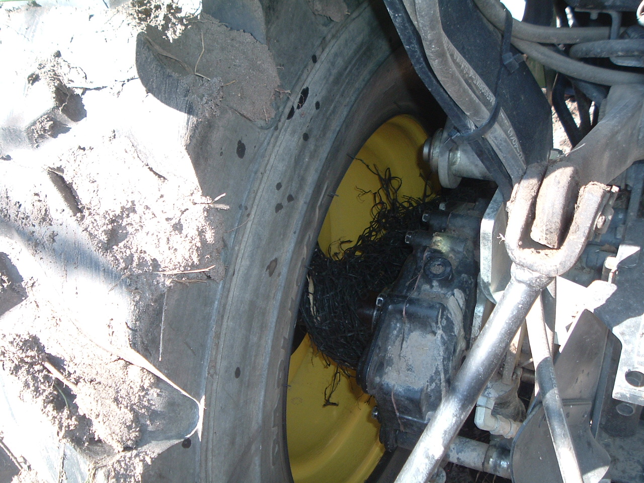

I was clearing brush for a new neighbor with my 2520 (160 hours) when I heard a pop and gushing sound. I shut down the tractor and checked out the back, where I found hydraulic fluid gushing from the right axle hub, the right wheel no longer perpendicular to the axle centerline, and black plastic mesh wrapped around the left axle area. Four wheel drive was engaged. My guess is that the left wheel siezed due to the mesh, the right axle snapped and the tire was dragged sideways, producing a trench seen in the photo. I would like to get a more substantial tractor but I have a lot invested in this one, including the 200CX loader with 2 buckets and the 62D mower. This will be the 4th and most substantial repair, having once sheared a drive gear on a front wheel, and twice replaced the outer drive gearbox housings on the rear wheels. I purchased a Deere because I believed in their reputation as being customer oriented and having quality products. I don't think I abuse my equipment, nor that plastic mesh should be able to snap an axle. Do you think I have a "lemon" and should seek remediation with my local dealer?

From what I could see here that plastic may not have had anything to do with the right wheel!! I have a 2720 and have always thought of that rear wheel set up as a weak link. I am used to seeing tractors with a straight wheel shaft, rather than what must be an offset gear box. I am sure this is the HST set up but it looks weak to me for carrying as much load that these tractors can put out. Would really be interested in what you find out from your dealer as being the cause.

That mesh didn't cause any problem. That had nothing to do with it.
It looks like the final drive housing broke not the axle. The axles on these tractors are a short stub shaft , that is what puts so much stress on that final drive housing. the amount of leverage especially with heavy weight on the three point is crazy.
Were all of the bolts in the final drive housing? you said they have been repaired before, i'd say your bouncing to much weight on the rear which is what is breaking those housings..

Ditto on the mesh not being the cause. If it had locked up the left wheel the tractor would have tried to turn sharply to the left.

So what caused the rut on the path leading up to the ginked wheel? It looks to me like something pushed or dragged the tractor sideways in a turn and that force caused the axle to snap. Is there more to this story?:confused2:

I cut the mesh off the left wheel and now don't think that caused the problem on the right. I've had baling twine and steel fence wire wrap a rotary tiller and a rotary mower, so I respect what binding forces can do to steel and bearings. The mesh wasn't wedged deep, nor very tight. I did notice hydraulic fluid at the beginning of the rut, so I think when the failure occured, the tire went off-axle, and it was the tire dragging sideways that caused the rut. If there was excessive force cause by the box blade, I think a failure wouldhave occured in the lift arms or top link or their attachment points, and not on the wheel. I don't remember being in a turn with the scarifers down, but if I was perhaps this caused a side load on the wheel that caused the failure.

That mesh is pretty mean and nasty stuff if it gets wound up tight. I have got this stuff wrapped around my stump jumper on my brush of a couple of times. We're talking a hammer and chisel to get this stuff off.
