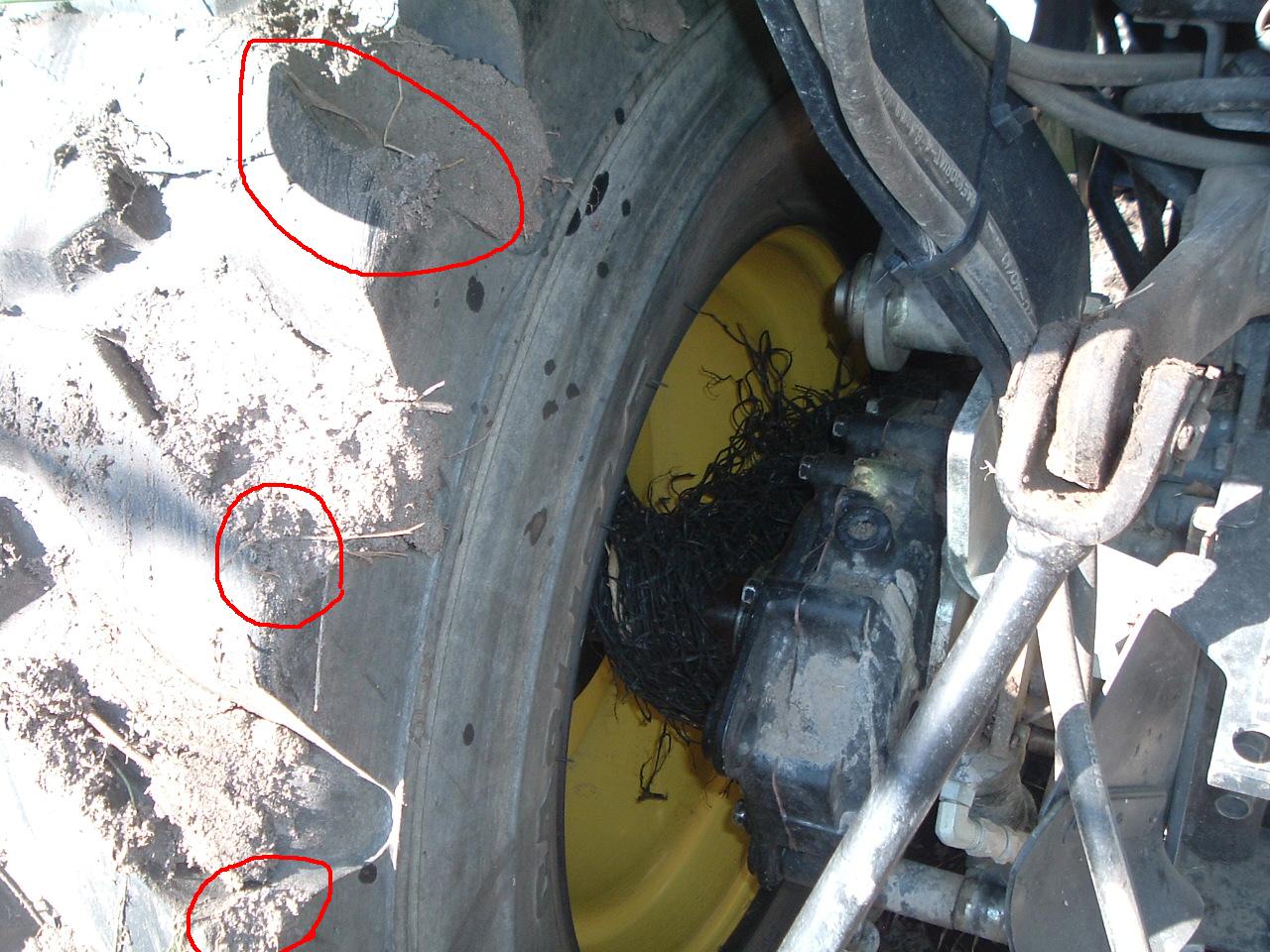

Holy.... Talk about meeting the judges, juries, and executioners all in one thread.... Without seeing it firsthand who the heck knows what happened..
Being both a pilot and mechanical engineer, It is hard to point a finger when you are simply looking at pictures.....
All true...but this is an internet forum, after all...
/ JD 2520 Snapped Axle #62
I'm not a metallurgist (my field is Quality Assurance/Engineering), but I think you're simplifying things a bit too much for that blanket statement. Fatigue strength depends on the alloy and, more importantly, the design.
If there had been a trend in failures of this design and material, you'd have a point...but to the best of my knowledge, there hasn't been a lot of failures (more then likely, we would have read about it on TBN).
BTW, I think most ferrous castings on tractors are cast iron, not cast steel.
Most castings on tractors and other equipment are ductile iron. Not cast iron. Cast iron is far too weak for stressed components. If parts are under high loads, then the parts are forged.
You are correct. Fatigue strength depends on material. Steel has a much higher fatigue strength (general alloy) than aluminum (general alloy).... approximately 2 times.
Obviously something caused the failure. If the casting failed... the part either had a crack (defect) from the factory or operation loading exceeded design specs.

I'll repeat, split your brakes and set your cruise control and try and stop with one brake on damp soil. It will leave a skid mark just like that one. You don't even need to be going very fast to do it. Unless you creep around at idle in low gear all the time on a tractor, this is what happens when a tire locks up. Not abuse.

Although there has been a certain amount of judgement passed on the situation by those posting to this thread, I think it has been enlightening.
As an owner of a 2520, I have learned that there are really two 2520's (not counting the one from the 1960's). The 2520 that was made between 2006 and 2008 is different in a number of ways than the ones built from 2009 onward. This was a point of confusion for me when I was using forums such as this one to do research prior to buying mine. Reading postings from people complaining about the small alternator and the problems with lift arm to tire contact made me wonder if I was making the wrong choice of tractor, until I realized that Deere (Yanmar) had changed all that. I later discovered that they also have different engine models between those same years.
This owner's unfortunate experiences seem to make it clear why the lift arm design needed to be changed. If there is too much sway in the 3PH with either a heavy or heavily ground engaging implement attached, then the lift arm can be pulled into contact with the tire so as to stop it from turning. Because of the angles and torque involved, it puts too much stress on the final drive and damages it, eventually leading to failure.

I don't think I abuse my equipment,
Well,IMHO,you would have to ask yourself why I had 4 major failures in 160 hours. The poor thing isn't even broken in yet.
Do you think I have a "lemon" and should seek remediation with my local dealer?
You're either asking your 2520 to do tasks it isn't designed to do,or you're a pretty rough operator,and no I don't believe you have a lemon.You really should know the machines limitations. Ain't hatin',just sayin'.
If the 3PT arms have been rubbing that bad from the get go, shouldn't that problem have been addressed 160 hours ago.
Sorry if I sound harsh,but that's the way I see it.

One question, if the rears reduction gearboxes were replace twice before why didn't JD replace those 3pt arms under warranty after the first and/or second break? Known problem.
Being that it was in 4wd I see no evidence in the attached photos that he was spinning the tires. But if he did spin and it grabbed something it might break but I doubt very much that this was the case with an open axle setup. Or are we assuming he had it in 4wd and the rear diff lock engaged.
IMO, he would have had to be in reverse in order for the 3pt arm to have broken the axle. Based on tread design, going forward the tread would rub and in reverse the tire could try to climb the arm if it grabbed it right. Going up the 3pt arm something will give, tire, arm or axle.
Also IMO when in 4wd the front drive shaft is the weakest link rather than the reduction gear boxes.
