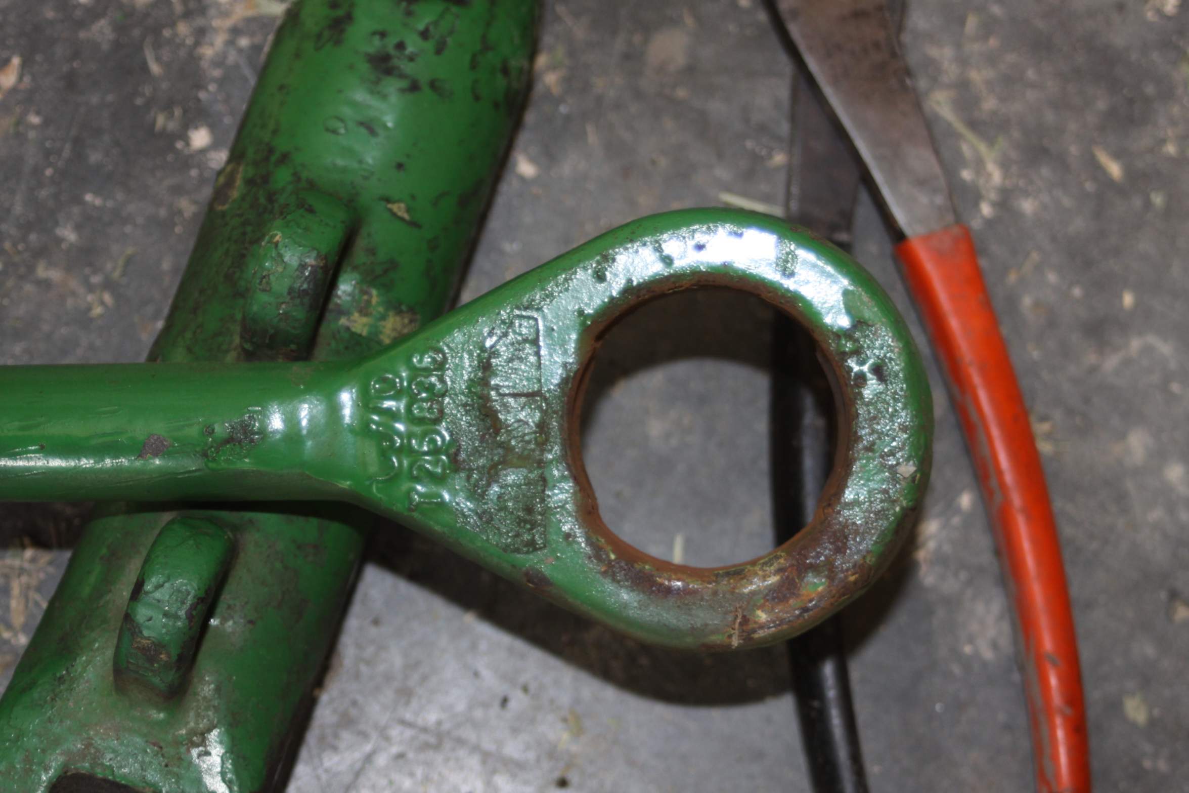

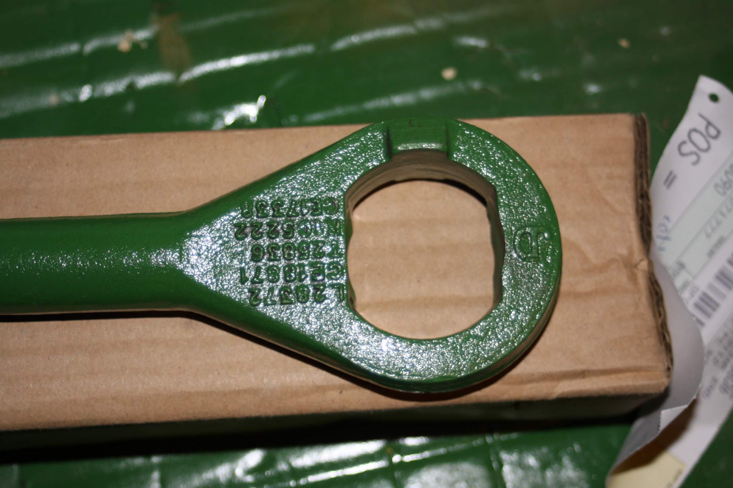

It's just a matter of assembling all the pieces now. The old lift link has a lot of wear in it which is why I decided to replace it. For example, the upper ball in the old lift link has around 1/8" of verticle movement in it. The new one I picked up this morning has around 1/32". That's just the ball. Every other portion of the link is just as worn. The threads for adjusting it have enough wear that the shaft and lower body have noticable wobble between them. The new ones are tight. I should loose 1/4" to 1/2" of verticle play in the lift link after it is replaced.

I guess I forgot to update this thread. Been busy getting ready for the picnic I'm hosting next month. I got the lift links replaced and that is probably all I'll get to before winter. Things seem to be working well, but I will still need to play with the adjustments later. Depth control works great, but load (draft) control is out of whack. Just the vibration of the tractor starts lifting the 3PH. Well I don't really need load control right now and that will give me something to play with this winter.
