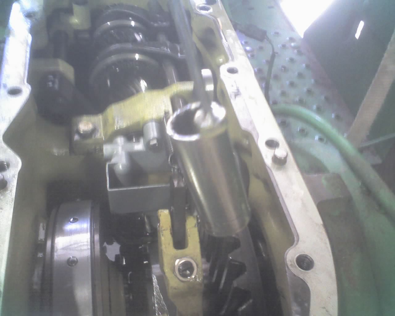

Time will tell. I hope I can salvage the gasket, or it will be around a week to get a new one. I'll know more tomorrow. I have to run to a friends place in the morning to borrow his engine hoist again. Then remove the seat and 3PH cover, then I get to start looking for the socket. I just hope I don't end up having to drain the 15 gallons of hydraulic oil
The adjustment I was doing requires sticking the socket through the oil fill hole to loosen a locknut and then adjust a screw. I had made the adjustment and retightened the locknut. As I was removing the socket, which was on the end of a 12" extension, I bumped the side of the fill hole knocking the socket off the extension.
In the lower half of this picture on the right side is a large gear. Just to the left of the gear is a yellow forked piece. The screw and locknut are visable at the base of the fork.
The socket should have dropped into the oil between the forked piece and the housing and left of the gear as the picture sits. Finding it is going to be interesting. I tried using a magnet on an extedable shaft, but there is just too much in the way with the cover on. Hopefully it will work better after I remove the cover, but I'm not holding my breath.

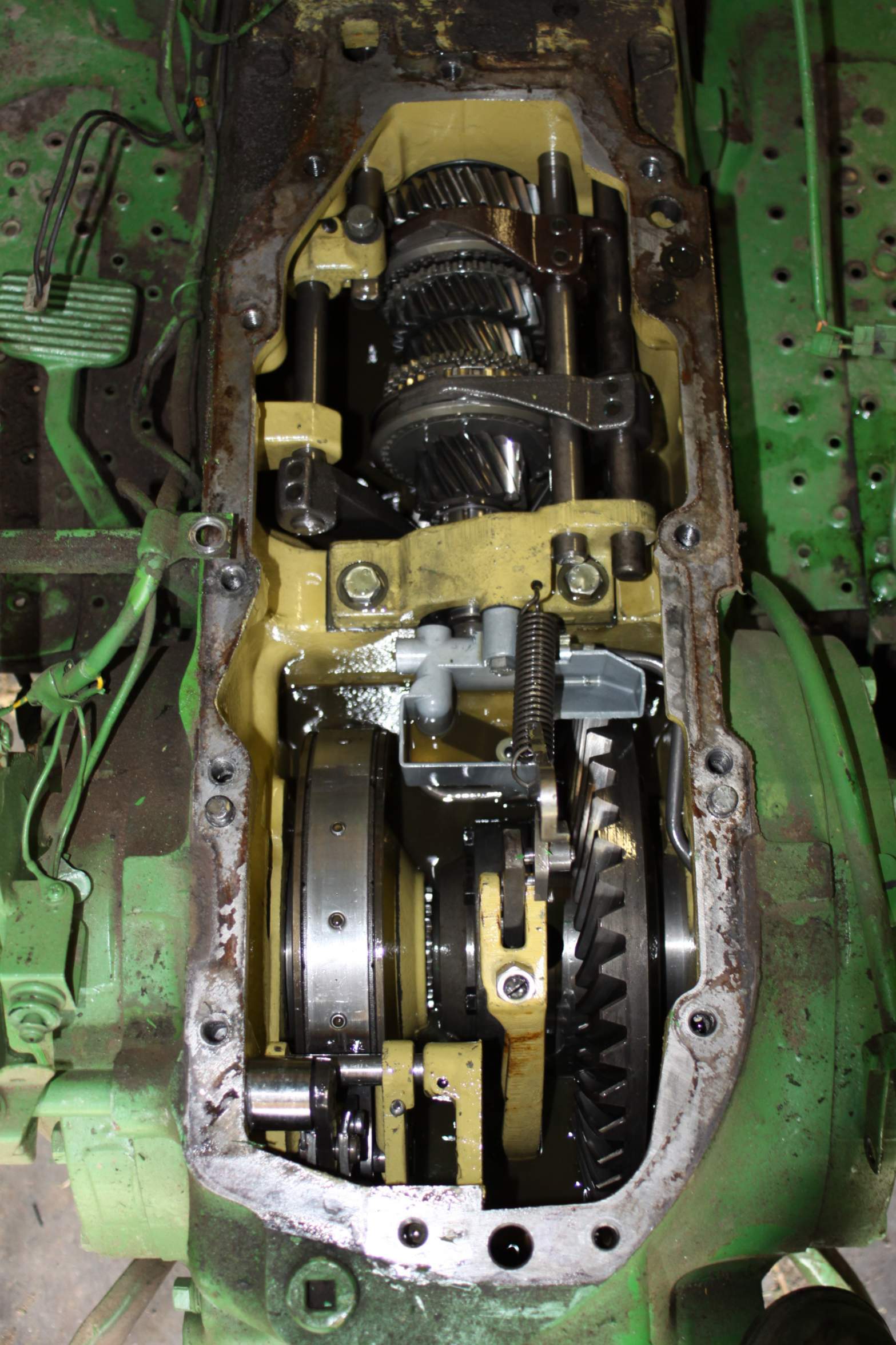

Well, I got lucky. After removing the 3PH housing and fishing around for about 3 minutes with the magnet, I hooked the socket. I think the gasket will end up being OK, but time will tell. Here's a picture of the socket hanging from the magnet as it was being pulled out.
