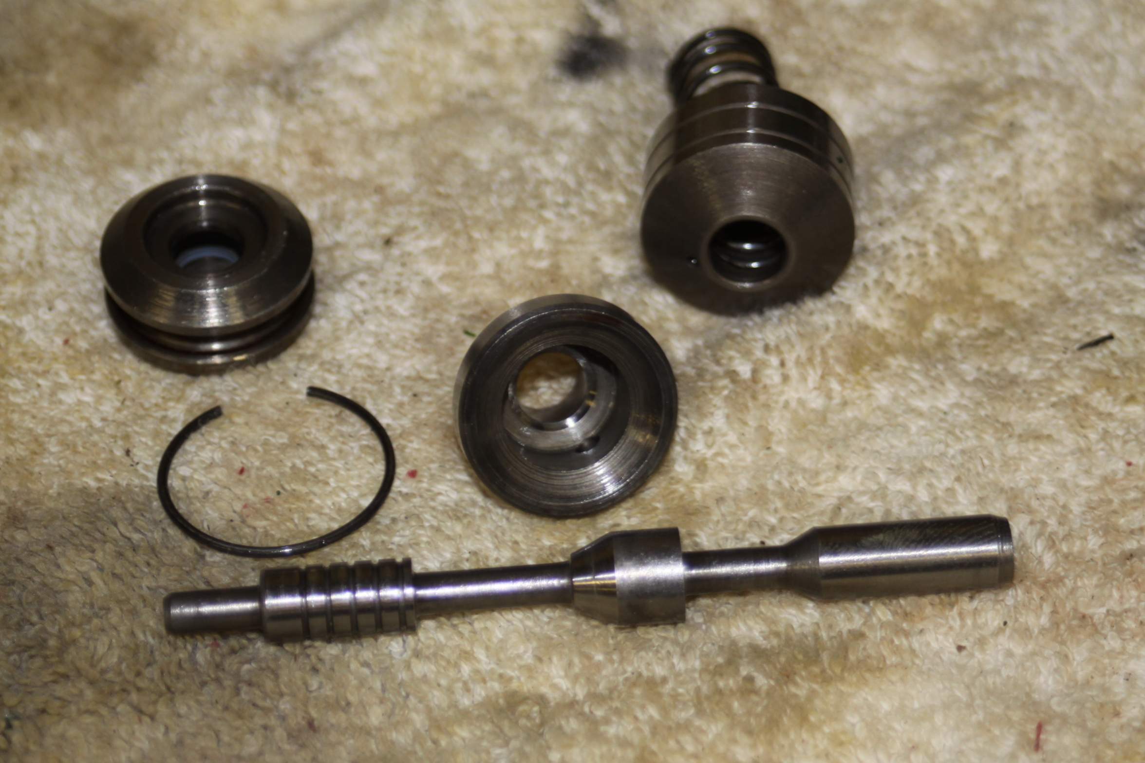

And here I thought that was a broken O-ring. Those type of rings appear to be a PITA since there is nothing to grab onto.
They pop out pretty easy with the pick...as long as I remember to push in the face to give them room to come out.:laughing:
If you look back at that picture again, you will see the notch on the outer edge of the endface which locks the snap ring in so it cannot come out without the endface being depressed.

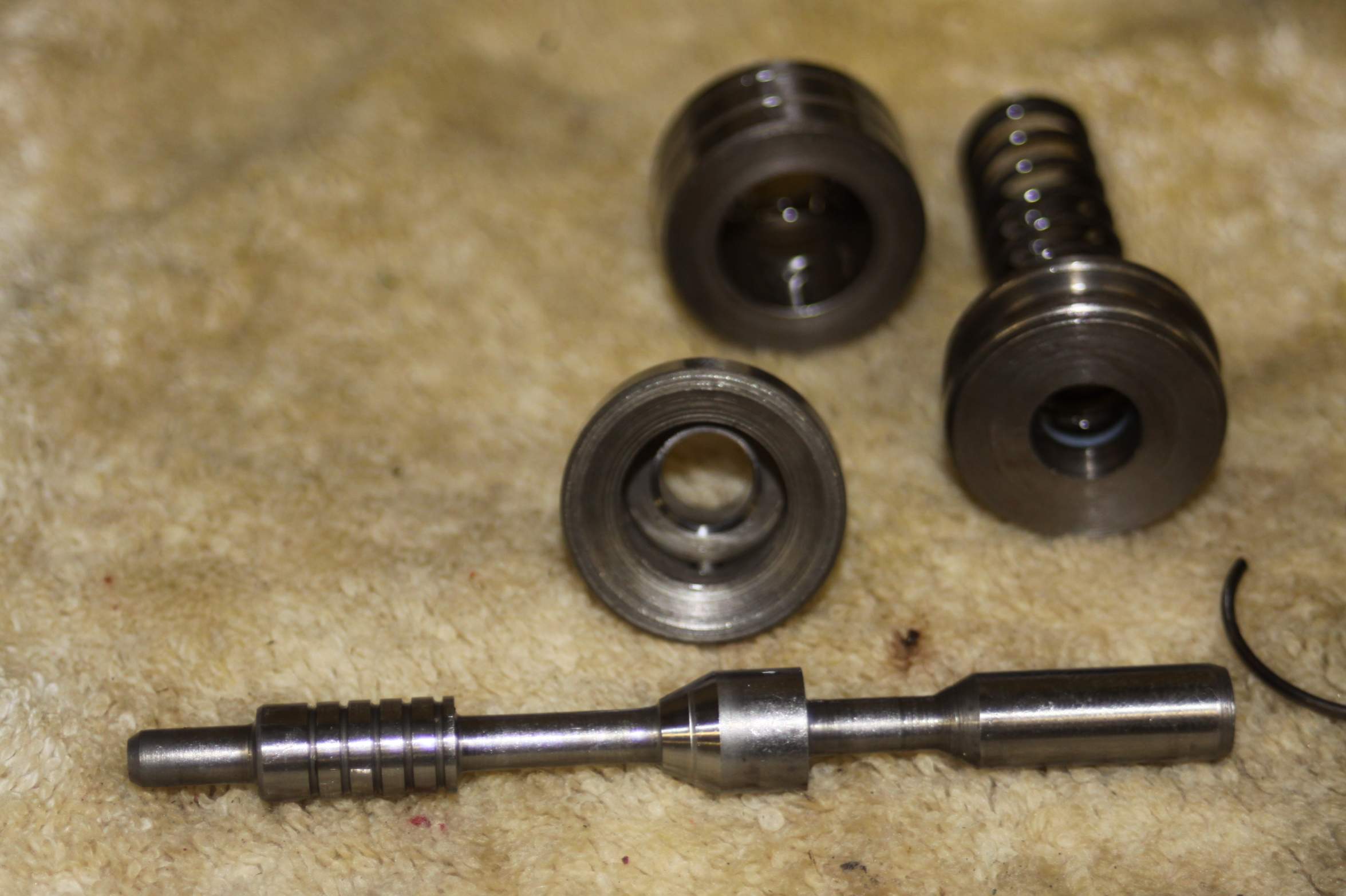

Picked up the new valves tonight after work. What a difference.
Old on the left. New on the right.

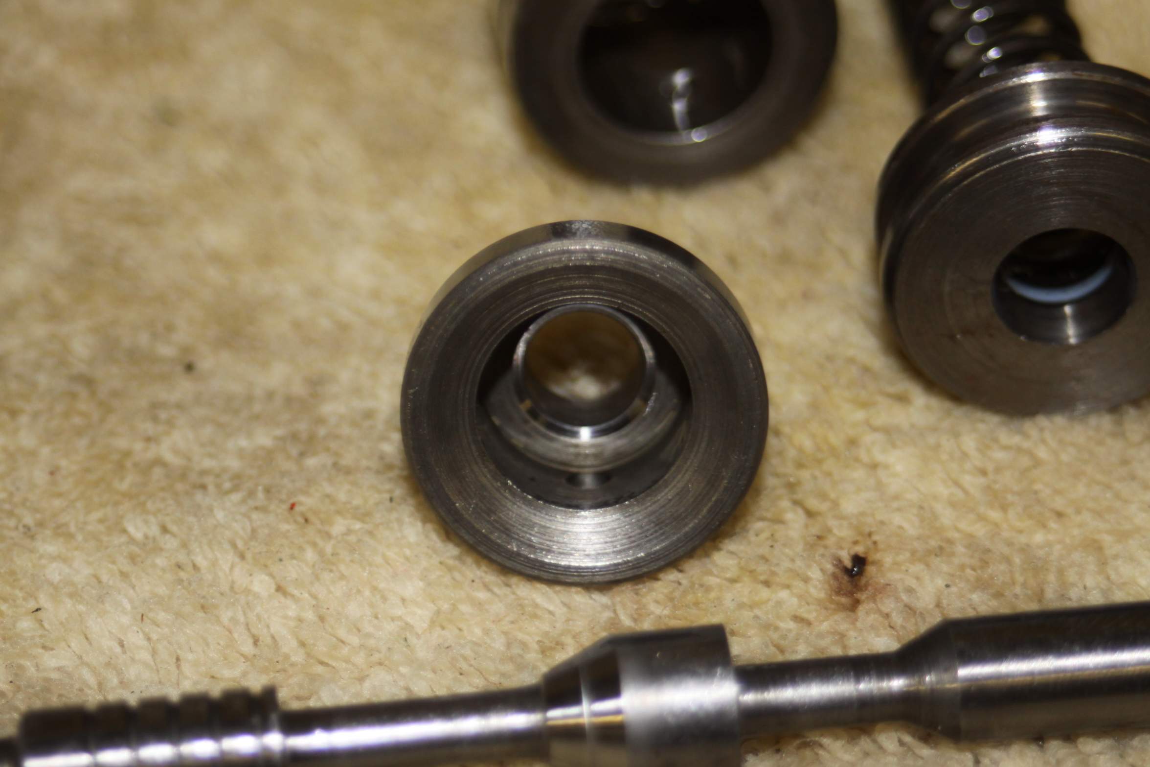

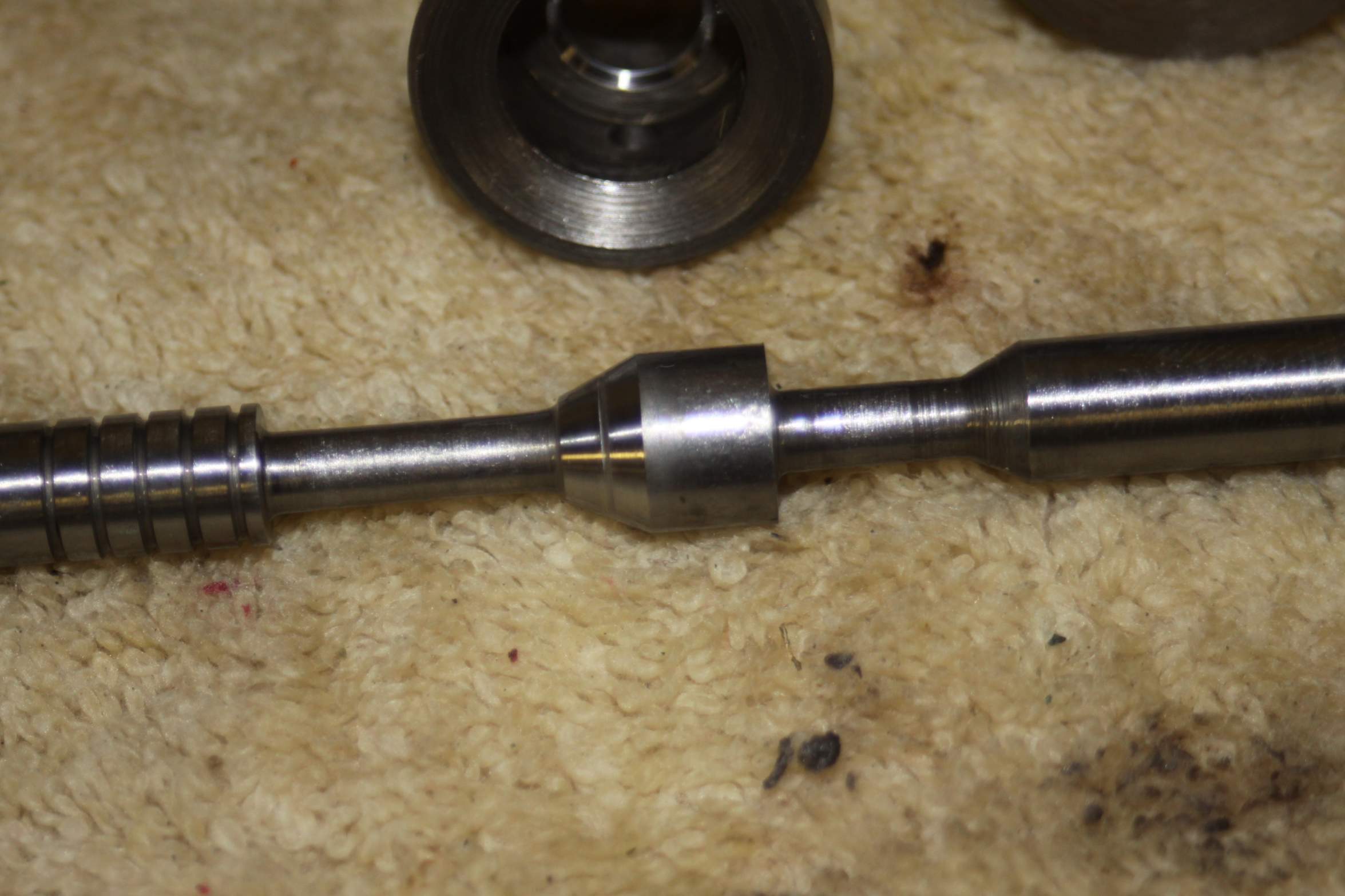

That is a heck of a groove on the conical portion. Bet that caused some leakage.
   / JD 2240: Rebuilding my 3PH
#27

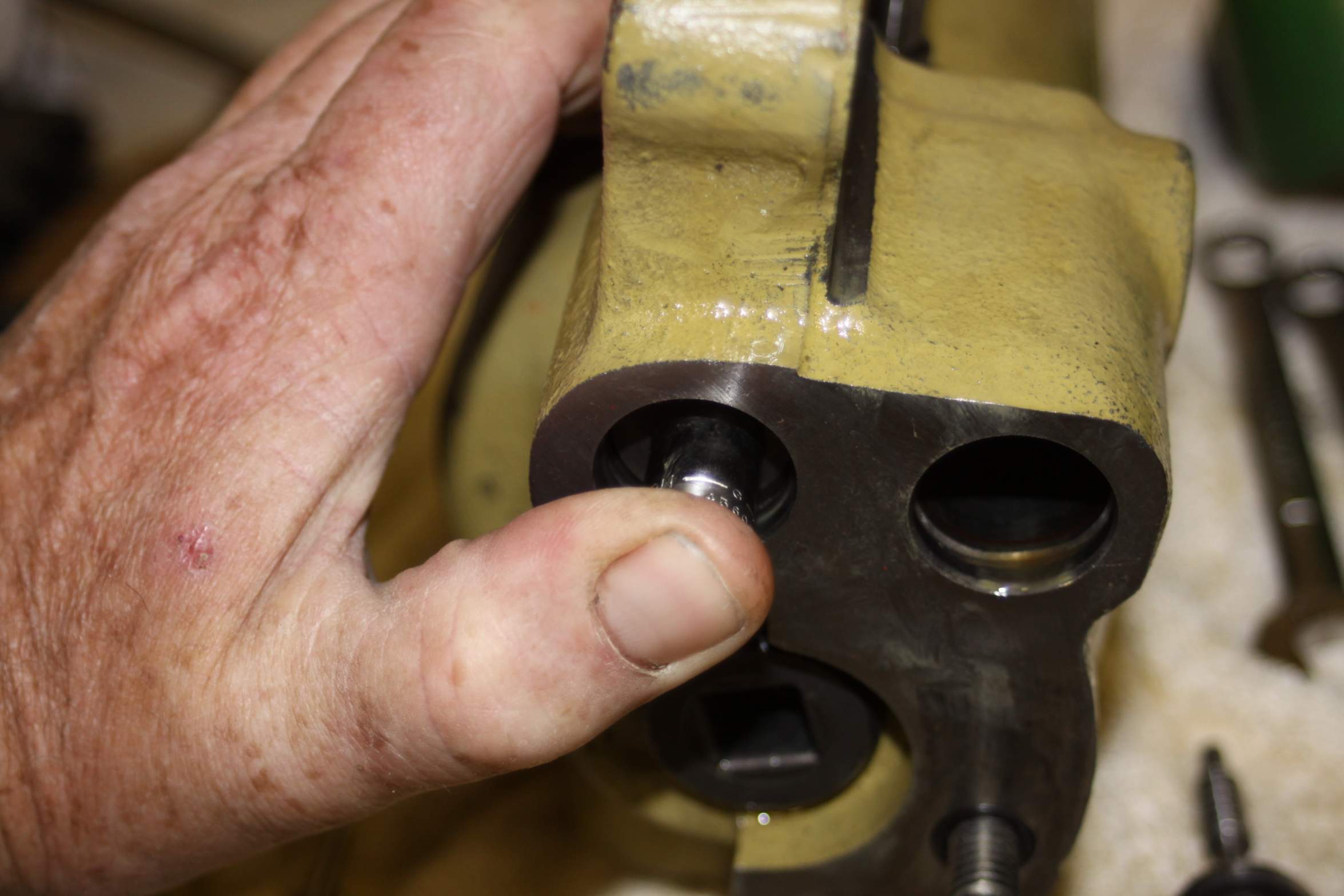

The strange part is that that was the pressure valve and the relief valve wasn't nearly as bad. Even so, my issues were with trying to lower the 3PH. It raised great.:confused2:
I think it just clicked in my mind. The leakage could have been part of my problem in conjunction with the missing O-rings.
